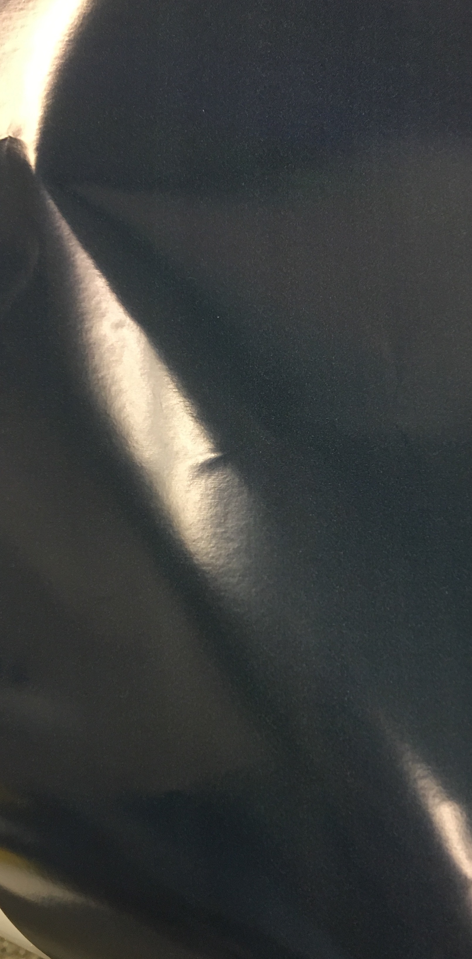

im so at my wits end! Last time I had the techs out 5x they replaced all the dampers and said it was the print head ( which I did not replace)
Someone here said static so I got bands and humidifiers and it was fixed with the exception of being able to use the take up reel ( which is a major pain)
It's happening again and same customer job! I have done cleaning, slowed down speed, changed media profiles, calibrated the feed and bi directional, changed hear settings etc!!
The techs are not even calling me back- everyone is busy I know. Any help would be so very appreciated !

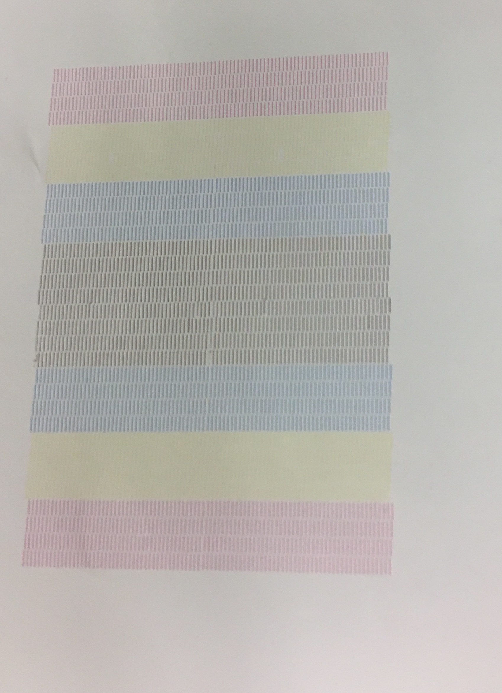

If you could post a picture of the banding and the nozzle test print, it would go a long way to getting some help. Banding can be caused by a lot of things, just saying "banding" won't really help you get to the root of the problem.
lexsigns
Thanks Joe
I did a lot of cleaning and I got to work with a different Media if I use unidirectional so must be a calibration setting I hope. Even with that I can't use the take up reel or it makes big white streaks in the prints! Still waiting for a tech to get in touch. I have wasted so much time and material it's insane!

I would adjust your Bi-Di simple setting to -2, then perform the detailed Bi-Di calibration. Also, it looks like your feed calibration is a little off, just from looking at your nozzle test print. Finally, the deflected nozzles in Black will wreak havoc on trying to print a smooth gray. After doing a good manual cleaning, using a flashlight to make sure that you're getting everything very clean, try a powerful cleaning and then see if you get any improvement in the nozzle test. If not, I'd suspect the captop and wiper and felt if they haven't been replaced in the last 6 months.

First off the head design on that printer is a horrible, it's part of the reason Roland went back to per head per color setup. The head could need replaced even firing all nozzles. Your feed calibration looks off you need to tighten it up unless that gap in your nozzle check is from a head crash. Lower the middle print platen heat temp when printing try 0 degrees and go from there, raise the dryer temp if need be. For good measure always do a feed calibration when switching material and or using the take-up.
