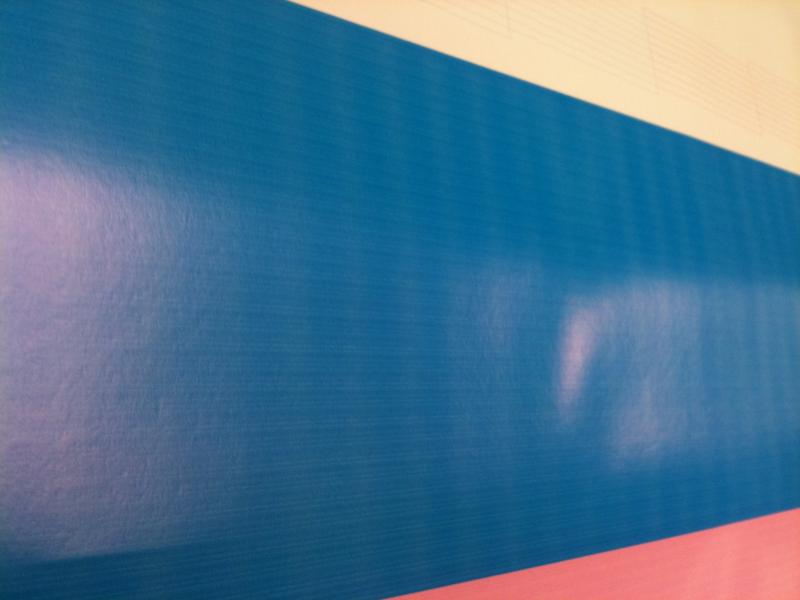

I don't know if anyone else has this problem on their machine but we've had the issue for some time now. I get vertical banding that looks like WAVES in my CYAN areas. Now I printed swatches and have come to the conclusion its only in my CYAN and not the LIGHT CYAN. We've had many techs come out and look into this issue, none of which have figured anything out. I was hoping someone here could help and maybe they've been through the same issue. Below is a picture off my cellphone. I have recently had other issues with the printer so don't mind the horizontal banding, my heads aren't fully back yet from being clogged but this has nothing to do with these WAVES i'm getting since they have been there for months before my heads got all messed up.

is the media tunneling when printing? Ive seen vertical banding caused by this, or uneven platen heat...can you run an IR thermometer across and see wide variances of heat?
tandem signs
The media seems to be fine, laying flat with no ripples. I guess I could try the thermometer thing but it ONLY happens on CYAN. I can print the other colors in the same area of the printer and they are perfect. Makes no sense to me.
