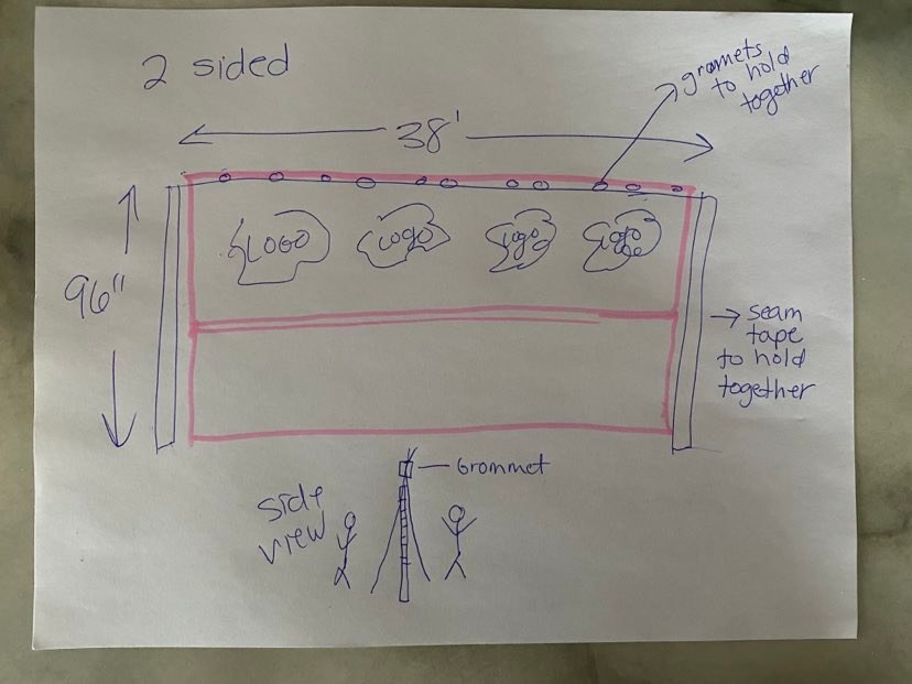

So, I need to make a sponsor banner to cover the volleyball court net. Size would be 96" tall x 38' wide, 2 sided. I'm attaching a photo of what I'm thinking. The sponsors might change yearly so we were going to print on the first year then put decals over them following years if sponsors change.
It's being used for one weekend a year. I'm thinking 13oz banner material. My material is 52" wide. Cut 2 lengths of 38' (trim bottom one) and to attach will regular seam tape work? Then on the top I'm thinking I could put the top two together and attach with grommets near the top. Then they can drape this over the net. It's "blind" volleyball so using a mesh for weight isn't going to work since you can see through it. Should I use 10z instead? I don't have any so would need to order some.
What are your thoughts on this? Any better ideas or will this work?

Maybe worth while to look into a billboard face manufacturer like Kramer graphics. Only problem is the quality is far below anything you produce, but at .75 cents a square foot (that was pre covid I think) and to do it in one piece, it would probably be worth it to just get an image like a schools mascot printed, along with frames for the sponsors to go into, then you could add velcro tape and swap out banners yearly.
It would be my luck that a horizontal seam like this would get hung up/stepped on and drop the whole bottom half about 3 minutes into the game.

if you are doing it in-house, make 4 pieces (2 per side)
* top of the net to the bottom of the net
* bottom of the net to the ground
If outsourcing, 3 pieces
1 piece large enough to TACO the net, print (light grey) a center line for easy alignment on the net when it is draped over
2 pieces from the bottom of the net to the ground
you have to consider storage, being rolled vs folding
Who is installing / removing / handling, a solid piece 8' x 38' will be heavy and cumbersome

I'd use HH66 in place of banner tape or stitching (looks much cleaner). For the top I'd do a 2 or 3-inch overlap of the two sides and seam it again with the HH66. It would sit down over the top of the net like a saddle. We do 13oz monument wraps that are 10' x 16' with 3 horizontal seams. Zero failures in all the years we have been doing them. You can fold along the seams and then roll them onto a core for storage without them opening up.

I feel like this is going to be really heavy for the net.
with it being 96" h, use corplast,
lighter than a banner, and with it being 96"h it "should" touch the ground to take more weight off of the net.
have grommets every 24" on 3 sides so the panels can be zip tied together and to the top of the net

Just wanted to update everyone on this. I used 13oz banner material. I created a 7" flap on top and every 3' put 2 grommets 2" apart on each side. After that was done I applied vinyl decals to it. They installed it and used it this past Saturday and it worked great! They find it a bit heavy so they used a nylon rope across the entire thing to pull some of the weight off the volleyball net. He used single bed sheets on the bottom which he said next year he would use a tarp attached to the backside of the banner so it looked a little nicer.
