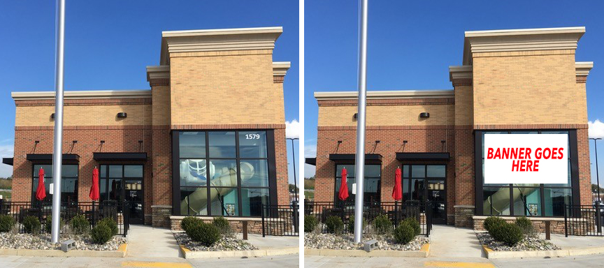

Hello all!
Need some ideas here.
Looking to install a banner for a diner that is opening and they want it to fit in the top two rows of windows (see pic reference) How could I hang the banner there without drilling into the existing brick or window frames? This is just to say OPENING SOON! So it will be up for a few months only.
Any idea how to hang this?

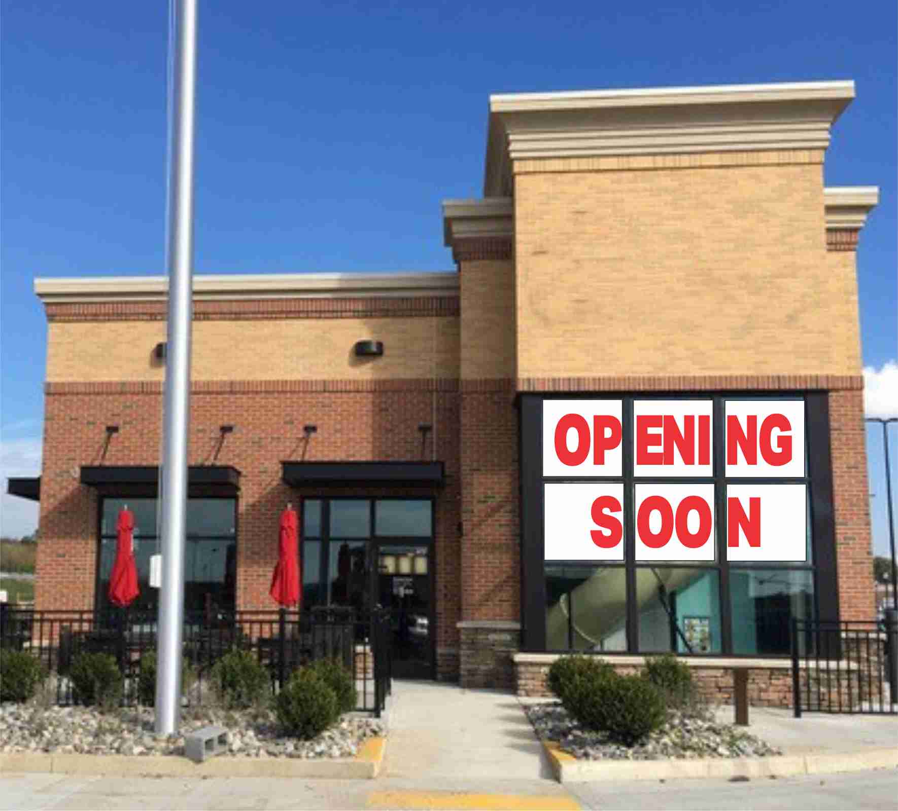

You can use the tape idea, but it will require cleanup afterwards. I would prefer doing a 6 panel vinyl print and see if you can make the design work with the mullions

OK, so the customer is choosing to do the windows with removable vinyl as Billct2 recommended (Thank you for the pic).
