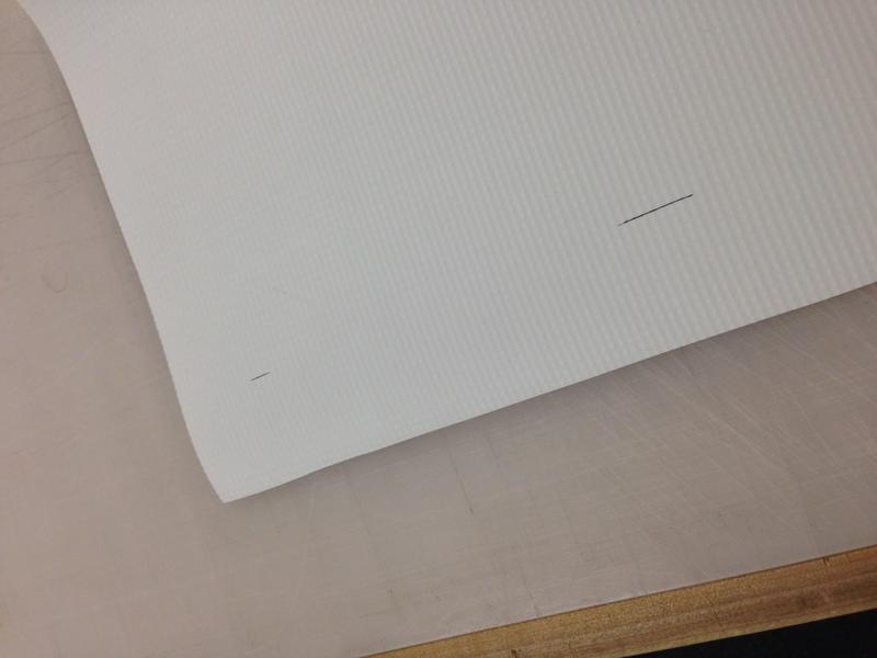

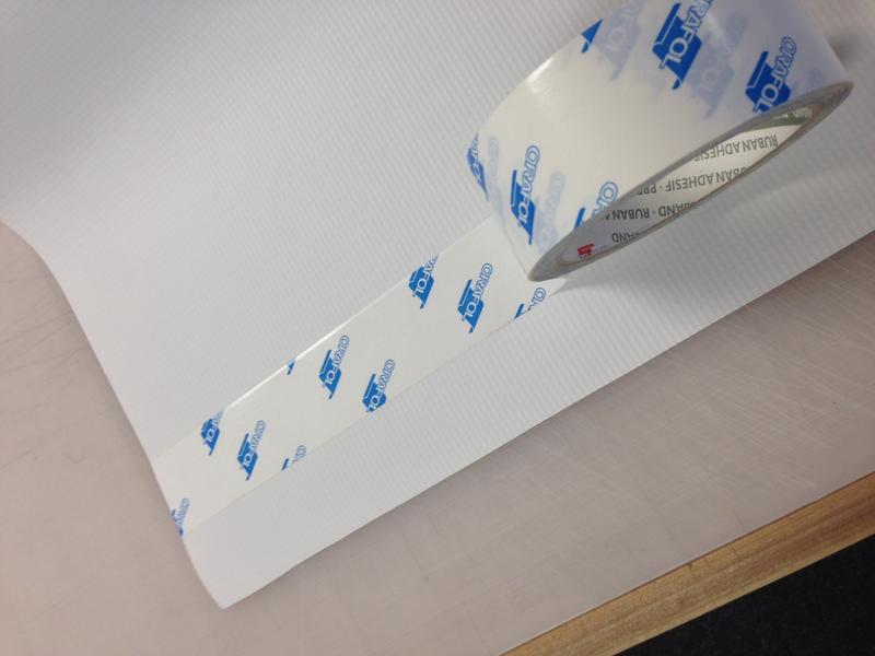

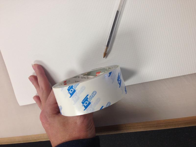

x2chris7x
You can save yourself some time with the tape measure and just use the roll of hem tape to mark the back of the banner... Just a Little trick we do
