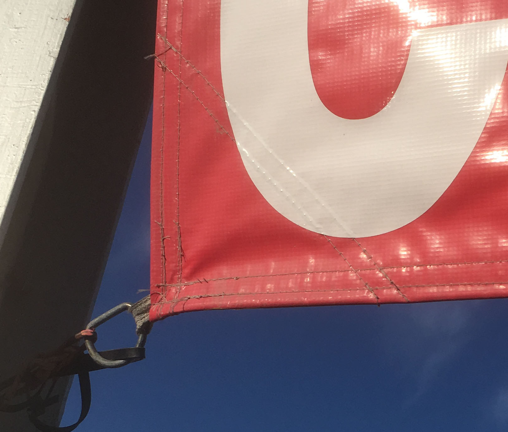

Have a client that wants a banner like this. They want the same thing because it lasted a long time.
Anyone know what this is and how it's done.
Thanks

Just give an extra guarantee to the gromet. If they insist give a ridiculous price and take it to a sewing shop (i don't know the name, they are in every mall repairing cloths) they have both the strap and d-ring too. Only thing you need to make sure they are welded d-rings or you can also use flat keyring

This is a requirement around here for street banners. Double stitched hem with webbing, re-enforced corners & D rings. You have to either find a supplier who can do them or have a local industrial sewing shop (some who does boat tops or the like) to do them.

for us we found saddle makers or upholstery shops can also do this type of sewing if you do not have the machine yourself
and FYI that sewing machine you have at home WILL NOT work

We use Sewing Specialties in St. Louis to "build" banners with webbing sewn into the Hem with D-rings. They specialize in banner sewing and are great. They can also sew perforated banner material....great resource....You can either ship them your banner to be sewn and they usually ship it back the next day....or you can order pre-sewn blanks.

Sewing is the only way to go. I'm surprised more sign shops don't do it in house (if they have the space). Sewing isn't hard -- it just requires patience (sometimes a lot of patience). I built a custom 20' x 5' "air hockey-style" float table (like Fellers used to have). Makes sewing jobs so much easier. A good used sewing machine can be had for about $1.5-3k. The old Singers and Mitsubishis are rock solid, or most any name brand machine that's 40+ years old (back when machines were built to last -- with metal parts, not plastic). So you don't need a huge investment. Keep it oiled and it will last forever. High quality threads and webbing cost next to nothing if you know where to look. Pennies per banner. Finish quality / durability is amazing.
That's a D-ring. We've had trouble getting them, so we went to O-rings. We loop a piece of nylon webbing through the ring, fold the hem over it, and then sew it into the hem (usually making an additional "X" for added strength). We used to sew webbing in all the hems for street banners, but we found it was hard for the client to store them and wasn't really necessary anyway. We recommend O-rings if the banner will be hung between posts with bungee cords. The cords keep the banner taut to prevent sagging. And unlike grommets, it's almost impossible to pull out. We get O-rings and webbing from Fellers (it's not in their catalogs), but there are other sources. We use a Consew 225 sewing machine--they are damn near bullet-proof (single stitch).
