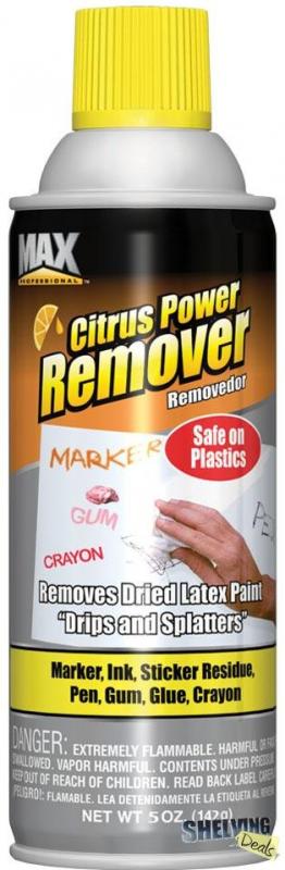

This stuff works on every type of adhesive we have encountered.
This and plastic razor blades.

THIS.
It's nearly the only thing that we have used in our shop for adhesive removing for at least 12 years. Only once did I ever encounter something that needed something stronger.
It's manufacturer Max Professional has also come out with a stronger "industrial" version that I have yet to test.

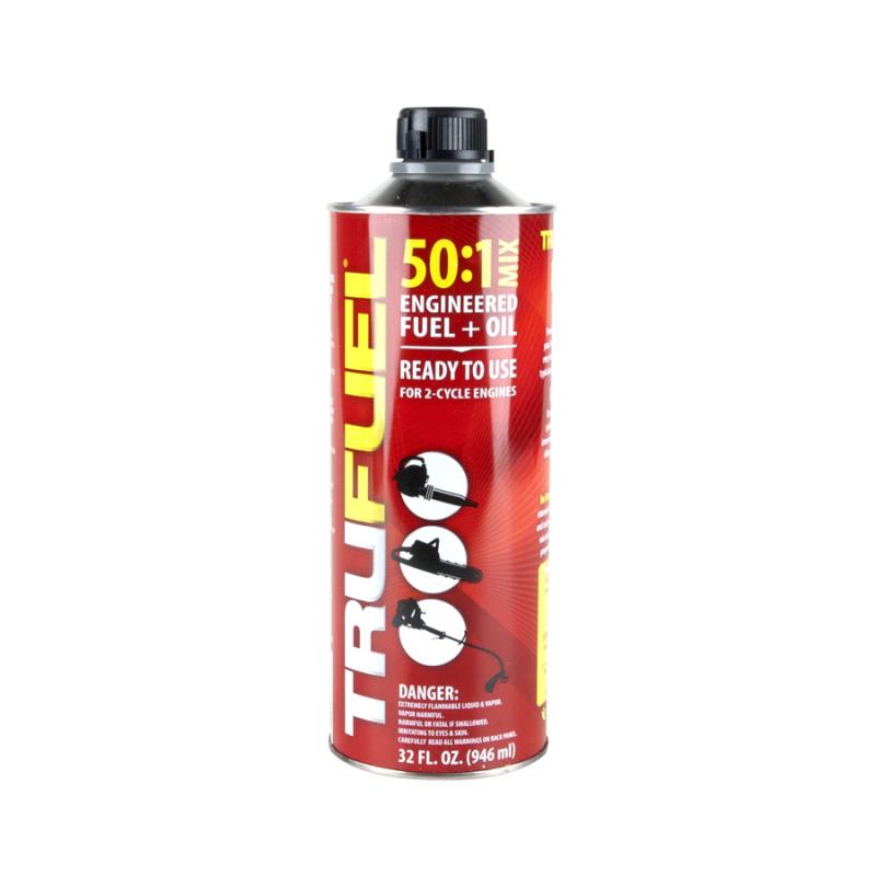

Kind of hate to admit this but...
I love Rapid Remover and it's my go to stripper but when you drop the bottle off a ladder and it splatters all over the parking lot and you have to finish the job that day you look for options. Tried the 3M stuff from O'Reilly....junk. Citrus stripper from the paint store...useless. Goo gone....waste of time and money. I just happened to have a can of pre-mixed weedeater fuel in the back of the truck and tried that. Worked almost as well as the Rapid Remover and doesn't smell like gas. Had to clean off the oily residue with alcohol but in a pinch it saved my butt.
