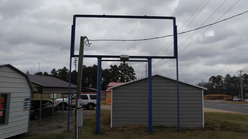

I just got deposit on a job today, it's a non-lit sign that's in a 8'x16' metal frame about 20' high. I plan on using cut vinyl and some digital print.

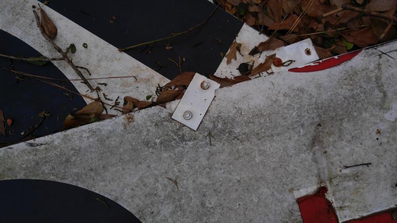

The previous panels were (4) 4'x8' MDO all lined up together, with small 2" or 3" metal brackets that connected the boards together in the middle. (See attached pictures). The previous wood panels rotted out and eventually fell during a good wind.
My question is what do you thing would be a strong panel to use? Should I use wood as they did or something metal? Do you think the metal "tabs" were a good idea? If not what would you suggest?

since the frame is already made then we would use strips of alum 080 maybe 063 and then use pop rivets to secure the strips to the sign.
if we were building from the initial layout then we would have vertical & horizontal supports and then use dibond on each side so the frame is hidden.

Double sided? How are the panels fastened at the edge?
Yes, double sided. Not sure how they did fasten them before.. but last one I did like this I screwed the panels into the metal frame, then closed the frame and it kind of sandwhiched the boards in as well.
Billct2
Is there a flange to fasten to? I can't tell how it works from the photo.
In any case I'd use 6mm ACM or 1/4" Alumalite with some type of batten

I think I would use the alumacore panels with tabs riveted to the panels. It doesn't seem like much but 20' in the air your going to get some wind up there.
