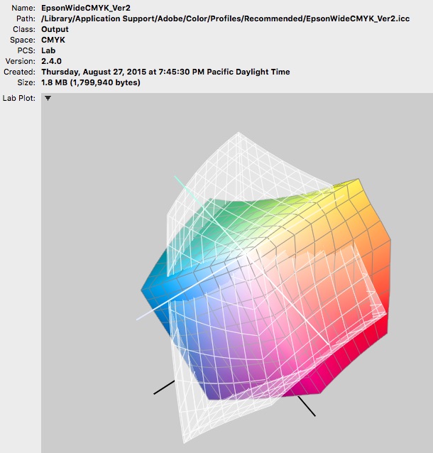

The above statement is not accurate and misleading. A designer can use the appropriate CMYK profile as the design working space and achieve ALL the color range of the printer. In this case of a new printer and install, it's likely safe to say the "Wide" version offered by the mfr will provide a very good starting point. It should be far more preferable as opposed to Adobe RGB, especially in this case of yellow and maybe pink.
Although the Adobe RGB (1998) is a rather wide gamut, it is a display profile with a very different shape than the printer. The US Web Coated SWOP CMYK is an output profile and represents a machine rather different than the OP's. The "Wide Mimaki CMYK" is an output profile and should, in theory, actually represent the OP's setup as a start, therefore providing more trustworthy results.
See the attached image. The wireframe is the Adobe RGB (1998) space, the color is EpsonWideCMYK in this case. (I do not yet have the wide Mimaki profile for comparison.) The Epson space shows more color potential in yellows and some others.
