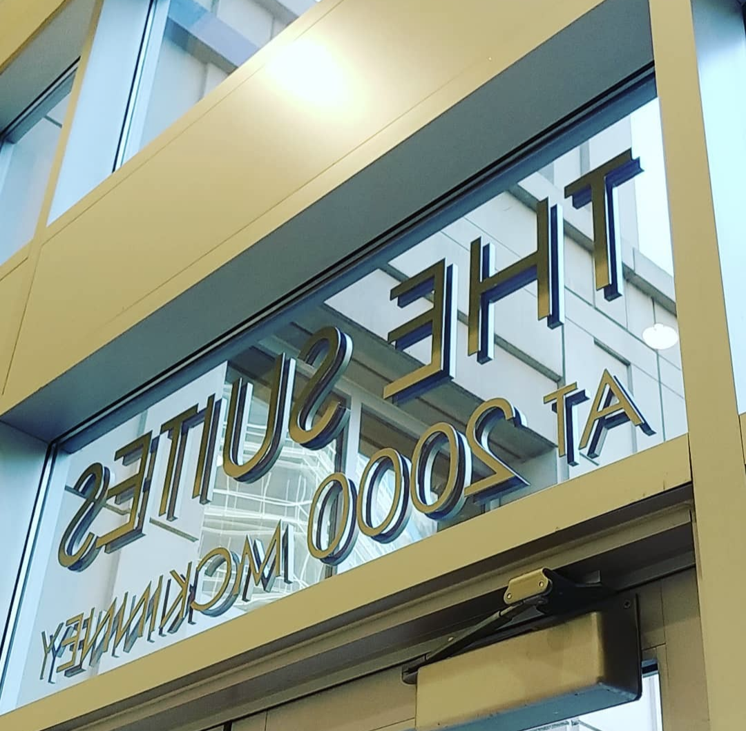

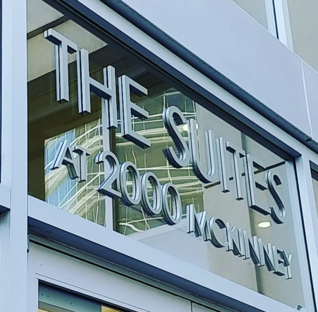

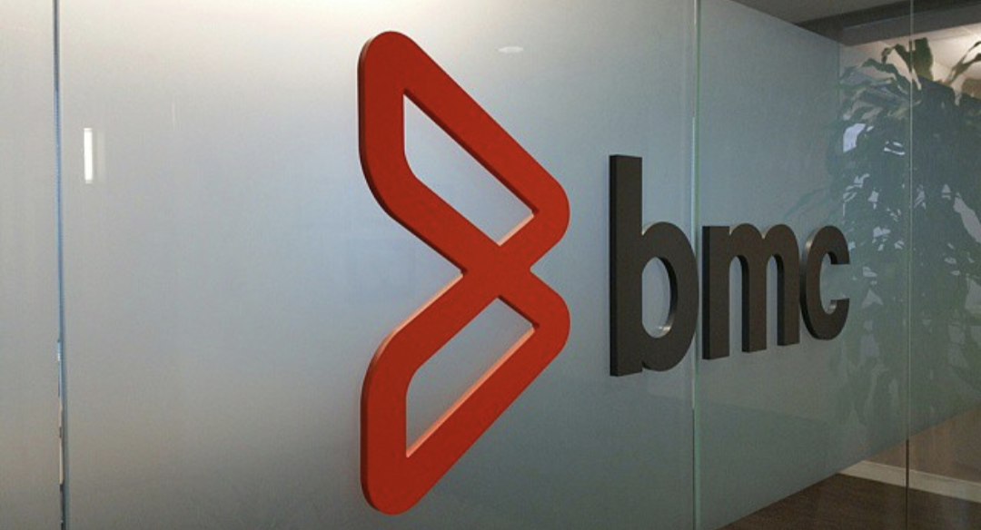

A couple of examples...
This had 2nd surface privacy vinyl so the tape etc would have still been visible. So vinyl was installed first then the letters on the vinyl.
These aluminum letters were tape mounted then reversed letters were installed on the inside to help cover up the backs.
