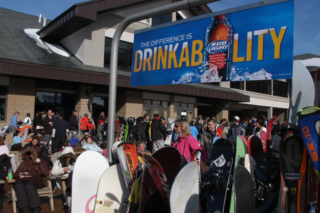

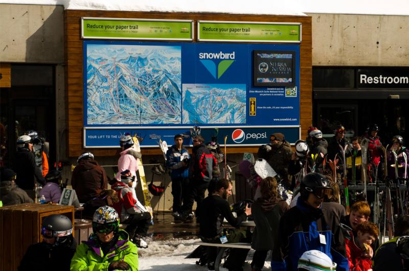

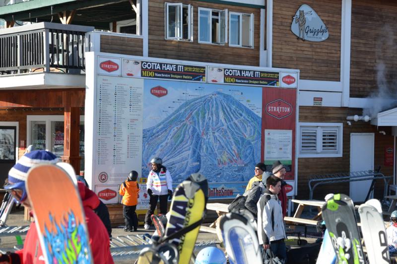

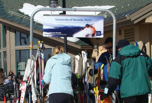

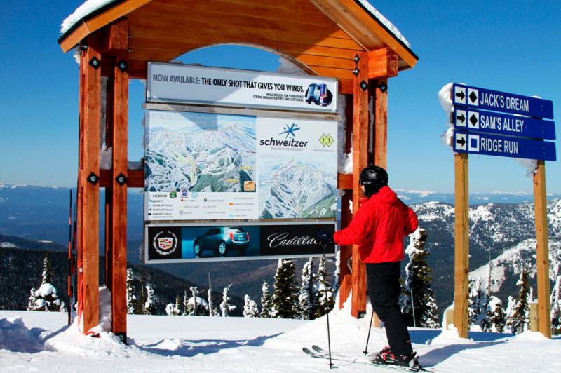

We do trail maps and ads for an Outdoor advertising Company that supplies maps and ads to over 250 resorts in the US and Europe.
all are direct print to substrates
Large trail maps are .080 aluminum
Small trail maps are 6mm Trevesol (super durable PVC)
Ads are all .040 styrene
Some pics attached.
