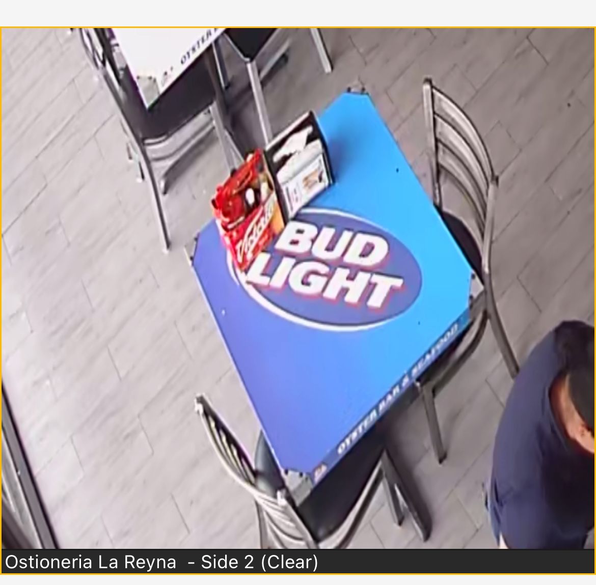

i have been searching a material that goes long term on a restaurant table. the surface is flat but i really need to use the correct material. Also i need a recommendation for the gloss lamination as well. I was thinking to use ij80 but it looks expensive or maybe too much. I really need your recommendation. i found a sample photos. as well.

that is a great point! Yes we will wrap the edges as well and use primer all the way!
these are 30in x 30in tables with 2inc sides and 2 inc to the bottom to secure the corners. i need to wrap 40 tables.
so which lamination do u recommend? I saw that they used floor lam before but it came out easily.

ij35 is just as good as cast wrap vinyl in this case, indoor&wrapped around, especially if you have the ability to remove those corner caps and reinstall on top of your finished wrap. any exposed vinyl edges will take a beating with table cleanings.
you could also save a buck, and ditch the 3M, and go with a house-brand intermediate calendared like Grimco's Briteline DurationX or NGlantz's BeLine.
...but if you're printing BudLight logos, I would highly recommend 5 layers of anti-graffiti overlam and a long chat with your local pastor
