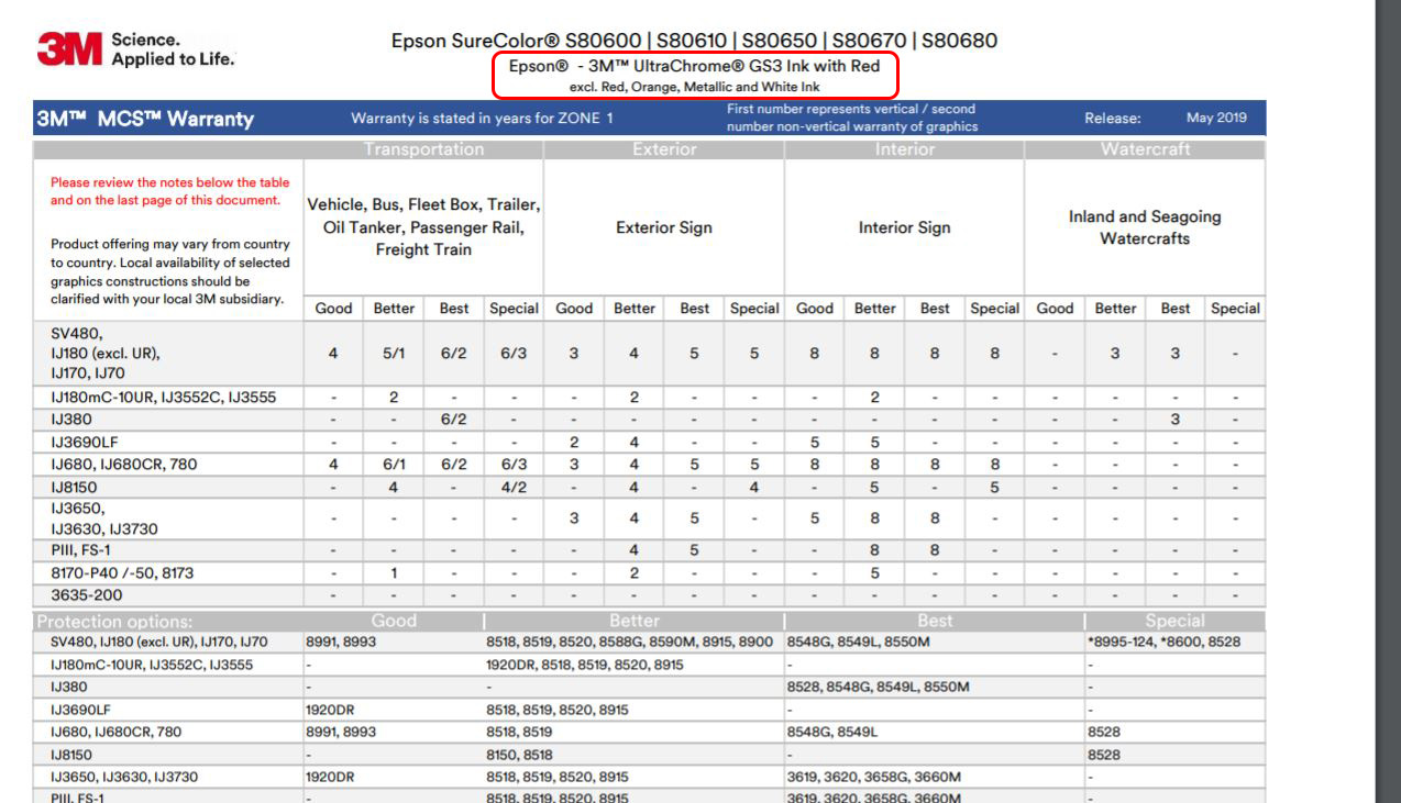

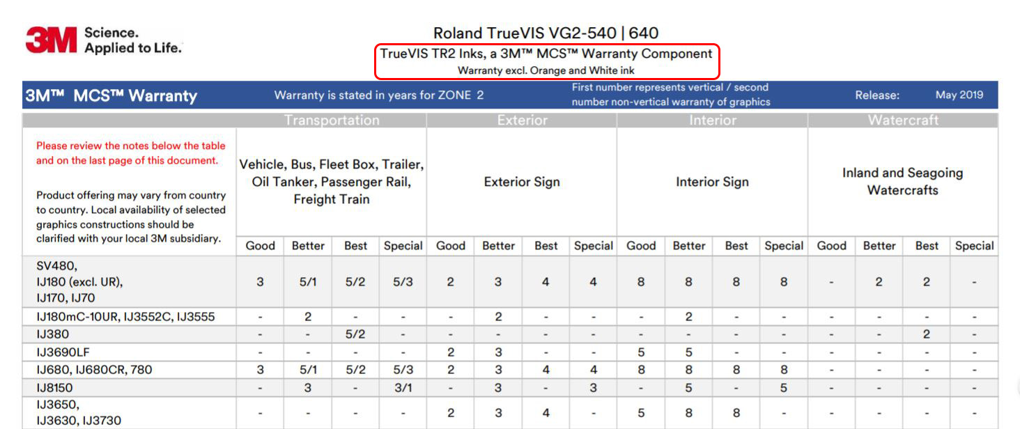

Another relevant question to ponder might be directed to 3M, as to why GS3 and TR2 Orange, Red, Metallic, and White inks are expressly non-warranted for any duration under the 3M MCS Warranty, while CMYKcmk inks are covered - see attachments

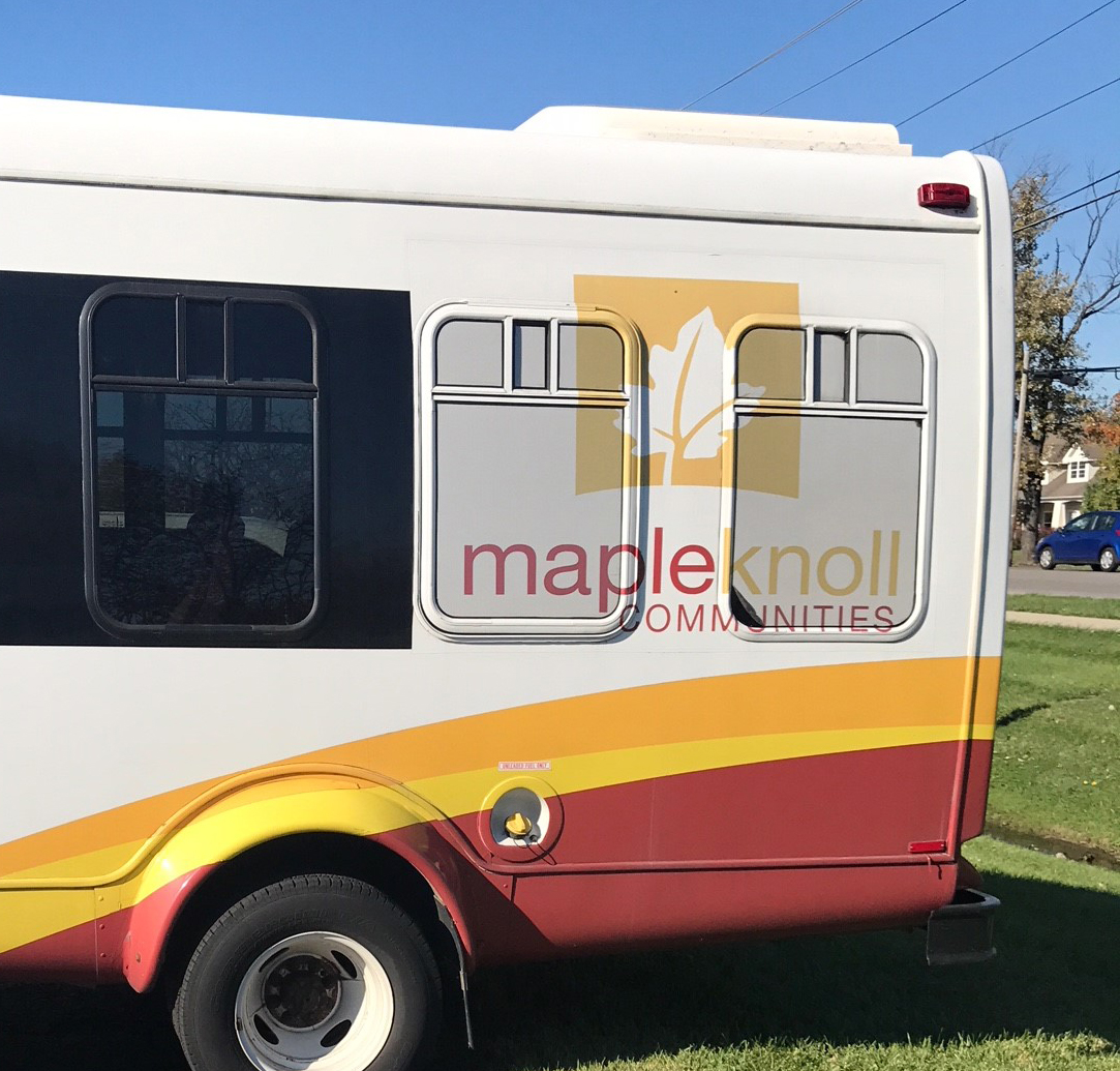

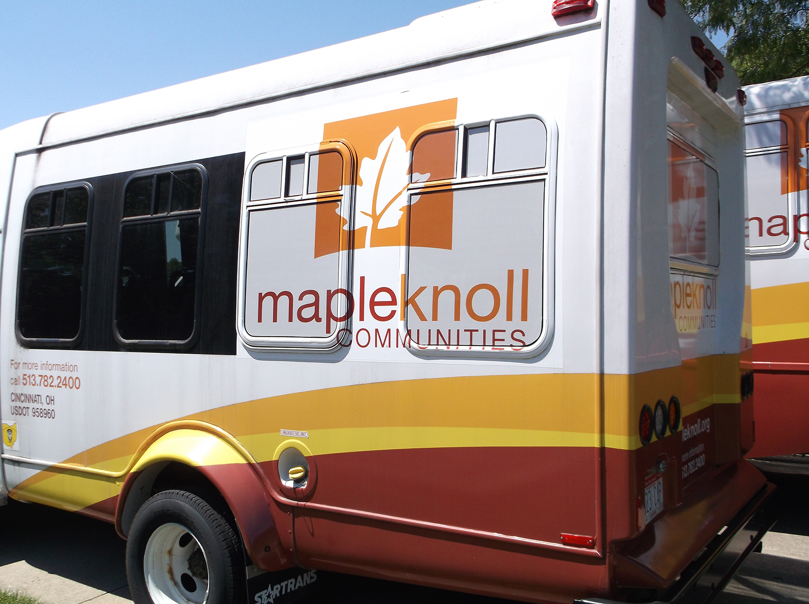

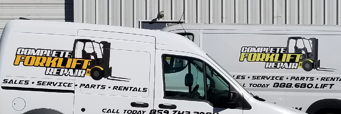

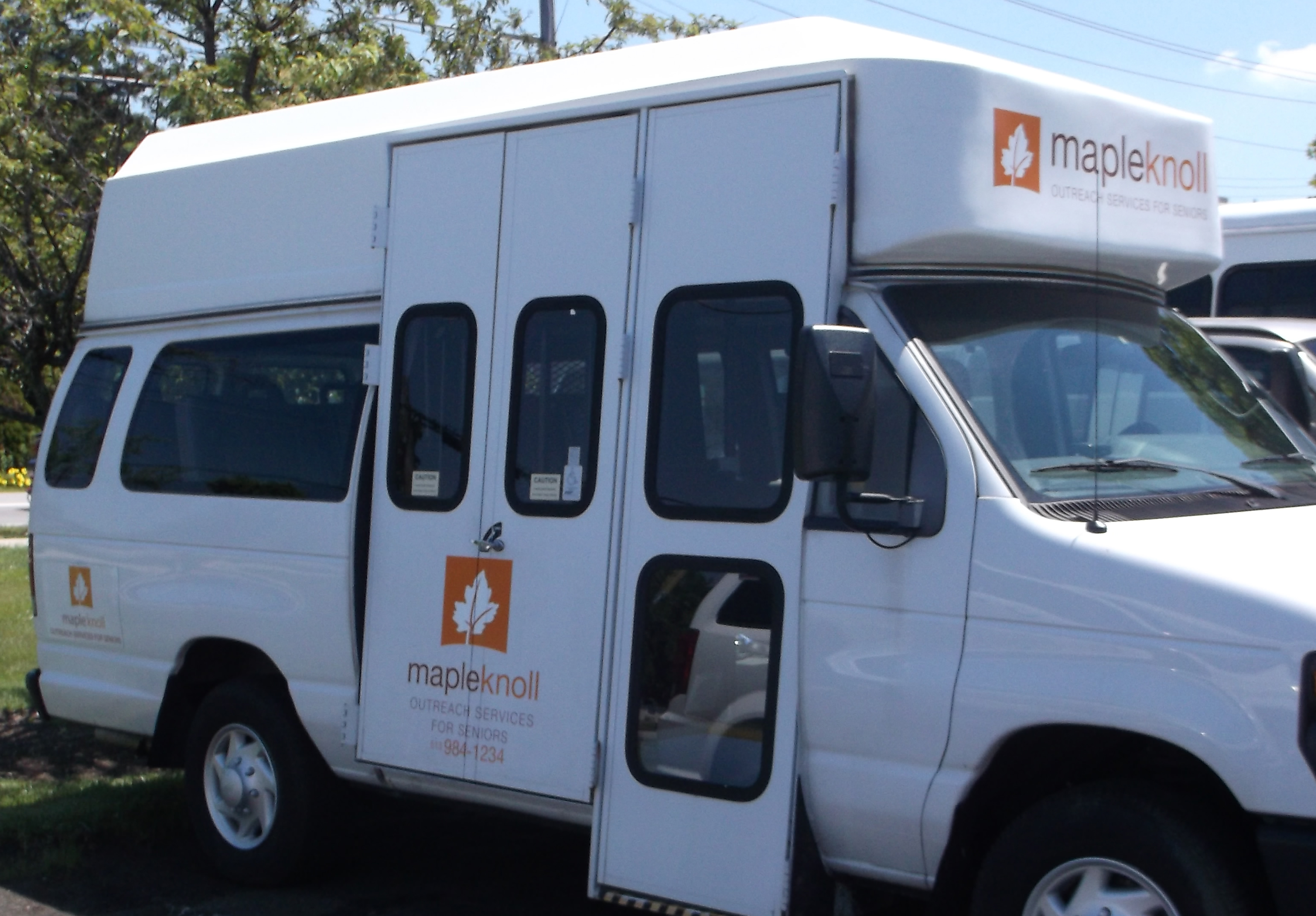

Do you have any pics of these fading issues?

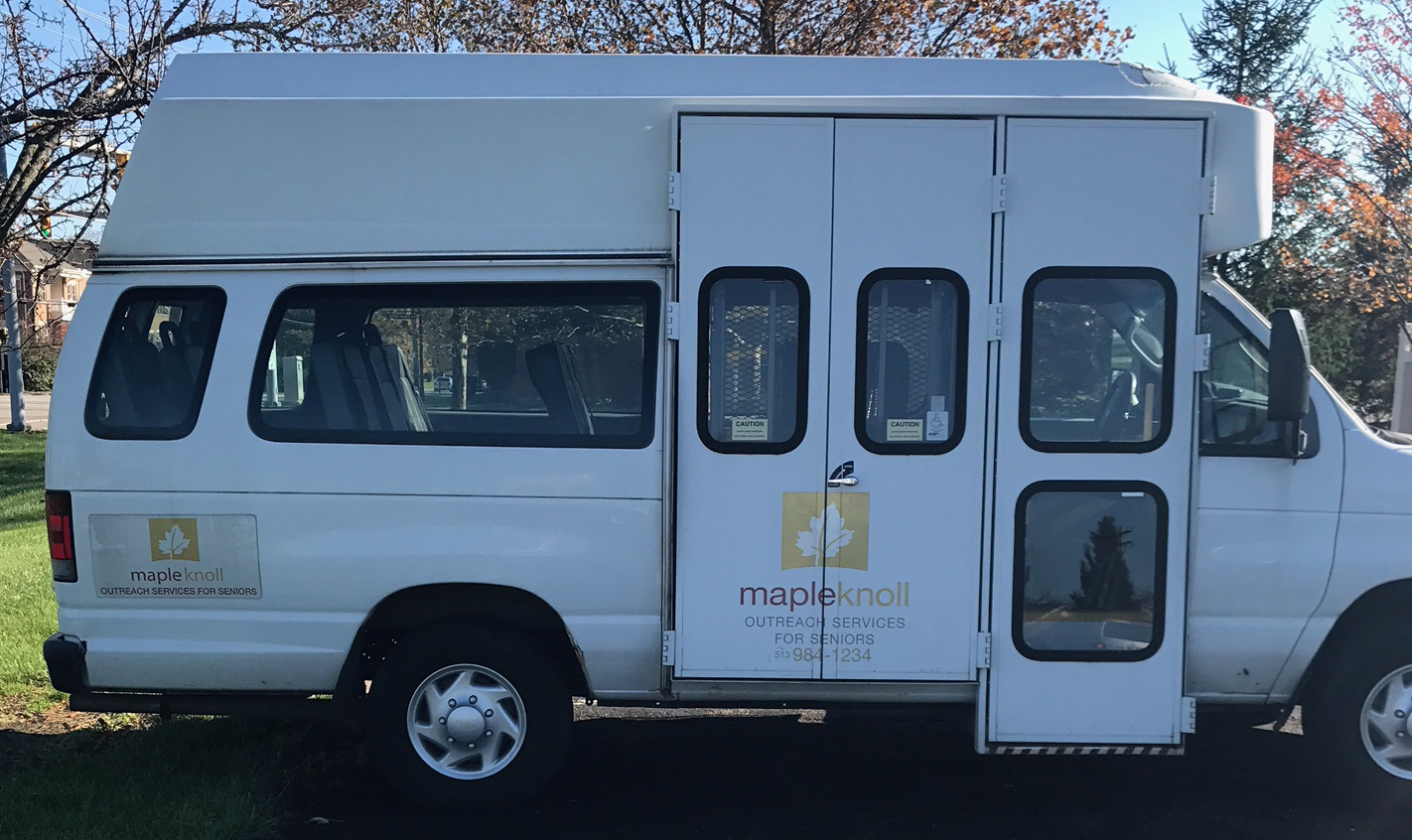

Yes, we most certainly did when we used a profile on our Epson S70675 that included those inks. (Epson kindly informed us they didn't care) We changed our profiles immediately and dealt with the consequences.
We went with the S60600 with MCS inks for our upgrades here to have warranted inks.

The Orange specifically, also the "light" colors. Fading within 6 months on vehicles, signs, etc. All 3M 180c with 8519/8518/8520 laminates.
Thanks for posting the pics. How long in between pictures of that van?
First thing we did when we got our s80 was print blocks of color for each ink, a few test samples, laminated and unlaminted. They have been on a roof for about 3 months now. Will pull some down and compare to the control pieces which are stored in the shop.
We haven't been running Red or Orange for outdoor work yet, but hoping these GS3 inks prove more durable that what was in the s70. Because the prints look awesome when using all the inks.
Would you say it was mostly the orange that gave you fading issues? You mention the "light" inks also, but they are still covered by warranty?

This looks very bad for a couple of months. In my climate this will happen in a week or two then. I wonder what about if was sealed using Marabu sealer for car vinyl
Seriously? A couple of weeks with laminated prints on decent media?
We're in a 300+ annual sun day, high UV region and now have over 5 years of examples to gauge fading from and we're not seeing anything remotely similar off a 10 year old Roland VP-540 that we're about to replace. We have a ton of work out there that even with western and southern exposure isn't showing anywhere near as much fading as some of the examples I've seen in this thread.
Right now we're reading this thread with great curiosity and hoping it helps us make a well informed decision on what printer to buy.
