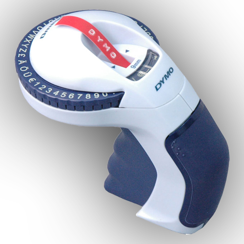

These cost less than anything Roland or Mutoh make. And after you've done a few thousand you develop a killer handshake.
