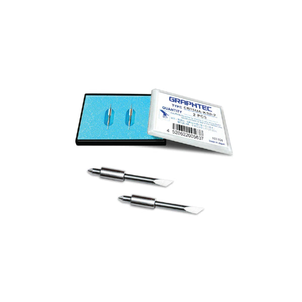

Are you using the correct blade?
You need this blade - not from this site... Just the first that's come up for me. And a cb15 holder. It's super expensive, but cuts through pris.atic pretty good. The more pinch wheels you have the better as well... We added 2 to our fc9000.
And then there's limitations. Cutting anything under 2" is a pain - well, cutting anything is a pain... Anything under 2 is hair pulling pain.

Hi Ikarasu - thanks for the info - we do have this genuine graphtec blade and holder - the biggest issues we've had (and others have said the same) is the 3M HIP media (3830 & 3832) we are using just slips on the rollers (The backing just wont grip on the rollers - almost at all.) It starts off seeming to be fine then (even at really slow speeds) it will just completely shift the sheet of media sideways and rotate it. We are using 4 pinch rollers - do you think more than this would help? I'm willing to try this with more pinch rollers - if I can get someone to say it actually works - just don't want to invest the $$ in more rollers if its not going to make a lick of difference...... How many rollers are you using?
It's at the point where we are going into much larger metal sign production and still using roll to roll printers so need a solution - or we'll just get a CNC flat bed router....
We were having some problems feeding longer jobs through our 9000, but turning up the grit roller pressure (all to high) and pre-feeding we minimized the issue.
We are using 4 rollers and some jobs will go over 100 inches with only a 1/32 to 1/16 depending on the backer of the substrate.

If you're doing high volumes.of thick reflective... Get a flatbed cutter. Doesn't have to be a big 4x8 one, the graphtec flatbed is nice as is the summa.
You can cut decently on the roll laminators, more rollers help... But when we cut 10ft long sections it still skews a bit, which causes the edges to not be perfectly cut and the weeding requires cleanup.
It's just the nature of the beast with roll cutters... You can get by with one, but if I were cutting highway signs every week I'd buy a true flatbed
