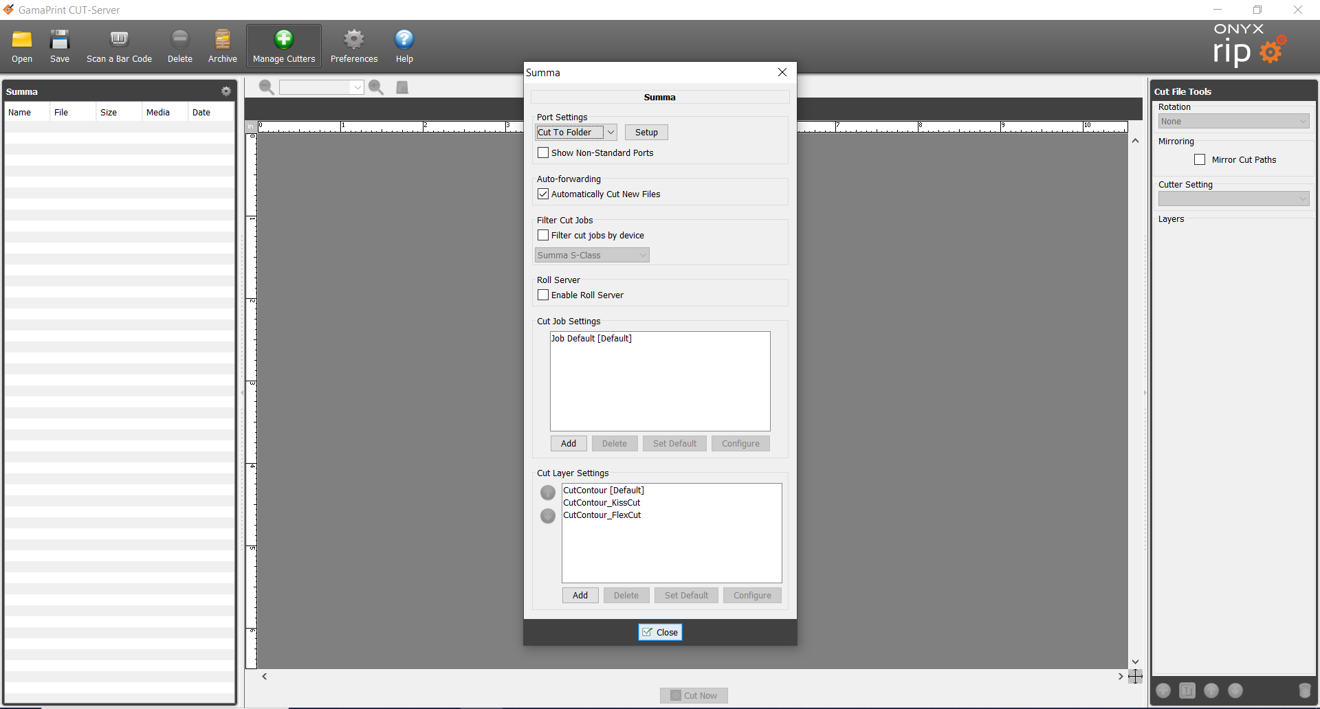

Hey Christian, I'd also be interested in hearing some tips to get different cuts to work well through Onyx to Summa cutters!
I'm jumping the queue, and you've probably already tried some of this, but this is what I do:
You should be able to get a "regular" cut and a FlexCut in one job by having your cut lines named specifically in both the file, and the >Manage Cutters>Cut Layer Settings window of the Onyx Cut Server.
For example, I have my everyday/default cut called 'CutContour' if I'm just doing my usual stickers. And if I am doing something (like a sticker sheet) where I want a kiss cut of little interior shapes followed by a flexcut or two around the edge, I have things named 'CutContour_KissCut' and 'CutContour_FlexCut', and that works great to get them both going in a single pass of the job. The key being having them named identically in the file and the cut server preferences.
What would be really great, is if Summa truly allowed 2 (or more) regular cuts where you could specify the weight individually at the cutter, and not be forced to use the FlexCut option. FlexCut, as far as I can tell, will always cut in a sort of 'Directional' mode even if that's not really ideal. It's also slower than a regular cut. You probably already are, but definitely set FlexCut options (weight speed etc.) at the cutter and not through Onyx.
This is exactly it. Sorry for my delay, but as Saturn mentioned, you can create 50 different layer names if you want... But you need to also have RIP server look for those in the quickest for cut path names and you need to have those spot colors in the input file.
An example that we do is CutContour_Inside and CutContour_Outside. Then when we have a lot of inside and outside cuts we can run the layers separately. They still both use the Tangential knife but they are separate layers.
