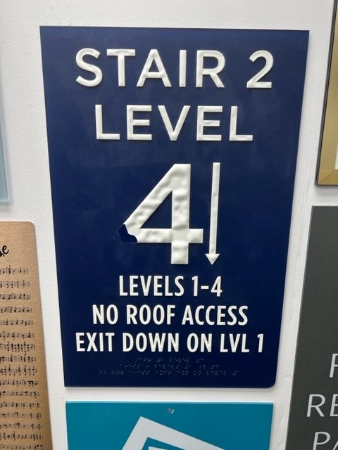

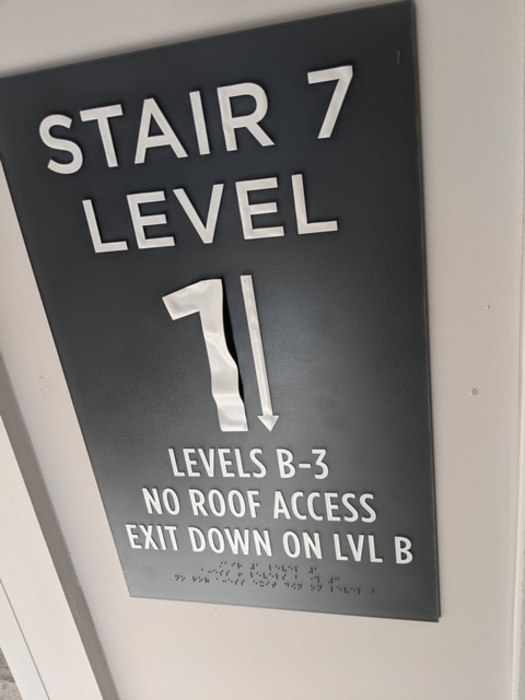

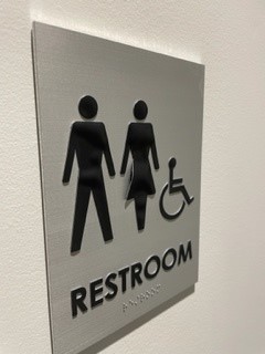

Our shop has the Mimaki JFX200-2513EX. We jumped on it pretty early and I'm now way more cautious about any of these printers that claim to print braille signs well. We liked it well enough for "2.5 D" printing but started having failures pretty early on and gave up using it for braille, opting to print the raised text on ada signs and still drill for raster braille beads. But even this strategy has had issues, we've noticed the thicker ink warping and cracking off signs months to years down the line. In case your thinking this is just a mimaki issue we've also been called in to replace whole properties printed by two other companies (one of which I know uses DCS) - both of which are out of state so I don't know if they were ever notified their signs were failing. This isn't something that seems to just happen on exterior signs or signs exposed to sunlight. Heck, we even clear coat our signs after the fact to help extend their lifespan but so far all but two of the jobs we printed when we were actively using this machine have failed.
I went to ISA expo last week and attempted to talk to the big names about the issues we've been seeing (You know what sales reps don't like? When you come up to them in front of other potential customers and say "yeah, yeah I like the machine but what about all of these issues?" and then you shown the pictures. I am an agent of chaos) I wasn't able to get any solid answers. Every other vendor I talked to swore they never had that issue and mimaki insisted it wasn't something they had seen before.
This isn't to say that we don't get any use out of the machine. It's become our go-to for TCO rush needs, if a client comes to us and asks for 300 ada signs by the end of the week we can accommodate that with temporary printed signs. But for the time being we're not using it on any real jobs because the failure rate is so high.

Wow, that's brutal. I've often wondered how thick built-up UV ink would survive long term.
Of all the companies making claims I would tend to trust Canon the most. I wonder what they have in terms of case studies regarding durability of printed tactile/braille graphics.
