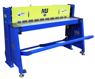

we use foot operated metal shears if you do a lot of that sort of thing well worht the investment
How do you keep the edges from cracking with the shear? Every time we've tried it the edges come out looking like we cut them with a steak knife.
Pat we use it all the time, cut alum up to .050, pvc & styrene up to .060
polycarbonate up to .050 and no problems (sometimes it pulls a little but the edge is fine

Warm it up a little and the shear will not crack the edges. Just a real quick pass with a heat gun. It takes very little heat. If it is hot in the shop it will cut without the heat.
Same here. Old pvc is more susceptible to cracking than newer plastic.
