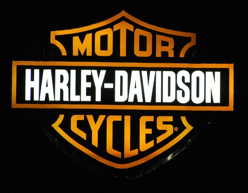

Black should be fine...use blockout vinyl or backspray it. There are hundreds of Harley-Davidson signs done this way and they look great - day or night (although the following isn't the best example).
