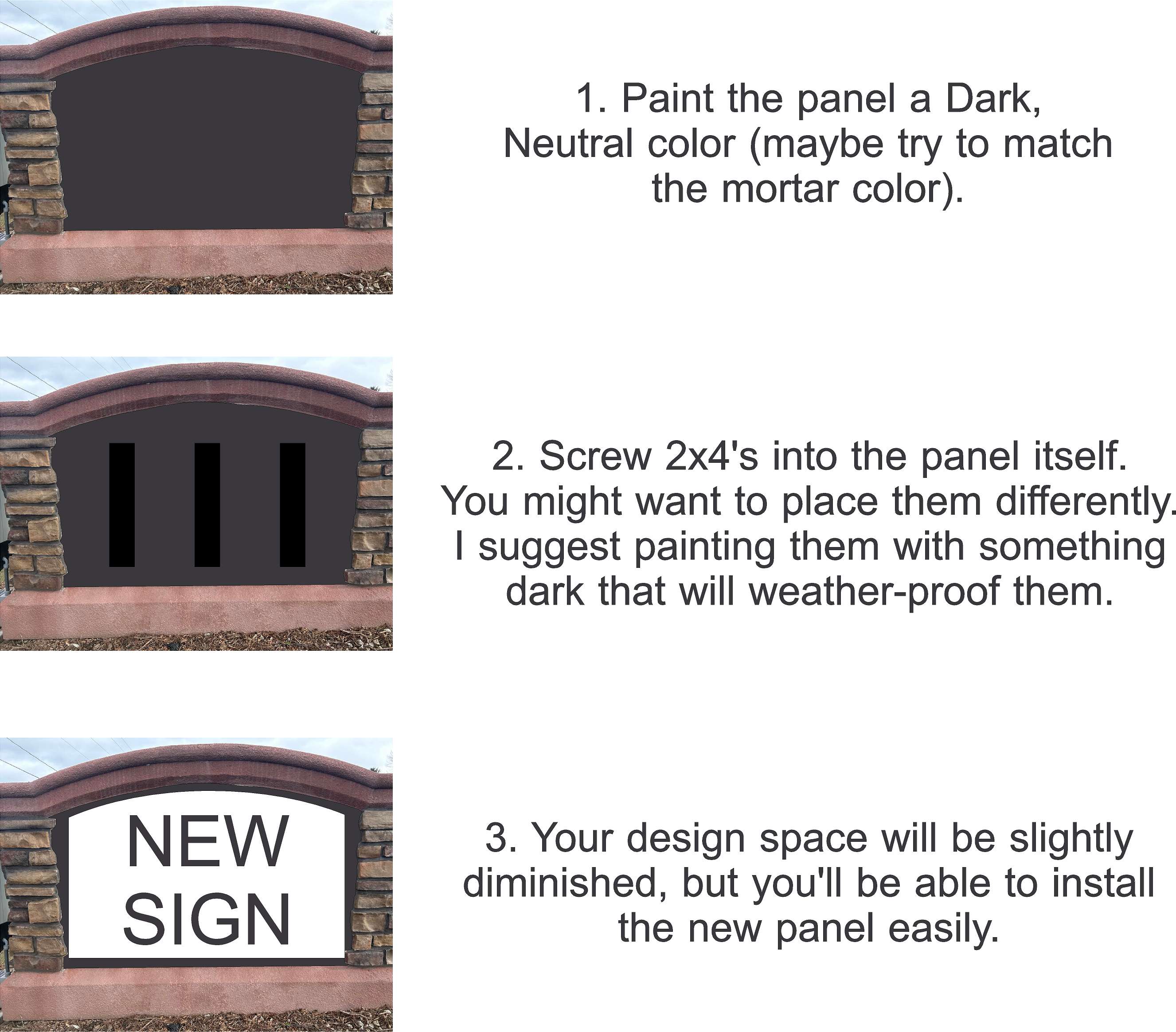

I've run into similar situations with those monument signs where irregular brick makes perfect placement tricky. One time we had the install guy out there with a saw shaping a panel on site; he wasn't happy and it wasn't our finest work. If you're abandoning the idea of cleaning the sign, or rehabbing it so you can place new vinyl on the existing panel, then replacing it is the only option, right?
The last time I had to do this, we just dropped some 2x4s onto the sign face and screwed them deep into the sign (we were installing a HDU sign, not an ACM panel, but the principle is sound). You'll have to consider birds and bees thinking this is a perfect spot to make a home, but it will give you a nice flat surface to mount your sign to. If you had the owner paint the recessed area, then you'd have a good backdrop, and your sign would float out of the sign. It worked for us, maybe it would be helpful for you.
That's a great idea! I'll see what happens with this...I sent the quote out, thank you!

That's how I would do it. You already have the shape from round-2, paint the backing, use that as the shape for the new panel, and yer' golden. Next time they change it, tell em' to just call you to remove the vinyl (or panel), and when a new tenant comes in, you'll just lay a new one, which will be cheaper in the long run. If you think it'll make too a good bird nesting place, you can always use 1x4's instead of 2x4's, or short standoffs to make the panel removable.
