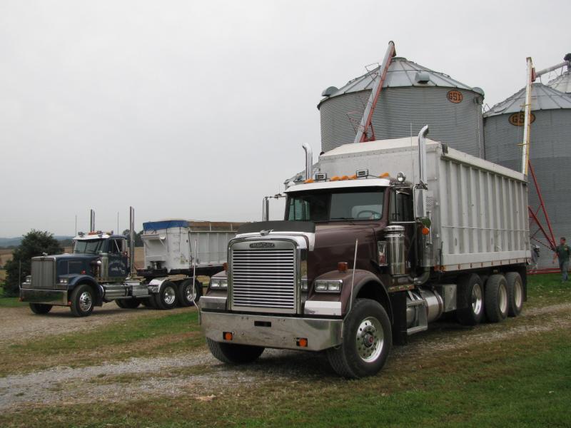

I have a potential customer coming my way, thanks to a friend. I'm trying to better prepare myself for when I discuss the job with the customer. He is a grain farmer, looking to have graphics installed on his transport trucks/ trailers. Up until now, I have really only done smaller jobs... contractor trucks, and other smaller vehicles. I'm just looking for some guidence on the best way to go about this, because of the shape of the trailers (photo attached).
I'm thinking the best way would be to apply the graphics to a panel, and then install the panel onto the side of the trailer. But, maybe someone with more experience has a better/ different solution?

I think you have the right idea.
An aluminum panel .080 or better screwed or riveted onto those ribs would do the job - look good & be much easier to get right over trying to apply directly onto the sides.

You could also offer the alternative of just running a line of lettering down that straight part at the bottom, it's at about eye level.

i would install over the corrugation myself. after you have settled on a design, stretch the image out before cutting to compensate for the loss you will have for running in and out of the corrugation. i have done this once before and it' turned out great and wasn't hard to install at all. i also cut it vertically instead of horizontally, made installation a breeze.
to see how much to stretch, measure the depth of the corrugation(s) and add it to the length of the truck
