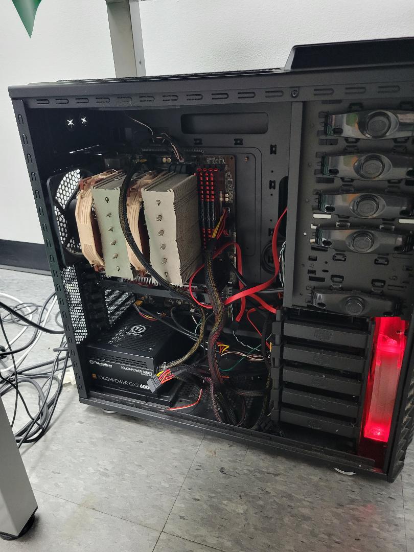

My main computer at the shop was built in 2013
3770k (was 2nd fastest consumer cpu at time of build)
32 gig ram (crazy amount for 2013)
Rx580 (added a few years ago as the 4870 from 2013 does not support 4k resolution)
Ssd (added sometime after 2013)
Originally had WD raptors hdds
Just last week the 10 year old power supply died and was an easy $75 fix.
I'm surprised this computer is still going strong, handles light design work and chrome, rips.
It's so Dusty and sticky inside
Murals and other heavier design work I do at home on my 7950xt

The day after I buy the new power supply without any research, LTT releases a video bashing this PSU, although it is a best seller.
Found out old PSU was dead on Sunday and had no choice but to grab something off the shelf at bestbuy 10 minutes before closing. I'm sure it'll be fine for a few years until motherboard capacitors start failing due to old age..
Temps are great despite the cooler being covered in 10 years of sticky dust.
No cable management here, new builds are way better cable management

This sounds like mine, just a few years newer. Currently dreading having to install win10 on a new build. Current build from 2011.
2600k
16gb ram
gtx460 (replaced with a 1070 when it fried)
130gb ssd
Also replaced 1 power supply thus far
Only difference, mine isn't too dusty/sticky.
