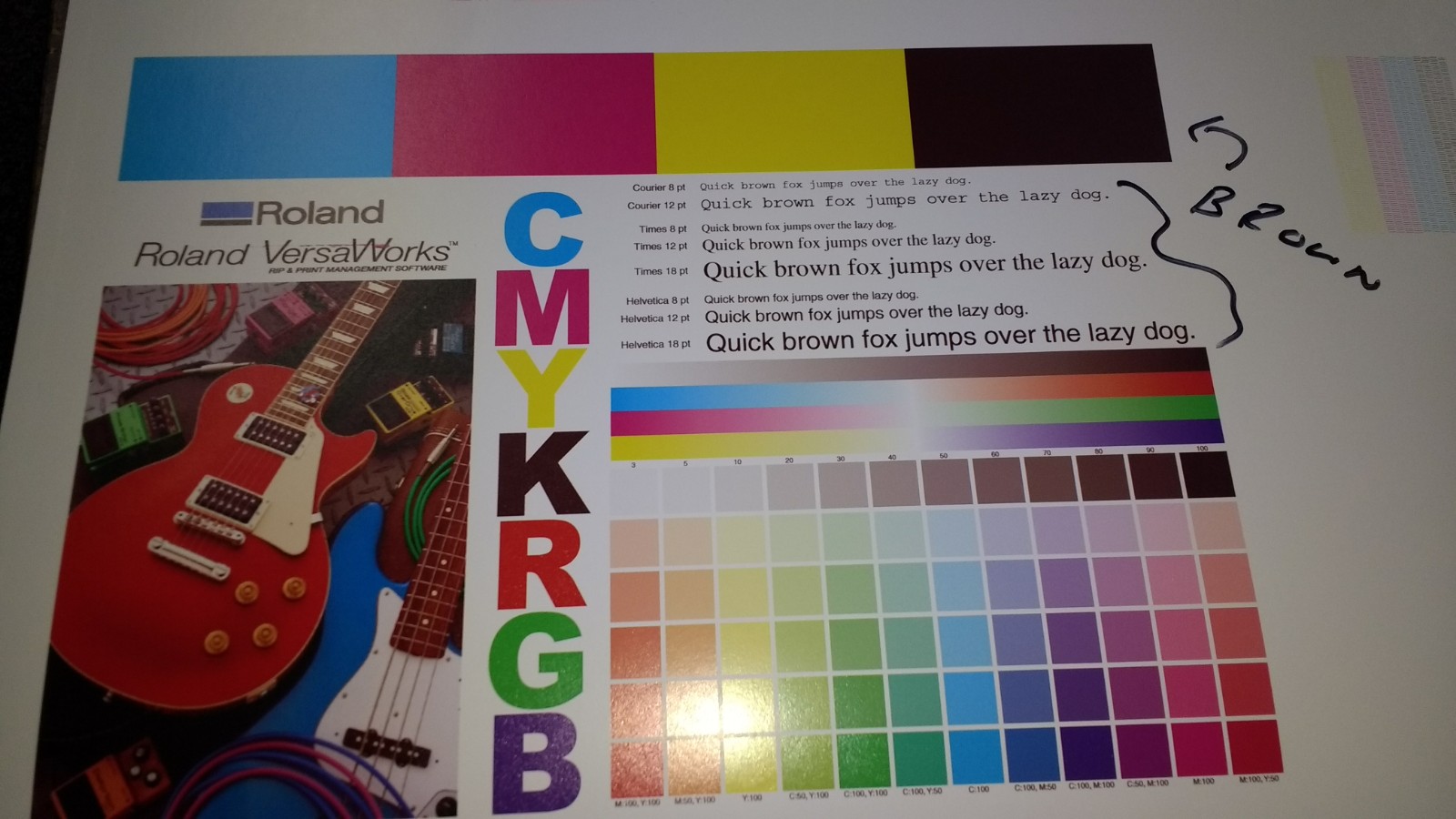

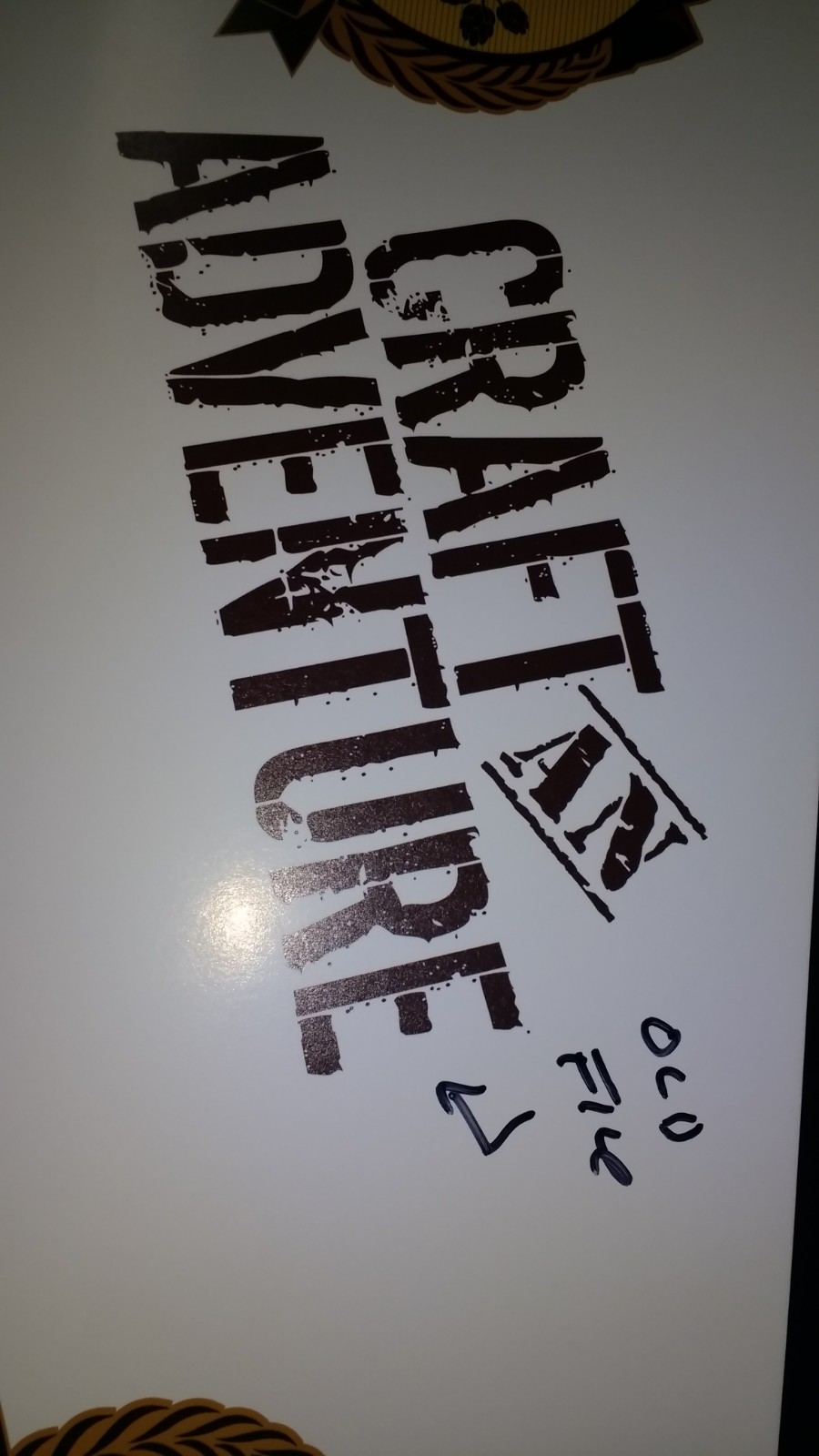

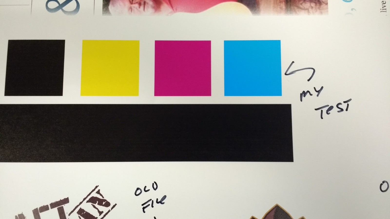

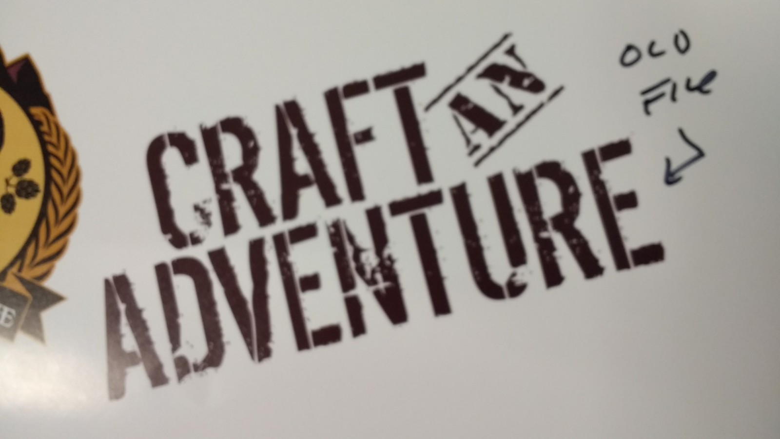

All of a sudden my Blacks are printing Brown and some colors look like the are missing black. My test print looks normal w/ a few deflections. The Roland test print prints brown. I created my own cmyk color blocks and printed them. They printed brown as well. If I check preserve primary colors it prints OK, but when I go to my clients files and try the same I get the wrong colors. I've tried different profiles and jobs that I've already finished, same result. It was printing fine up to the point where we had the power go out for a few minutes. The Versacamm is on a Battery b/u so it never turned off.

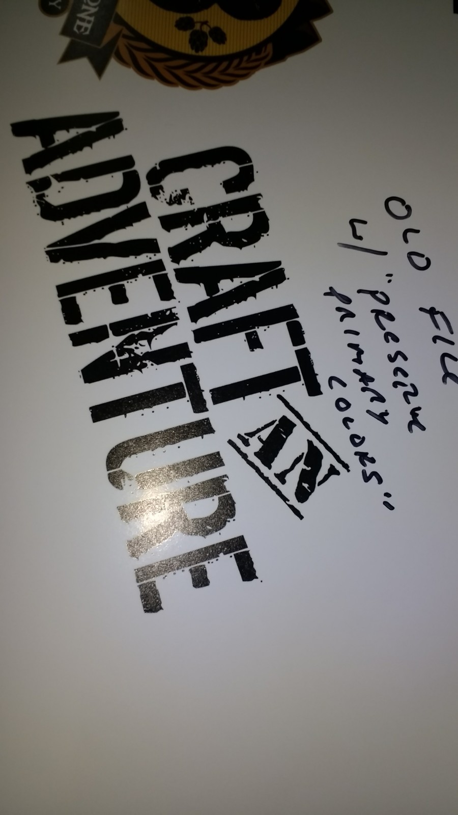

On the images of the "Craft an Adventure" it will print Black if "preserve Primary Colors" is chosen, but this doesn't work for all the files I've tried.

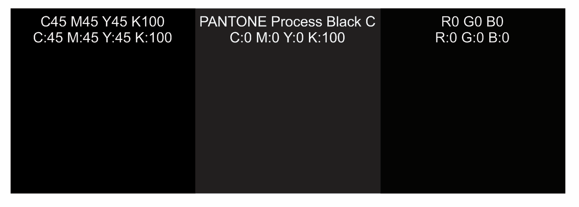

What color is your black?
C0 M0 Y0 K100 = bad
Process Black = bad too
We use either R0 G0 B0 or C45 M45 Y45 K100

That isn't the issue. 100% black should still be black, maybe not the best black. But definitely not brown. It just happened all of a sudden.

Nozzle check looks good, black is black on that. When I print a roland color chart "2" the black part of the Roland Logo prints brown but other lines/crop marks print black.

I'm pretty confident that this is not an issue at the printer. For example: I printed the "color chips" built into Versaworks. I only printed the black ones. All of the swatches printed fine, but there is a Roland logo (Blue & Dark Gray) next to every color chip, the dark gray portion of the logo prints brown instead of gray.
