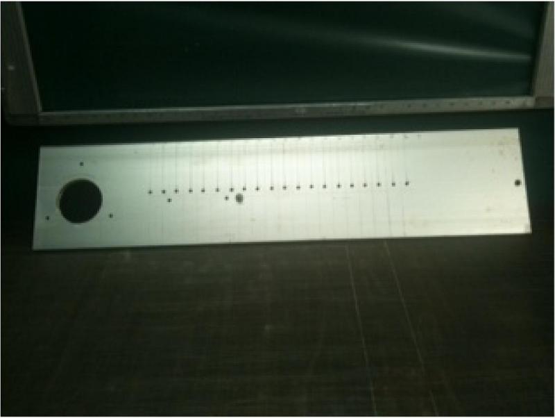

About two years ago, I had a project that required me to cut about 200, 14 inch circles out of expanded PVC, 1/2 inch thick. I made the attached jig then used a trim router to make the cuts. The router mounts on the left side as shown in the three hole position. I use a 1/4 straight flute router bit. Once set, the router won't walk on you and cuts a perfect circle. The jig is made out of a 3/8 x 8" x 30 inches long aluminum plate I got from the local junk yard for about 20 bucks. Guide marks are at 1/2 inch intervals. Mounting hole size is 1/4 inch.
