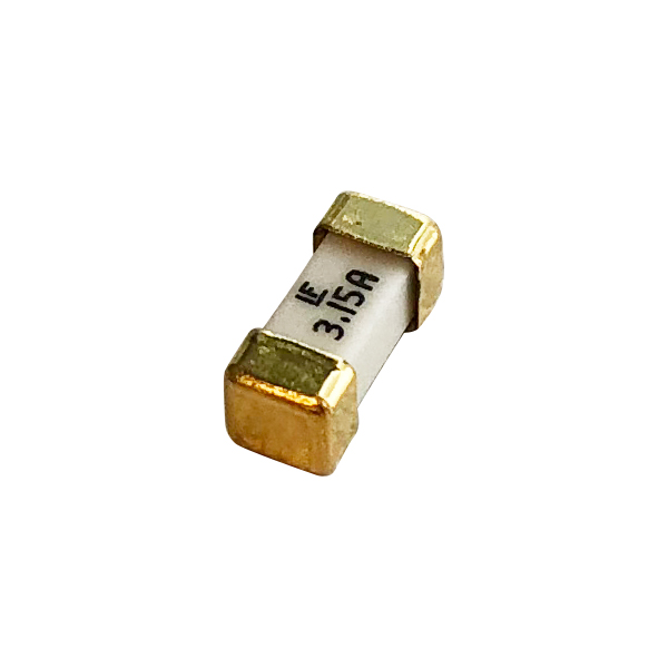

That shows the heads and pumps are working, so it's electrical. Double check all ends of the cables going to the heads, but make sure you disconnect the power completely and let it sit for a while so capacitors can discharge! Just turning off the power switch leaves current flowing to all the boards. If you mess with any internal cables and don't have it disconnected you can cause damage. If you did anything with it still plugged in, you may have blown a fuse on, or damaged the head board.
Rolands have fuses on the boards, if you're lucky that's all it is. They look like the attached pic (different numbers for different fuses), test them and see if one is blown, if so make sure you replace it with the correct part number. If it was the main board you'd most likely get an error on the display, so it's probably the head board, either a fuse on it, or the board is bad.

Both 3.15 nano fuses had blown. I’ve replaced them and they are fine, I take them out and check with a multi meter and put back in.

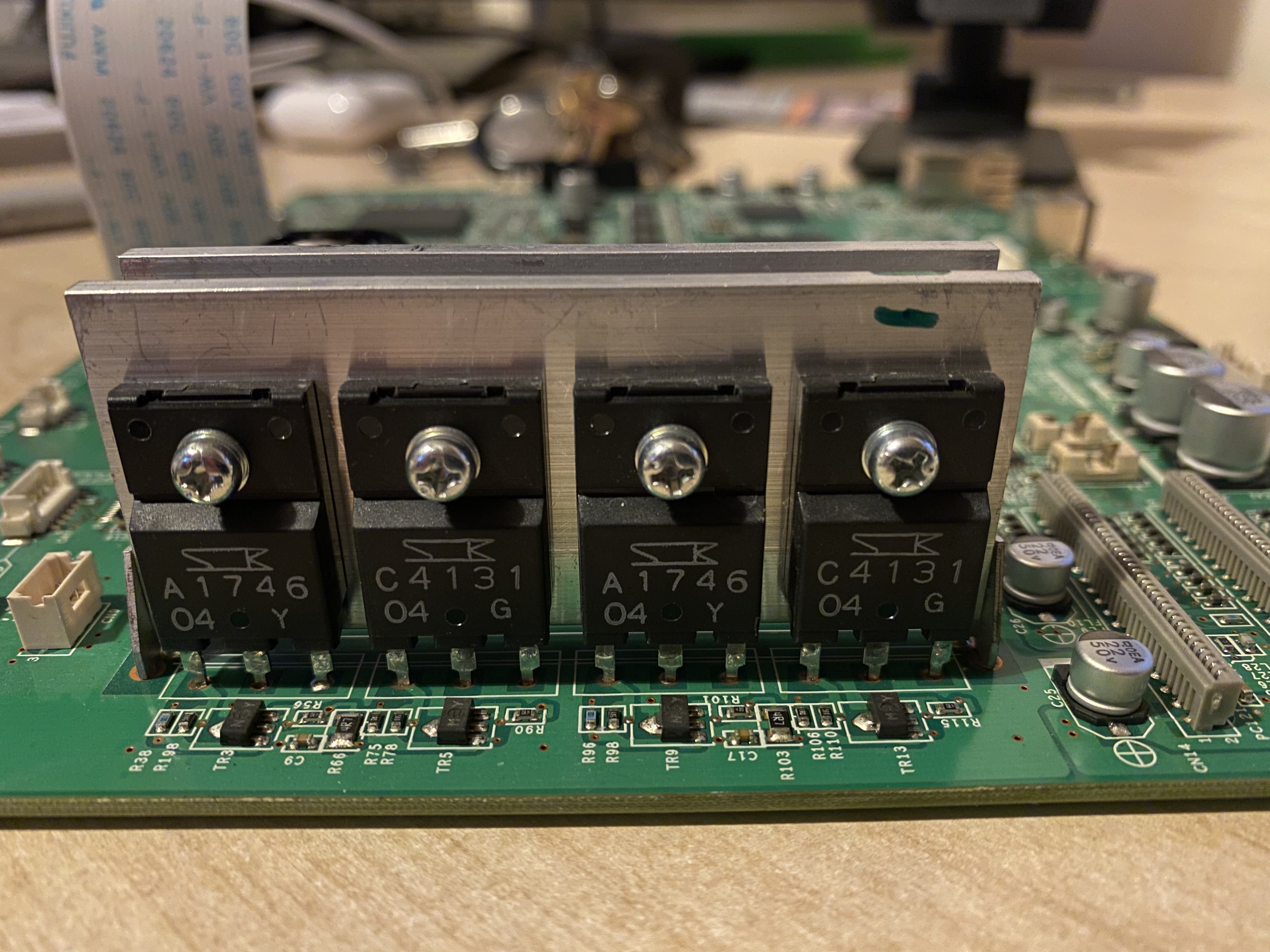

…one of the Transistors was shorting out…..the board is in for repair…fingers crossed this was the problem.
unmateria
Be careful, that is the consecuence, not the cause. After mainboard repair, replace all the flat cables (can sound stupid, but the problem is usually there... Those flat cable dont like ink at all lol) and look into printhead connectors for ink spills or something inside (u need a microscope). If it blows again 1 time, dont do more tests and replace printhead or you will end in point zero again having to repair the mainboard
