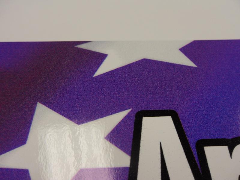

Hey, folks! I have a file that I have printed before, partial wrap - NOW the flag is printing purple instead of blue. Have cleaned the heads, etc., changed the profile to everything I can think of, to no avail. Anyone have any ideas why this is happening?

Thanks, Marsha! I probably didn't give enough information on my Roland - SC 545-EX, using versaworks to print from.

super grainy print. looks like a hardware issue to me.
Thanks, Pro! I am using scrap pieces, as I have used so much vinyl trying to get this to print blue ... I also noticed some of the profiles in versaworks print like that, and others don't. gggrrr :banghead:
MikePro
banding in the print leads me to believe that some cyan isn't laying down over the magenta? what's your test print look like?
also noted, your black seems to be "overspraying". you might have some head issues there.
ProWraps
its been my experience when you can see the dot pitch like that, that youve got some drop out on the nozzles. run a nozzle check and post it up if you can.

Try this in VersaWorks it may work:
Quality Tab
under Color Management go to Properties then go to Vector Data and select Colormetric
And check Preserve Primary Colors
See if this is going to work.
tomence
Also under Color Management have DensityControl selected, I dont know exactly where it was in Color M but you will find it.
This will only work if it's a vector file
sar bossier
GOT IT!!! Somehow, the color profile was RGB, changed it to CMYK, and BAM! We have lift off! Thank you to everyone for the assistance! Y'all ROCK!!!
