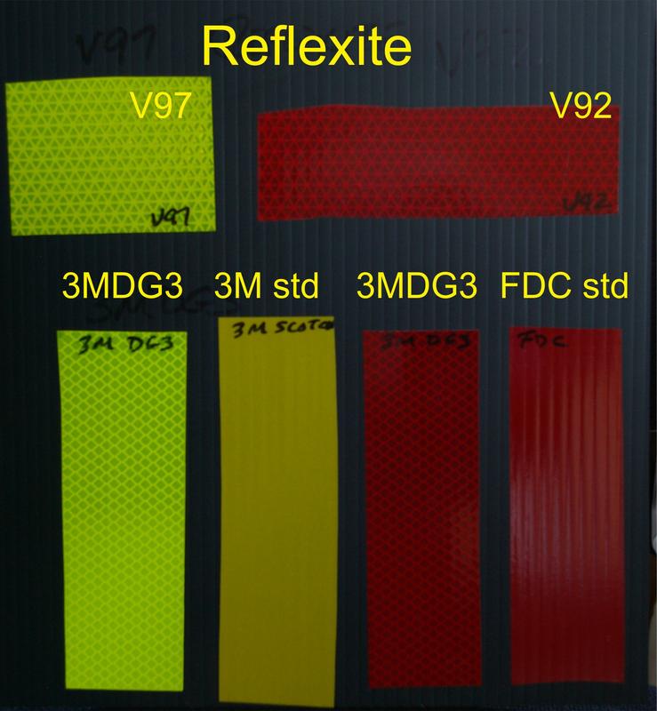

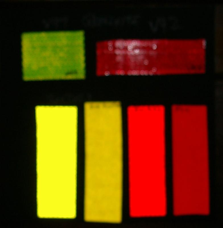

Interesting thread. I looked into the Reflexite for the ease of application and wasn't impressed with the quality (vs the 3M diamond grade). I even had to do a little 'test chart' for myself to see what the differences were between the two brands, and personally, I don't see the Reflexite being anywhere near as reflective as the DG.
attachment.php
attachment.php
Photo taken in a dark room, hence the camera flash couldn't focus on the panel. The shot was a straight on shot, so the reflective angles are all the same.
