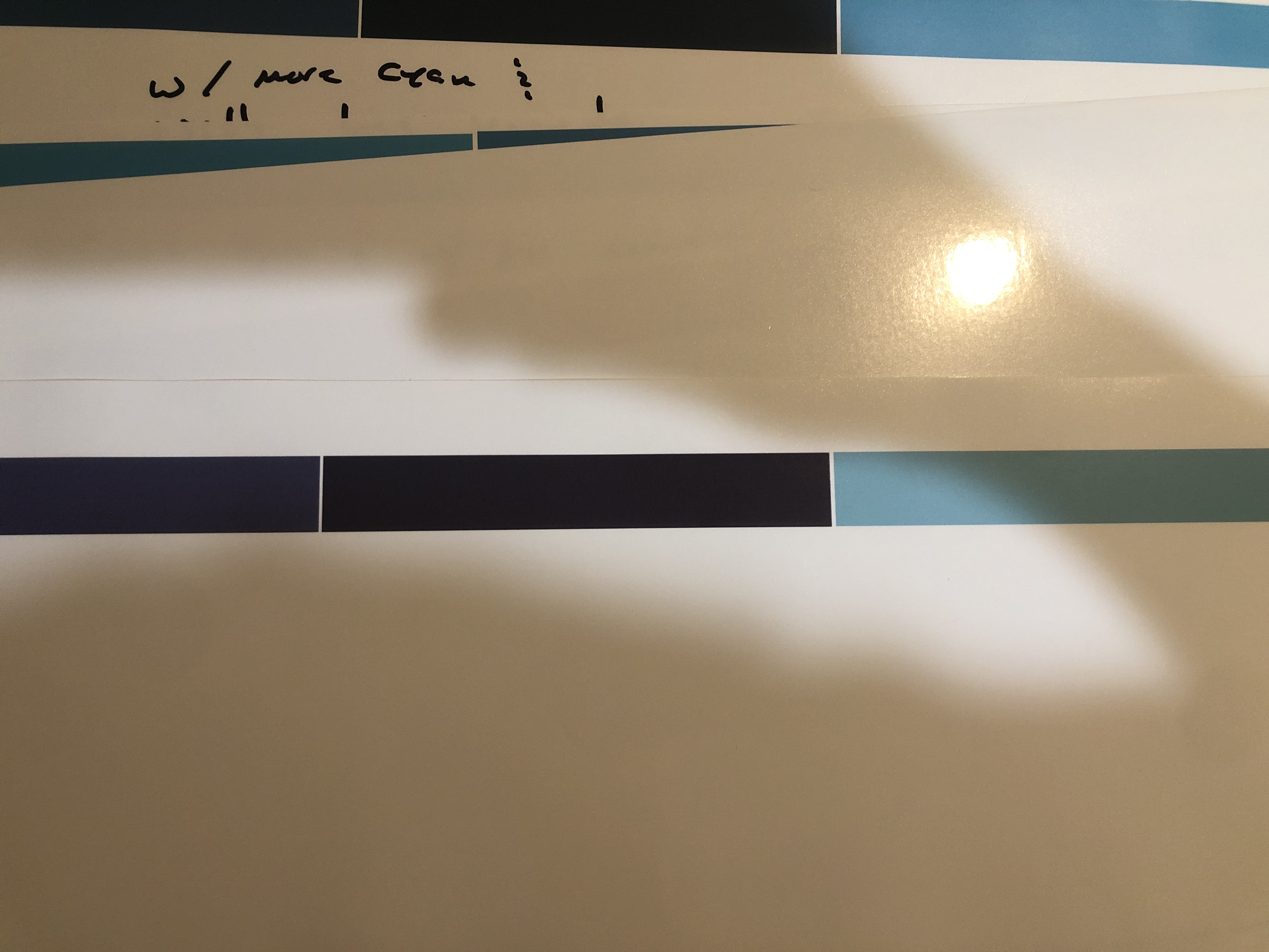

I have a l26500 HP design jet. It’s a bit old and mostly all the cartridges and printheads I can buy for it our third party. (Unless I want to pay crazy prices) Recently replaced my magenta cartridge since I was having this problem and replace with a HP cartridge. (Printer wanted me to replace it eventhough it was pretty full). Replaced one magenta printhead as well.
Still having issue. My blues print purple. I’ve included a picture of printing three shades of blue, two print purple while one prints light cyan.
Any suggestions as to what I should try to do to fix issue?

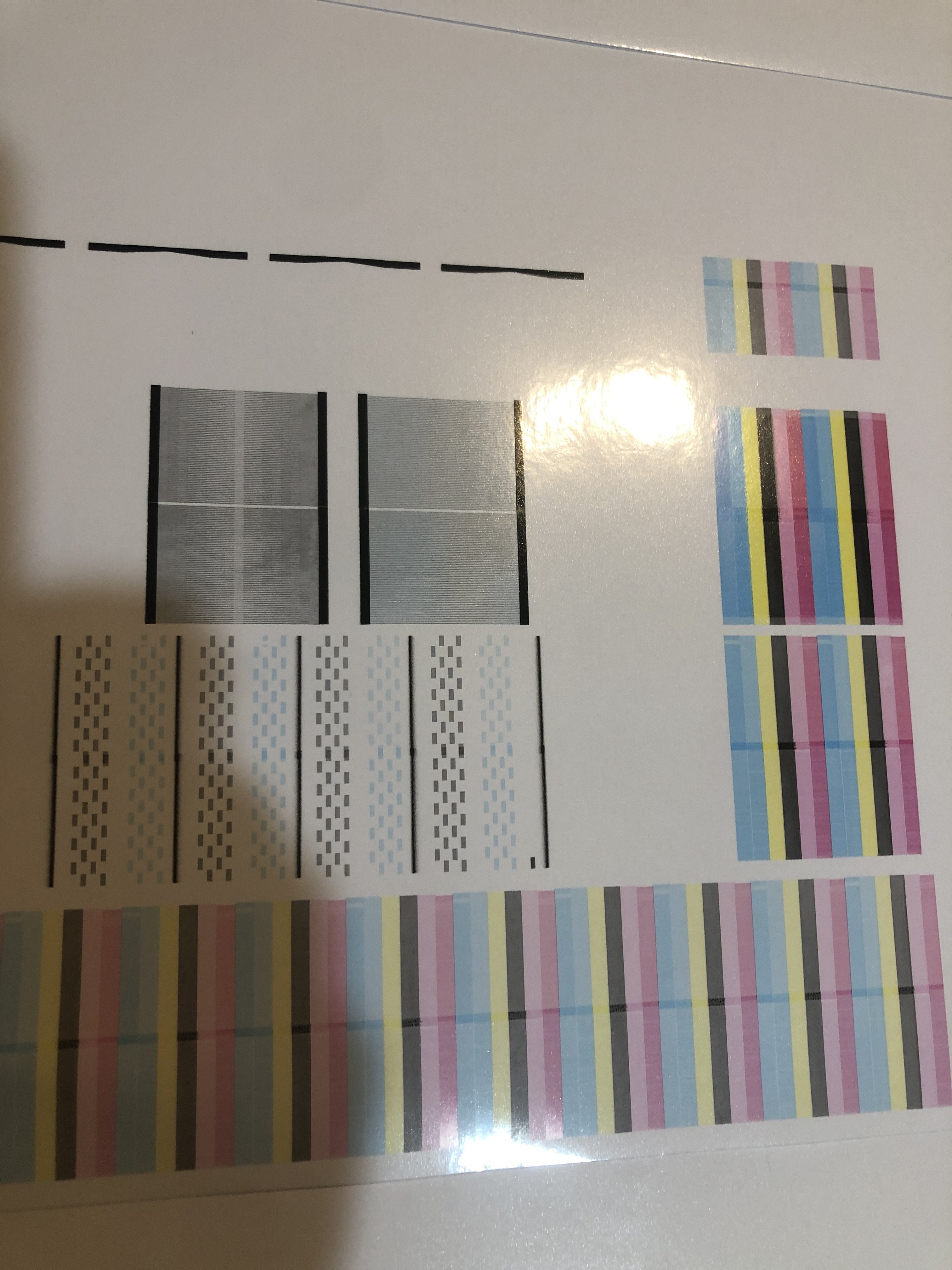

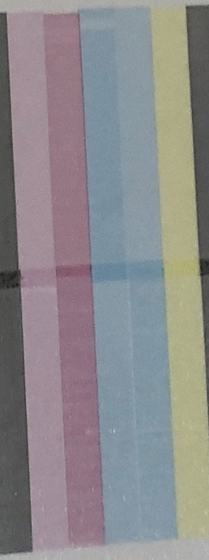

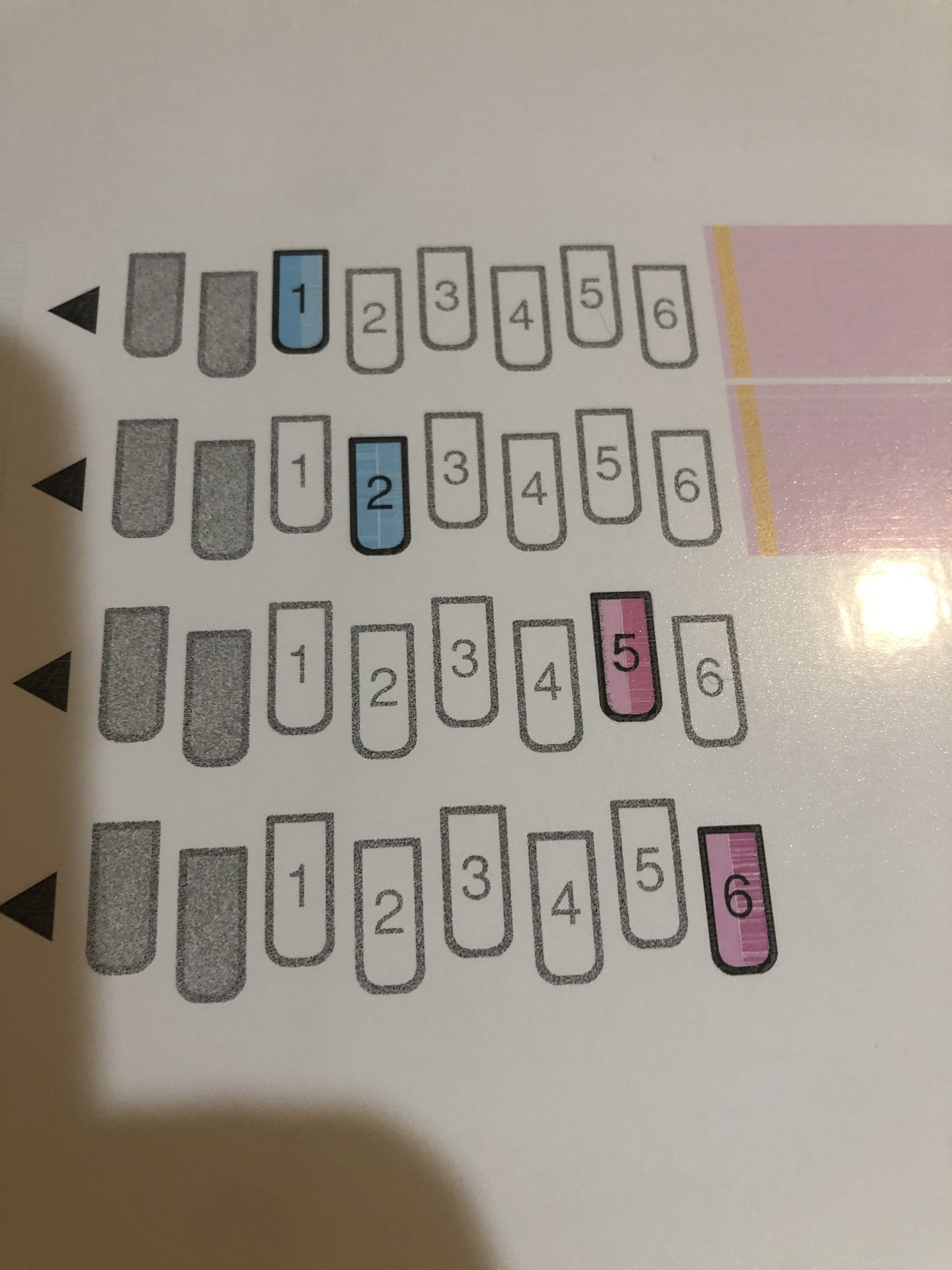

Take a look at those cyans. Then compare that to the magenta. Your light-cyan / cyan is completely messed up. I don't know which is right and wrong.
And you know because of all the aftermarket heads and inks, you probably have other issues that's not so easy to figure out.
After you get a headache from that I recommend to recycle the machine.

I’m looking at the printhead test plot and my cyans dont look any different than all the other colors…to me. What am I not seeing?
balstestrat
Problem Solver
I don't have a baseline to compare against but to me it seems like the shade of cyan and light-cyan is too close to each other.
Look at magenta and light-magenta.
But again, this might not have anything to do with your problem considering all other factors.
