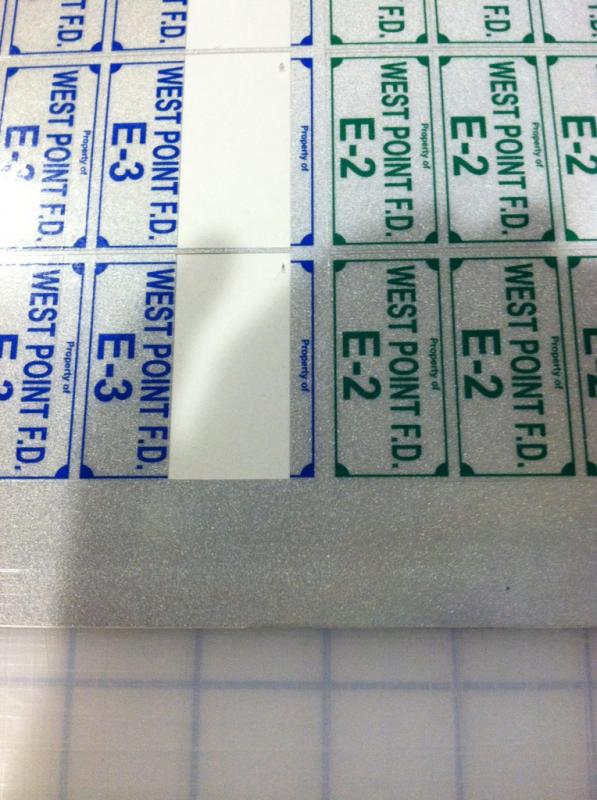

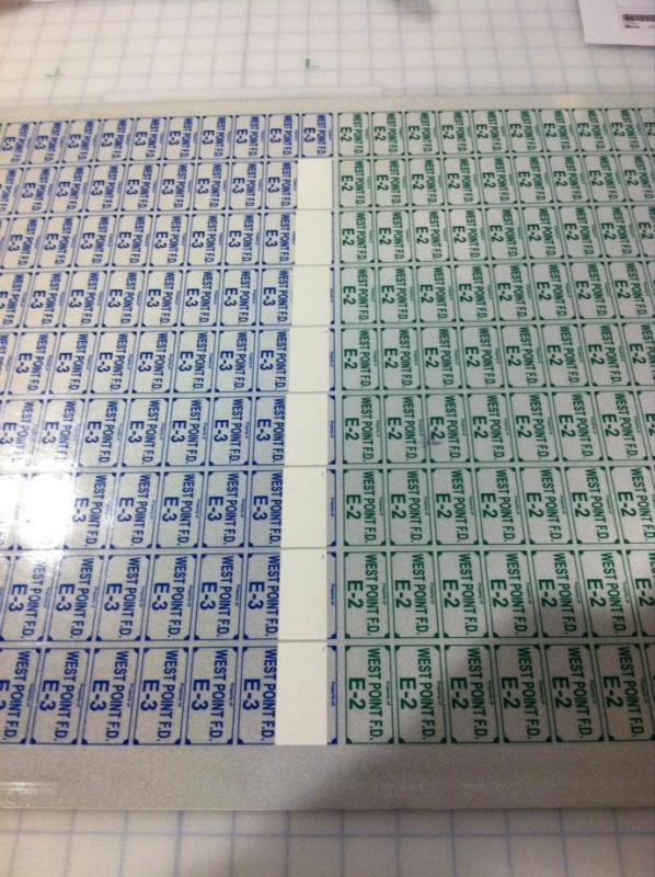

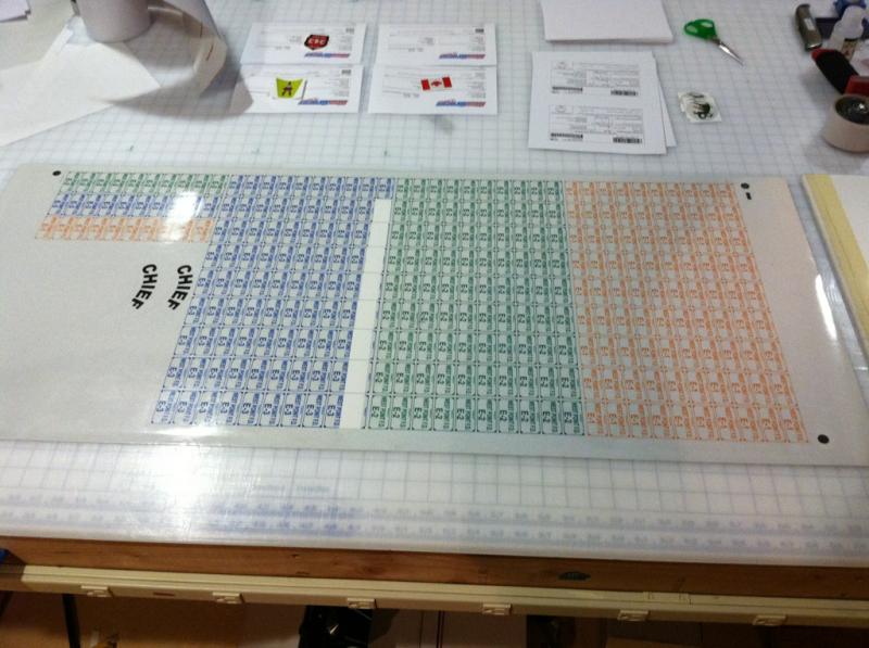

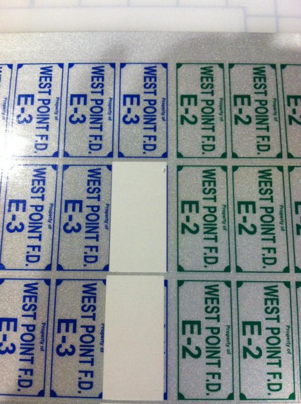

So I was running off a bunch of reflective FD equipment decals on my BN-20, the first half of the job cut dead on. Then it wen downhill fast from there and I cant figure out why. the pictures below show what im talking about, and ive had it before where it mis-reads a crop mark and the whole cut is skewed but the part that has me puzzled is that it cut fine through half of the job, then it incrementally gets worse, not skewed, just cuts further and further down each pass. The "dancing ants" in versaworks don't look like that either. I'm puzzled.
I removed the top decal on each of the "off cuts" so its more visible.
Any thoughts?

How thick is that material? It looks like your pinch roll wheels are losing grip during cutting. Have you contacting tech support about this?

I've HEARD reflective material has hard time reading registration marks if the lighting is high in the room (because of the reflection). Try turning the lights down real low when you're reading the registration marks and see if that helps...

as for the material, its oralite 5600 (5mil) with 210 lam (2.5mil)

No, wasnt ignoring you, like I said in my first post, Ive noticed when it mis-reads a crop mark, the entire cut is proportionally skewed. this was more of an abrupt, drastic change.
Tech came out and it ended up being a bad pinch roller on the left side. Swapped it out, and its been smooth sailing ever since.
