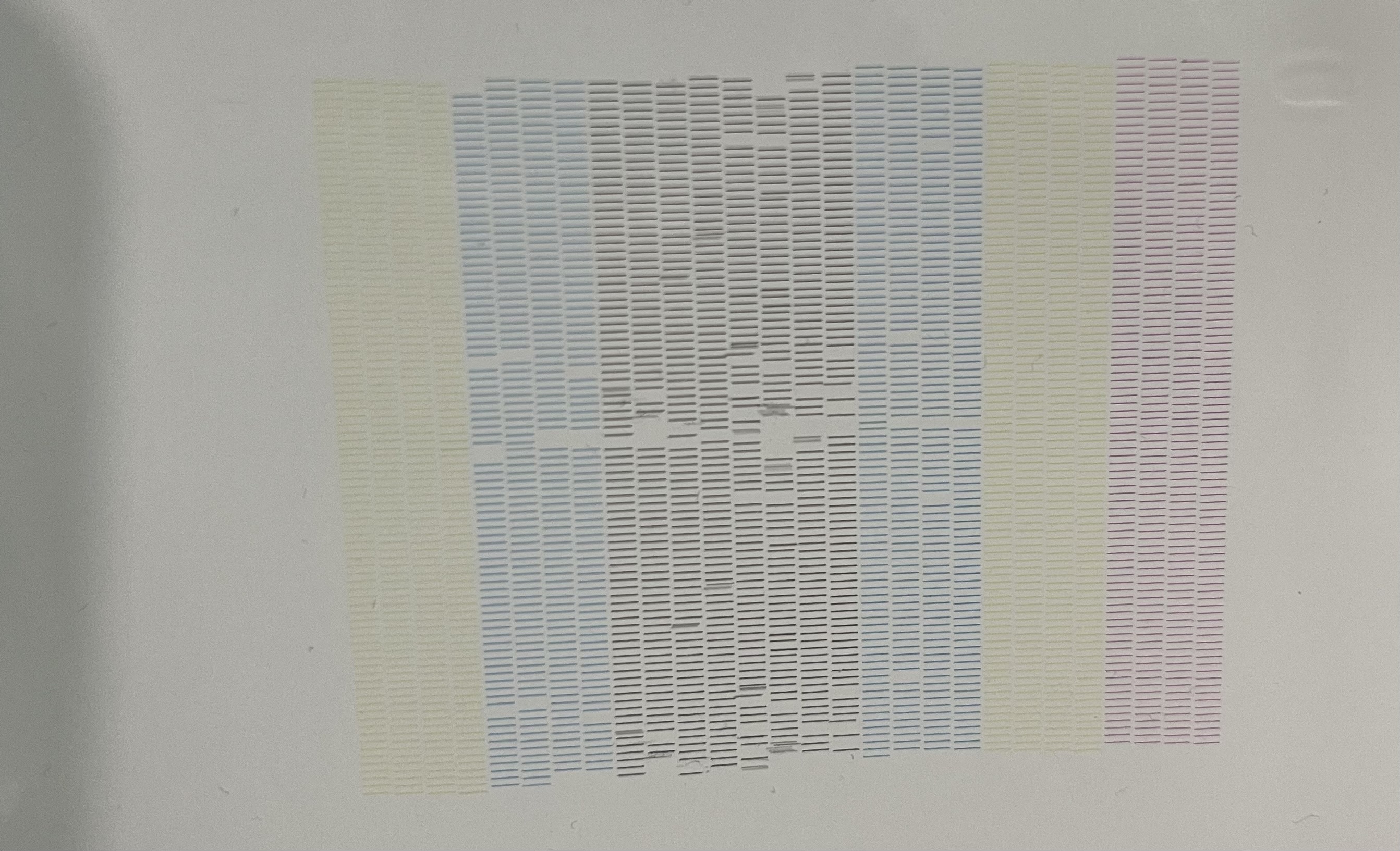

Hello, after I did a strong cleaning on my device, the magenta on the far left started not to print in the nozzle, what do you think? :(
After 2 strong cleanings, I did a nozzle test.

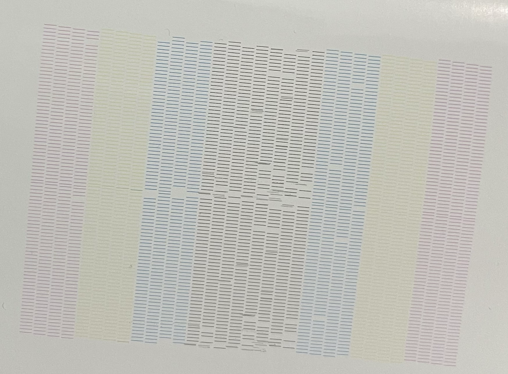

I cleaned the device manually, but still the magenta on the left does not print. What should I do please help?

dweavers
have a visual check to make sure you have magenta in th line that leads to that channel, when did you last replace the captop? if older than nine months then replace. also consider a head soak for 48 hrs

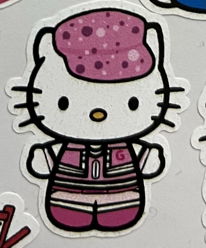

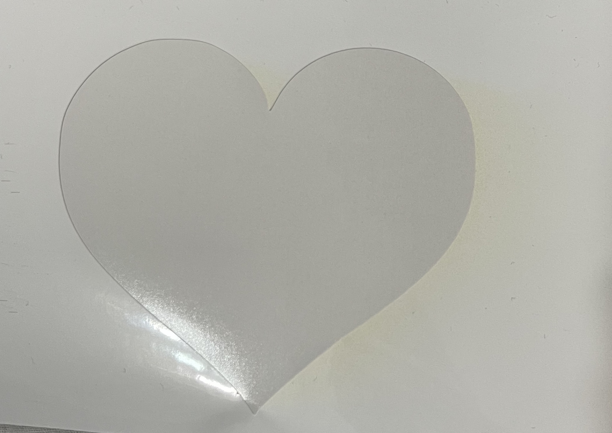

mfa53
The printer leaves black dots where it should be white. I still haven't figured out why.

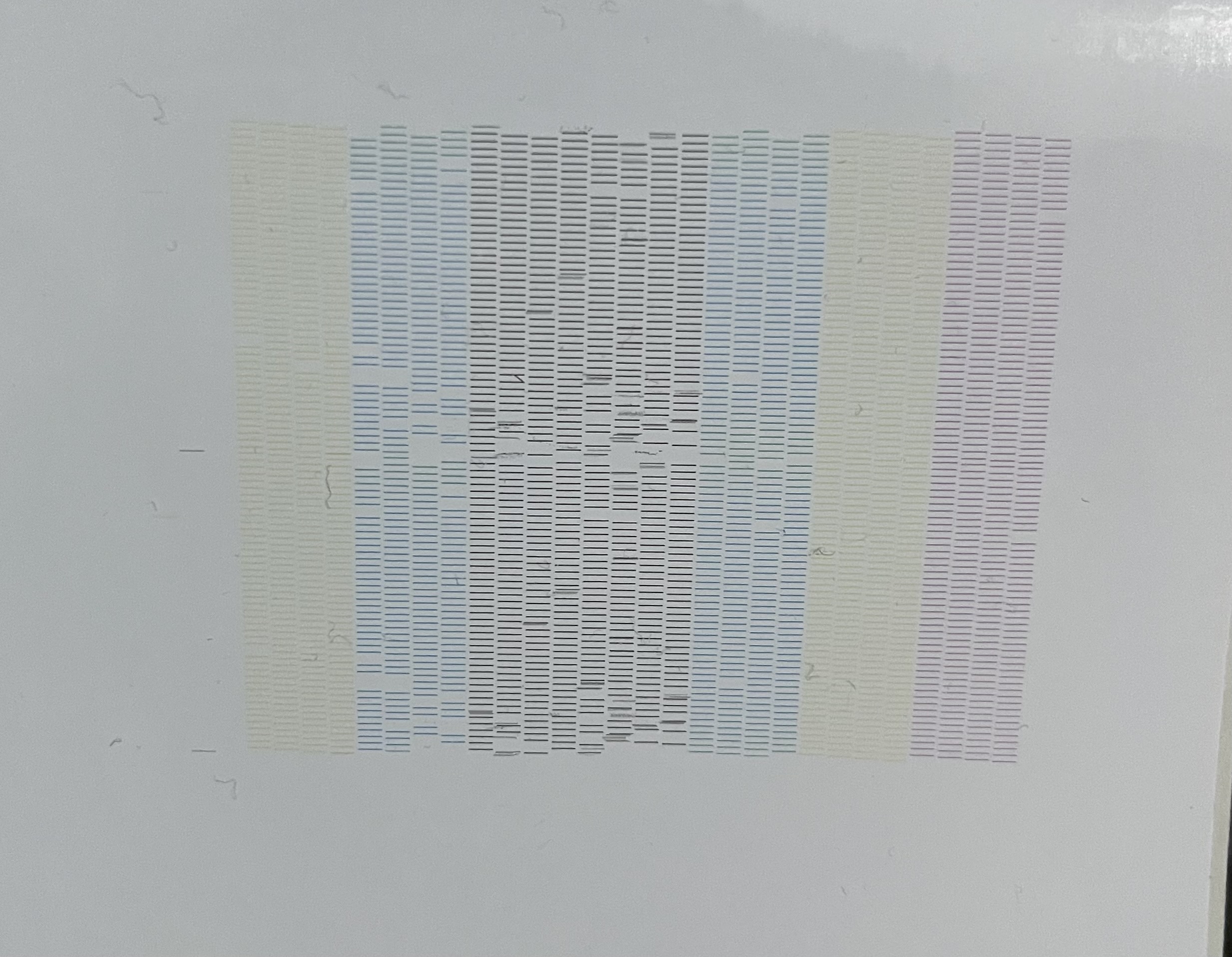

mfa53
What does work nozzle test / test print look like?
There are defects in our black nozzles, but when I pressed something red, it still left those spots, but as red, not black. I can't understand anything, I've tried everything, but I can't get any results, I've been researching for 1.5 months. I cleaned the encoder strip on a recommendation, I cleaned different parts of the device. I changed the cap, I changed the wipers. But I can't get results, when I bought the device from a person 1.5 months ago, there was no such thing. I cannot reach an authorized service. I found a person who says he can do head cleaning, but I can't trust him :( the syringe cleaning is scary to me.

Zoogee World
Domed Promotional Product Supplier
As you mentioned, there is definitely some deflection in the black and some missing nozzles on other colors. Did you try a 48 hour head soak? If not, it pretty easy to do.

Zoogee World
To do a ahead soak, you turn off the power and un plug the machine, then you unlock and move the head over off the cap top. You'll need to un screw the cover around the cap top so that you can get access to the lines after it, then you need to clamp off the lines and fill the cap top with cleaning liquid then lock the head back on the cap top and leave it, you can check on it after 24 hours and add liquid if needed. After the 48 hours, run at least 1 powerful cleaning and a couple mediums, then do a test print to see if any nozzles come back, if you're still having issues a new head could be required.
