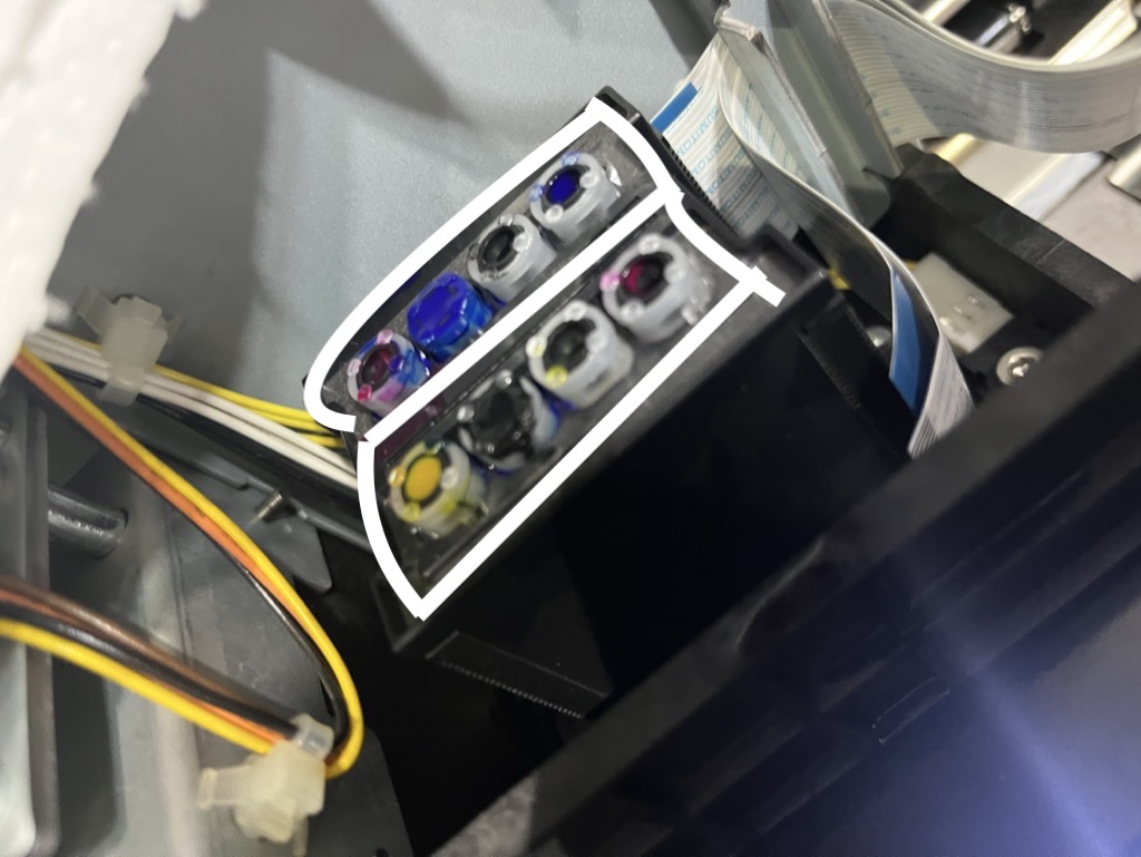

I changed the damper, but now I'm afraid to take it out and get ink in it. Because I don't know how to do it because of that protective cover on the dampers. It has to be inside the dampers because the cables have to be connected. But they don't stay stable inside, and I don't know how to get all four of them on the head. Because they don't stay straight. I am really sad
Based on what I'm reading, it sounds like you're way beyond your comfort level and knowledge. You might be at a point where it would be a good decision to bring a tech in to service your machine.

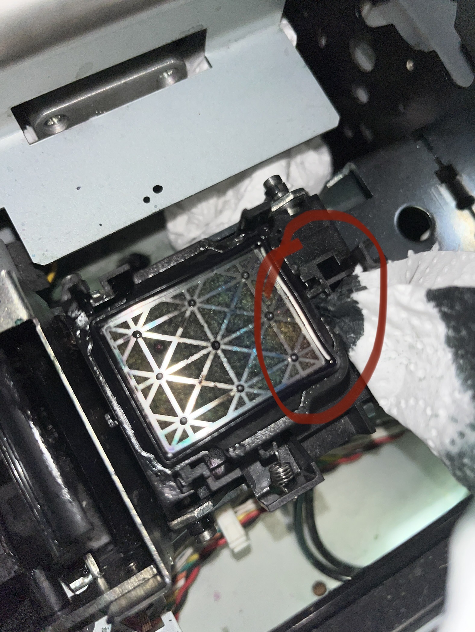

Hi, waste ink is leaking right down from where I marked it, what do you think is the reason? Can you help? Thank you also for every comment. I've learned a lot thanks to you.

When I look at the head from the underside, it looks like normal every time, when it comes to that part, I can't see a paint discharge. But somehow it's leaking paint right down from there. When you come to the cap through the wipers, there is no paint on the head. The printhead fits right on the cap.

Sounds like the cap top might be clogged. I'm still thinking based on what you were saying the other day, you should really consider bringing a tech in at this point. That way you don't waste anymore of your time and you get it fixed. If I were you, I'd watch and ask the tech questions, that way you have that knowledge for the future.
