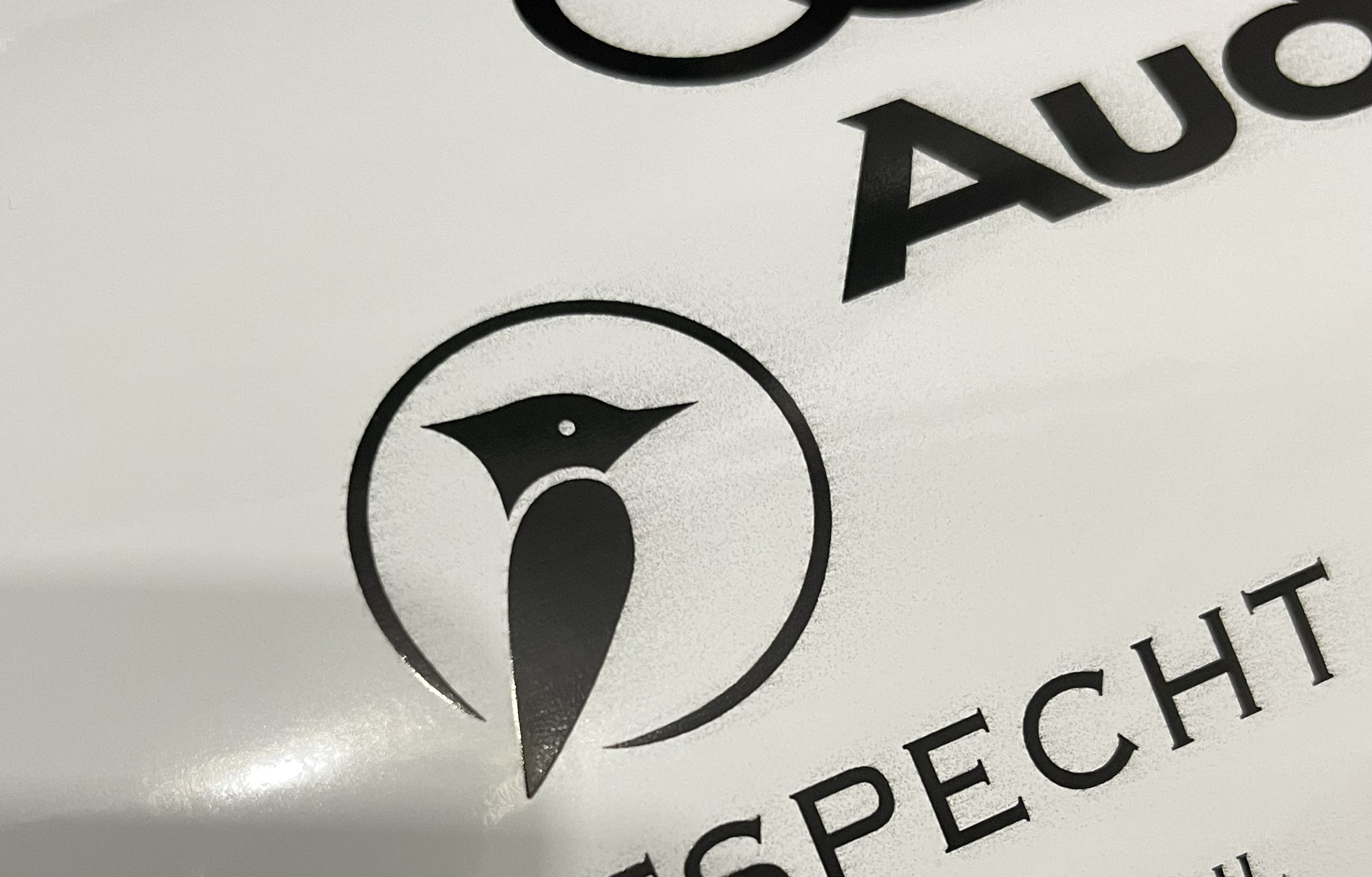

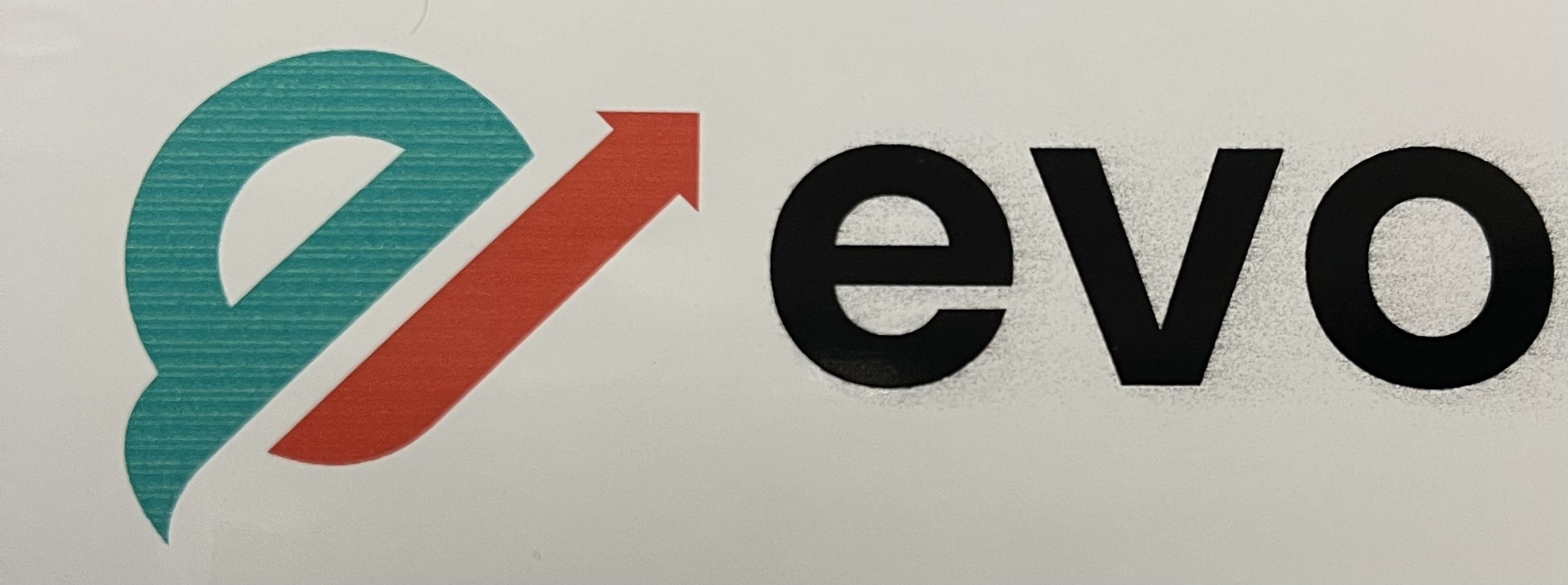

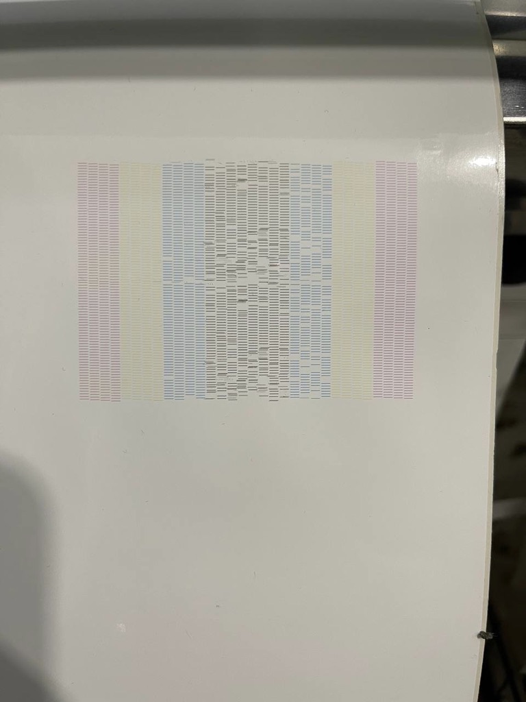

Hello,
I just bought my BN-20 device, I'm a little far from such machines. I have watched training videos many times. I did not have a problem with printing when buying. But because our magenta paint was finished when we bought it, we waited for 2 weeks to get a new one.
And at this time, we did not use the device, it only did automatic cleaning by itself every 8 hours.
Although the black ink is 80% full and I do normal, medium, strong, manual cleaning, it leaves such stains on the edges of the print when I buy a print. It only happens in black, we still can't figure out why.
Thank you in advance for the answers.

Are you sure they gave you the same printer that you watched them use? It looks like the print head is bad.
bigkahuna_305
Could be static, lint on the head, hair on the head. Give it a good manual clean and check the print head if there is any goop stuck to it as well.

It actually looks like the usual "encoder strip is dirty" again. Although it looks like you may have to do a manual cleaning to the printhead, which is probably due to it sitting and if the magenta cartridge was empty, then NO cleanings in those two weeks were done. The printer requires ink in ALL cartridges to perform a purge cleaning.

Hello, thank you for your comments. When I spoke to a Roland technical service, Cap told me to put some cleaner in it and do a medium cleaning after 15 minutes. But even though I did, there is still no change, some more nozzles have improved. I am doing manual cleaning and now I am trying the method that the technical service says by increasing the minutes.

Was the nozzle test perfect when you purchased? Cause if it was on its way out when you bought, you got stuck with the lemon. A replacement head for this is expensiveeeee.

I'm a certified Roland tech since they started building water based inkjet printers... I hate replacing heads on BN-20, but that's exactly the only option left, if you want a decent print quality.
If your problem was missing nozzles, cleaning might be a option. But with all the deflected nozzles in black, there is no chance this head can be fully recovered.

Hello, thank you very much for your valuable comment.
We continue to clean the machine manually and within the program.
We've visibly corrected the nozzles from our first test so far, but not every nozzle opened.
As a last resort we will buy and try 5 head cleaning cartridges.
There was a noticeable smudge reduction in print as the nozzles improved a bit.
As far as I think and see, some black nozzle tips are not fully open or closed. It does not give any pressure when it is fully closed.
I think this way, when printing on a place, the machine knows the ink that should flow from the tip and it flows accordingly, but if the nozzle tip is 30-40% open and it should give 100% on the paper at that moment, it cannot flow, and because the head moves, it reaches a place that it should not print. It's slowly leaking because the paint remains (gravity :()
I hope I explained it properly. In fact, if the nozzles are fully closed, maybe this will not cause this problem, but some nozzles are neither fully open nor fully closed.
Is there any chance that the 5 cleaning cartridges will damage the machine? Do you think he can clean the nozzles?

Clean the head and captop properly. Then perform a head soak overnight with cleaning solution. Then perform a couple of medium cleans. You can set up a print with wide stripes of cmyk to get the nozzles firing.
If this doesn’t work, the head is done for.
If the print test was perfect when you bought it, the head must have been damaged in transit, or you left it switched off for too long and the ink dried up. A hard lesson to learn.

Probably not. The encoder strip is the clear piece of plastic that you see towards the inside back of the unit when you lift the door up. It runs the entire width of the printing area. This gets dirty from overspray after a while and needs to be cleaned. Do NOT use cleaning solution or get fingerprints on it.
Follow the second video as a dirty encoder strip will cause banding and fuzziness in your prints. When it's really dirty, nothing will print correctly, and it will look like a giant fuzzy blob. You will think you need glasses because of how blurry it becomes.
