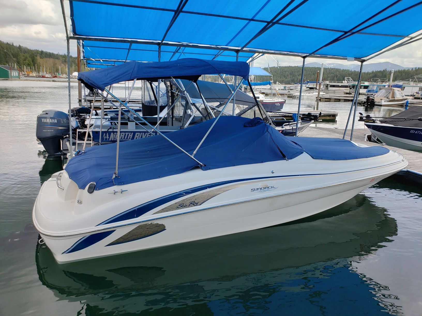

I'm bidding on a job to redo the graphics on this boat (see picture) and need some advice. The original vinyl is flaking off, so it all needs to be removed and a similar design installed. I want to go with cut vinyl only, a metallic blue and metallic silver (no metallized chrome and no printing). The customer is okay with that as long as the swoosh design is somewhat similar. Is Oracal 951 a good product choice for boat graphics?
I've never done a removal on a boat before - how do I approach this to bid it correctly? I have a feeling it's going to take more than a heat gun and a scraper. How do you handle oxidation/discoloration showing? I'm going to look at the boat this week to take some measurements and check out the condition of the existing vinyl. It's in a garage, not on the water.
Any tips on taking measurements to recreate the existing swoosh shapes as closely as possible? I told them it won't be exactly the same, but pretty close.

first off metallic vinyl not a good choice especially on watercraft...nonetheless if this were my job I would take pic of boat side view , straight on and replicate stripes on computer and then size them out to match existing.
As far removal I use razor and alcohol as with everything . I can also buff the area under the stripes if there is fading. Fiberglass is soft if you have never removed tell them to hire someone experienced to do it, you can cut into it pretty easy

If you need to make a template here's what we did. Taped plotter paper to the hull and went over that with crayon. Took the template back to the shop and struck a 12" grid over it.
Took a photo and scaled it in Illustrator.
You may not need to make a template since I made some for a Sea Ray Sundeck. Never got a chance to use them because of Covid. Can't remember the year of the boat but they should work.
Also have a bunch of comps. PM me if you're interested.
Simple way to do the graphics since there will be a ghost line in the gel coat. "Trace" the ghost line with wrap cut. Install wrap film over wrap cut. Pull line to cut film then seal edges. Done.

This is an easy one. 1st take straight on level pictures of it.
To remove vinyl, get a 13$ scraper from Orielys Auto part. DON'T GET ANY OTHER. Even if one looks similar. The o'Reilly razor on a pole, is angled perfectly. Heat up decal to loosen the glue.
It'll come right off. Mineral spirits is a safe glue removal.
I'd vector draw those simple graphics using the belzier tool and cut the near exact thing. Why worry about ghosting when it'll be covered up?
For tracing lessons go to YouTube

Thanks all for the great ideas here. The boat was jam packed in a storage building with other boats, I was barely able to squeeze in sideways to get measurements. I ended up tracing the old vinyl with plotter paper and will be patching it all together to make a cut file. I also got out of the removal and am letting their detailers handle it...a lot of the vinyl is looking cracked and sun baked.

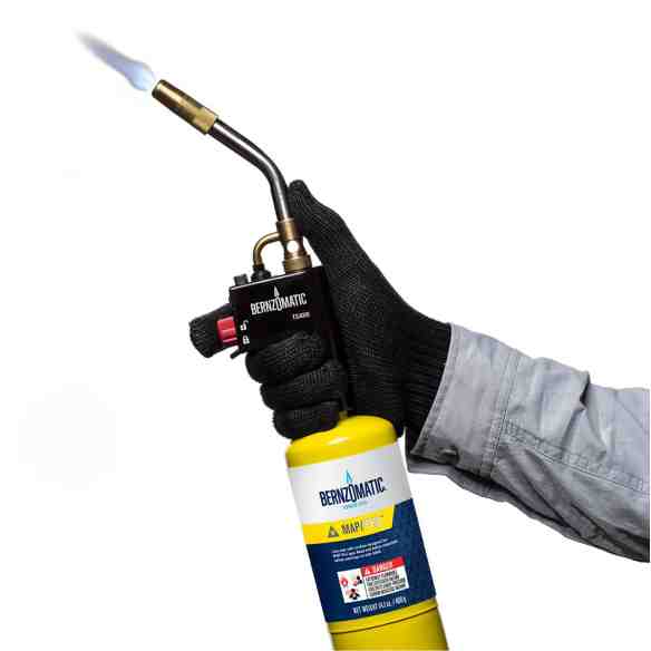

I use a Propane Benzomatic torch for 90% of vinyl removals, small jobs. You have to keep it moving fast at all times. I enjoy watching the PIA customers reaction that needs to hang around for small jobs when I hit his pickup doors with a flame...
Hate the wall paper steamer...
For larger removals, if you do that type of stuff look into a propane shrink wrap heat gun...Nice but pricey.
