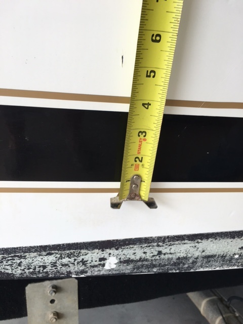

A lady wants us to make a two color pinstriping decal 25 feet long (2 pieces, 50 feet total).
Black and gold.
The trick is that they want us to cut the stripes and put them together on a piece of application tape. I am not sure if we can maintain the spacing for 25 feet. It would be easier on a boat.

Gregory will make custom roll striping like that with enough room for your markup. Use their 6500 series vinyl, I'm sure it's Gregory branded 3M.
http://www.gregory1.com/ Been awhile since I had them do striping like that, you will need to call them for custom striping.
Billct2
I too use the Edge, but I also suggest they use two colors of vinyl because it lasts longer. I won't line them up though.
I give them a little lesson in using masking/painters tape to make the space and then align the second stripe to that.
If they don't want to do that, or pay me, then I'll offer the Edge print with the warning it will fade.
