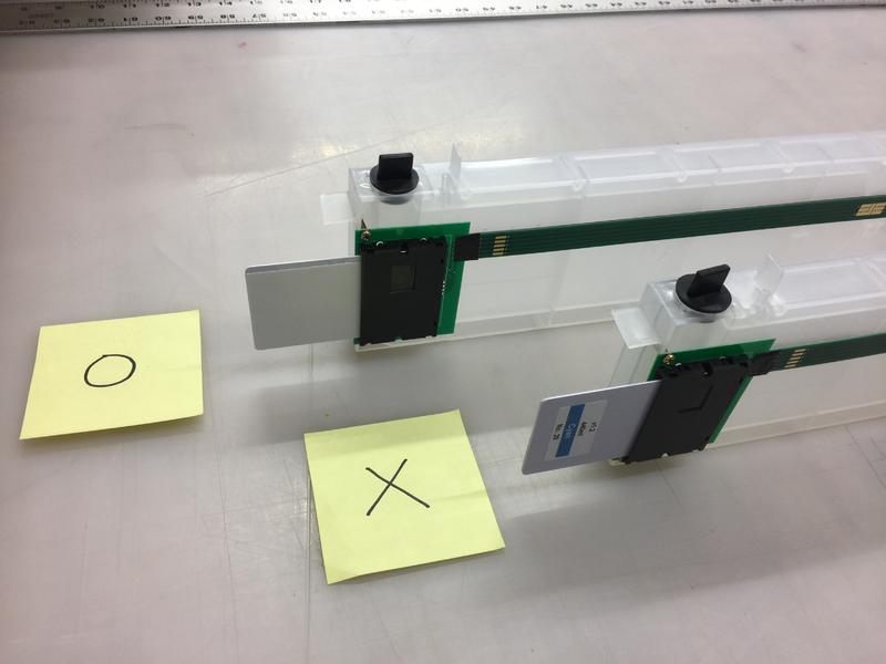

I just bought a used Mutoh 1204 and installed refillable carts and smart cards and I can't get the machine to accept the cards. Does anyone know if there is a specific procedure. Bordeaux has a line of instructions, but it didn't make sense to me and didn't do anything different.
Umca

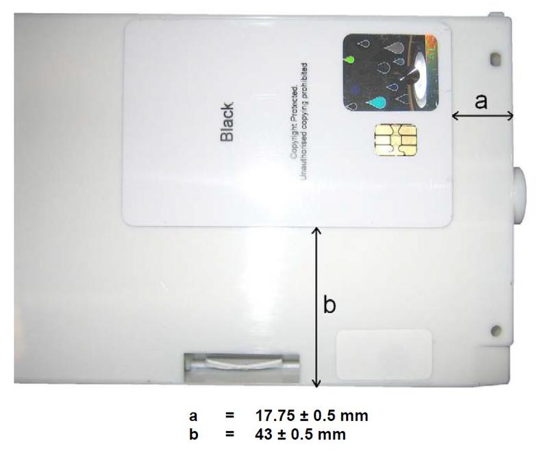

Actually, if smartcard is working, only smartcard position is important.
Please look at the picture for check if your cards mounted correctly.
Bob purchased the refill cartridges + bulk ink from us. Since the printer was just purchased and in unknown printing condition. Our cards actually didn't work. I was very surprised over the phone. So I advised him to buy a new set of Mutoh eco ultra ink cartridges just to start it off.
