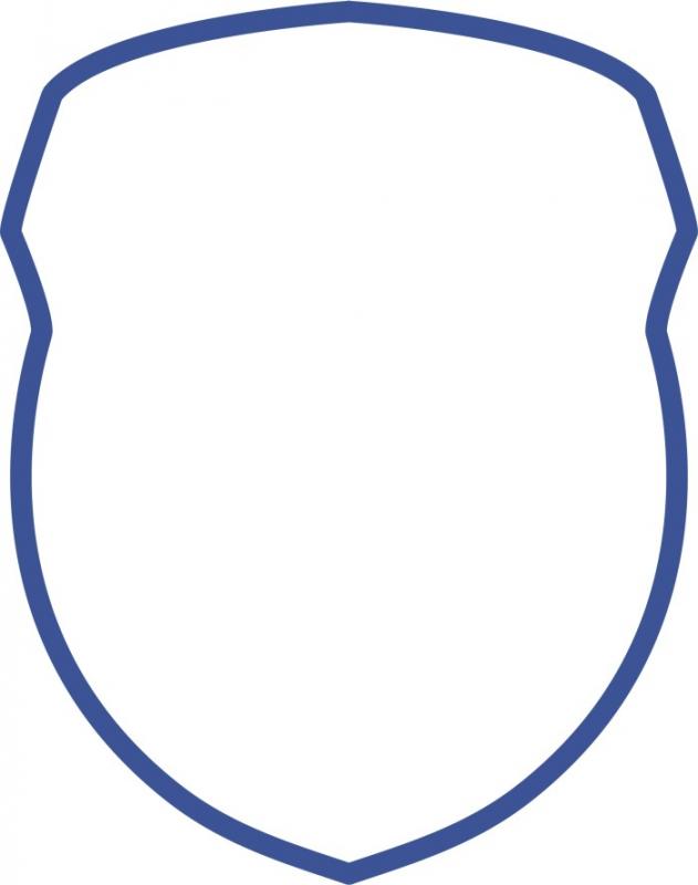

Still trying to get the hang of drawing things from scratch on Corel Draw x5
I have a patch (outline of it attached) and I am trying to clean up the edges ( a little rough in some parts when I zoom in on it)
Is there a setting in Corel Draw I can use the clean the edges up or am I better of attempting to redraw it...... like I said still trying to get the hang of it.

Looks like you are doing that in PhotoPaint.
What you want to do is set it up in Draw instead.
Find the vertical center and put a guide line there
Take the bezier pen tool and trace half the shape with a single line right in the center of your existing graphic.
Once you get the shape right increase the stroke to match the width of your outline. Mirror and weld the two halves to finish.

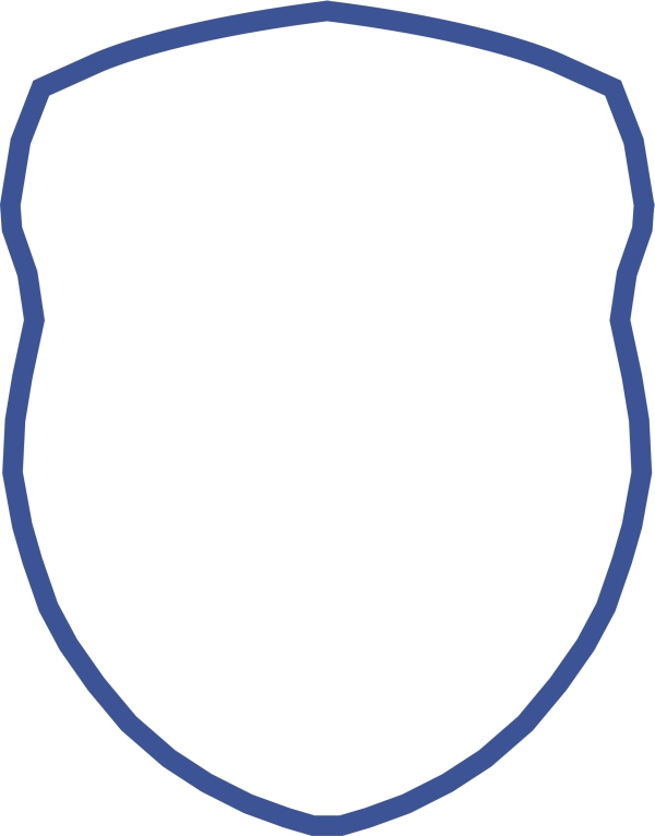

I actually I did have it in Draw...making progress.... I used the Bezier Pen and set it to freehand and did the steps you advised.. Much better and cleaner edges but is there a setting I am missing on the bezier that allows for more rounded edges?
JoshLoring
Looks like your just moving the mouse and clicking.. Creating a series of straight lines. You'll have to click hold and drag to create bezier curves. You should have about 8 nodes where you currently have 30+

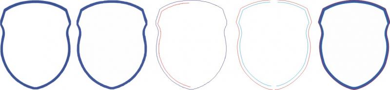

Yes I was moving mouse and clicking but before you replied back I think I got it where I wanted it...... I selected all nodes and then chose "reduce noise" and messed with different values and got this...

Josh is right, use the minimum amount to get the shape you want.
Don't use the freehand option when just starting out.
The bezier will allow better control of your point placement.
Start with straight line segments ending at each turning point in your path - set them all.
Then go back and convert(right click) the needed ones to curves and set the anchor point type to smooth where needed.

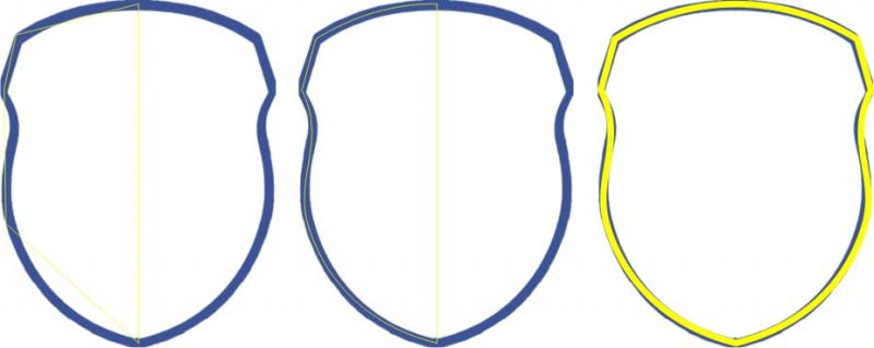

GAC05
Quit buggin' me
If I'm tracing something I always use the bezier with straight lines (no click and drag). The anchor points are exactly placed. Single keystroke hotkeys convert only the lines I want to curves without dicking around with the endpoints. I'm left handed - my curve tools are hotkeyed to the right side of the keyboard - I don't need to move my cursor off the lines I am drawing to get what I need.

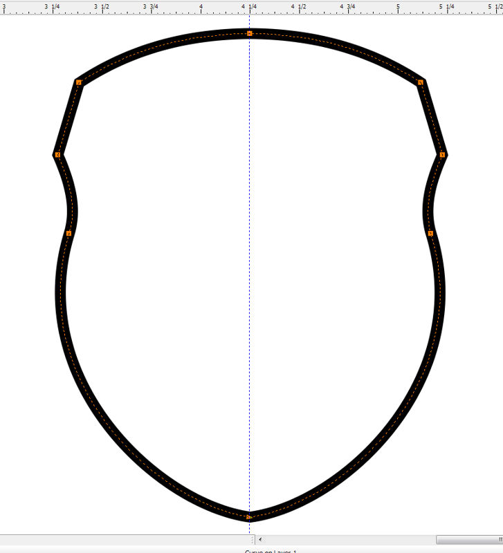

With that image quick trace bitmap, select node tool, select cusp nodes, now begin to edit vector trace, select and break apart top and bottom nodes, edit and reduce nodes as needed, duplicate finished image, mirror horizontal, line up to the original, combine both shapes, select nodes on top, weld do same on the bottom nodes.

Sounds like alot of work. I can name that tune, er trace that shield with 6 nodes for half and, as mentioned earlier, mirror the right/left side. Most quick trace (autotrace) will result in too much clean up afterwards

I would like to see what the quality of a quick trace in corel looks like
signage
Doc I woud think that would be 5 nodes and mirror copy then reduce to 7 nodes?
