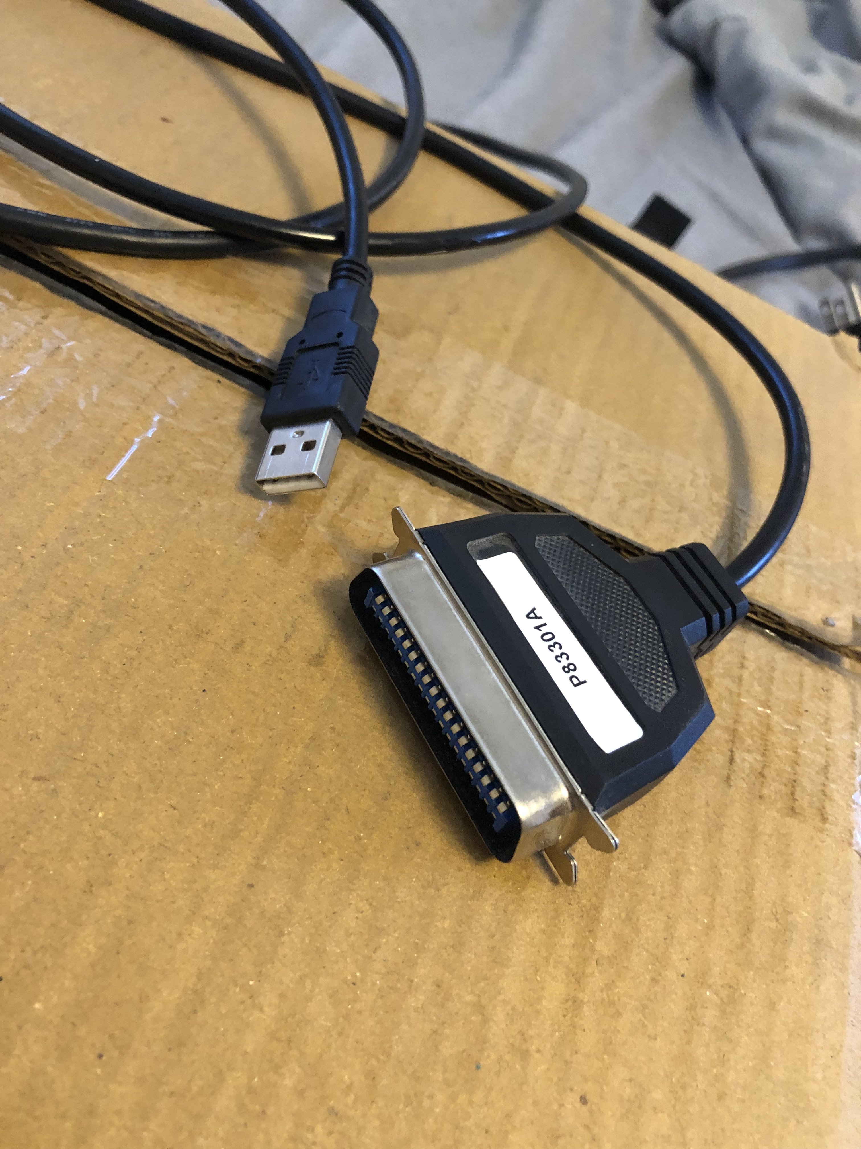

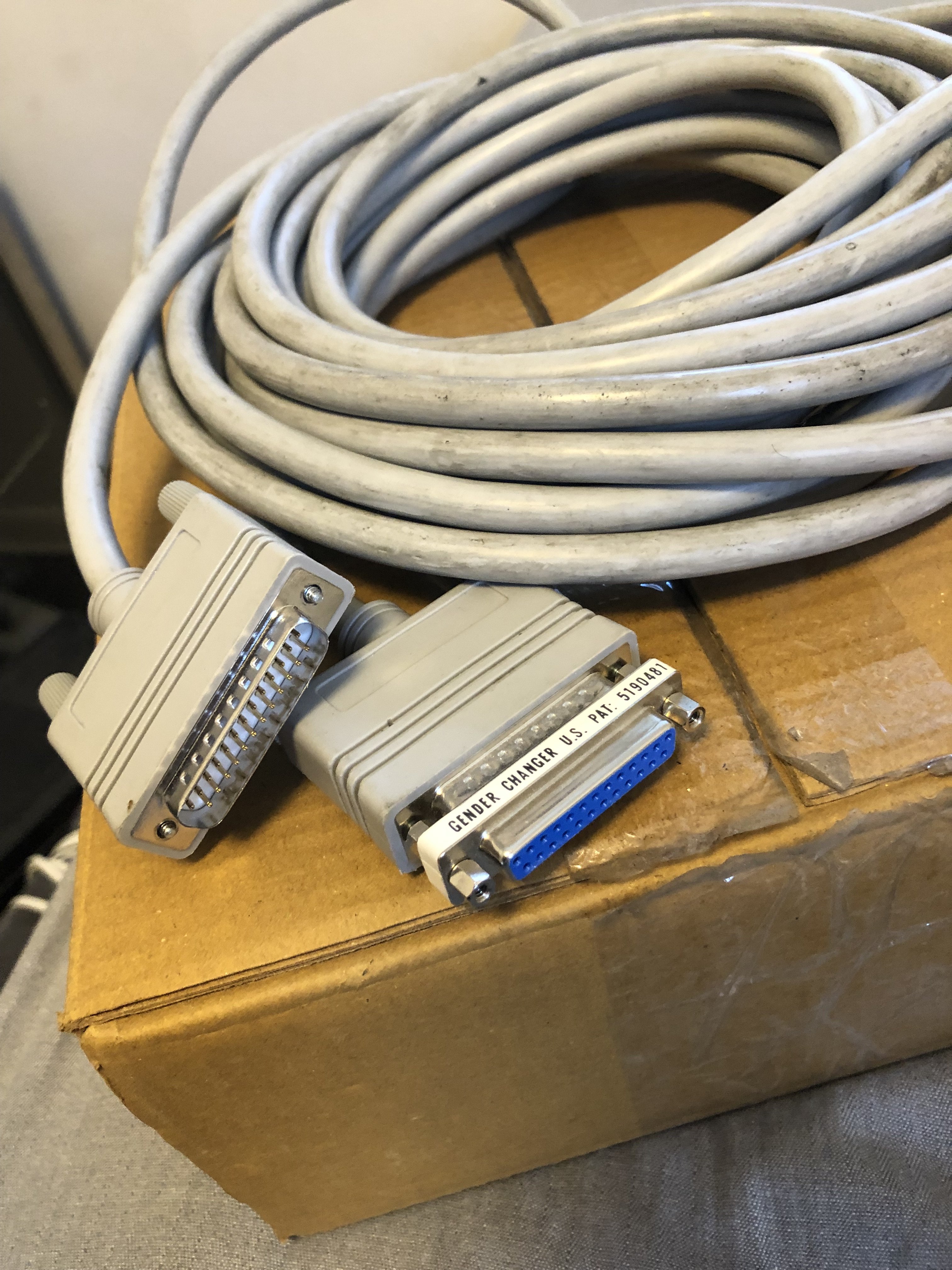

Should have given pictures and better details before, but I am using Omega 6.5. This is the printer and the two cords that came with it. I tried both cords and didn't get a print image. Do i need to "download" the comm. cords to the software or something?

Adam.Foster
If you have an Eedge2 installed and working with the black cable in the photos, then you will need to install the Edge1 in Omega Plot. Once installed select the Edge1 before output and then hit print to device. You should get a communication error in GQmgr. Terminate the job. then right click on the Edge1 and go to Properties. You should see a window with USB information and "List" Button. click on List and look under connected devices for "WinUSB Gerber Edge USB to Parallel Cable" select that and hit ok. You should now be able to output. If it still doesn't work, try putting the Edge1 in online mode before sending.

I have the same printer the runs off of the computers parallel port (Lpt1) and directly connects to the printer with a centronics connector. The cable you show has DB25 on both ends so I don't how you are plugging into the printer. Your USB cable has the correct printer end but I never seen the printer work from a USB port.
