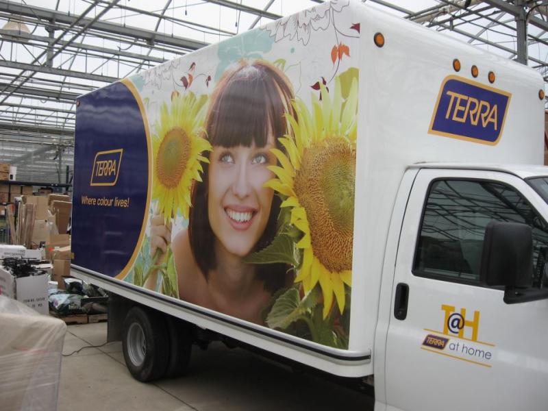

We just finished 3 of these for a local greenhouse chain. Customer designed the entire thing. We printed on General Formulations Automark material and laminated with the matching laminate.
For this application, the Automark worked great! very easy to apply, went down nicely. The "gloss" laminate is not quite as glossy as most people are used to though. We also used the Wrapcut tape for the first time on this to trim along the top and around the front curve, I was VERY impressed with that product as well!!
Overall both sides took about 4 hours in total for 2 people (we don't do many wraps)

Nice Install!!
If you get into doing wraps more i'd stay away from Automark.
their wrap vinyl is calendered...and not cast.
The shrink rate on it.. is extremely fast, and isn't the best for vehicles.

Colorado, thanks for the advice, I don't plan on getting into wrapping anything more than flat box trucks, it's just not something I think I have the patience for lol. I know automark is a calendered vinyl, but for a completely smooth fiberglass box truck I thought it would fit the bill, no?

Is Wrapcut on par with Knifeless tape? Just curious if so and how your product compares with price and performance.
Please advise.
Thanks
I've never used knifeless tape, but my understanding is that it's a very similar product, however the wrapcut tape is about 1/4 of the price, plus it's manufactured about 300 km's away from me, so it's nice to support a local business with a great product.
