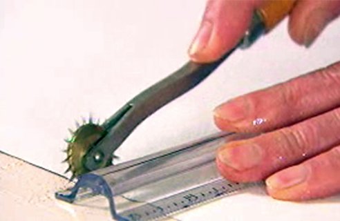

SignosaurusRex
Printed poster paper perforated with a perforating wheel.

luggnut
I would think it would be more of a paper product....?
they want to be able to reuse it.

Professional Snow Ninja
i hate those things....but i think my hatred is directly related to the fact that when i used a perf wheel, i then had to use the sock full of chalk dust with the pounce pattern i'd created and i HATE chalk dust...
not an answer tothe banner question but an alternative to chalk dust...use graphite
