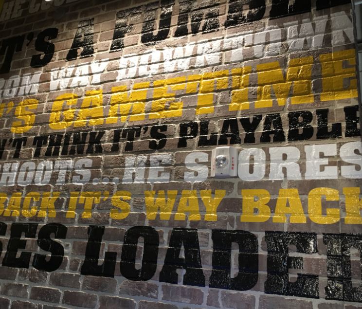

Have a customer that is wanting to do some graphics like attached picture. I really do not want to spend my daughters college tuition on a "street wrap" material. Does anybody have any suggestions on another material that might work that won't leave me starving in the streets? Any advice is appreciated :)

Wouldn't it be your customer's daughter's tuition that would be spent on using the proper material?
eahicks
If the cost of a substrate scares you and you don't sell the job for enough money to cover that cost, something is not right.
That picture looks like simple solid color cut vinyl to me. Just cut any old cast vinyl, use a heat gun/torch and felt squeegee.

MikePro
rent a projector and hire some high school kids, or utilize clients' employees, to "paint by numbers"

i would rather use the 3M (geekwrap) tool that has two handles, a roller and a heat gun in the middle. If you use anything else but a roller it will come right back off. When I was doing the 3M certification i had some time playing around with the tool the day before the test and I gotta tell you: if you don't take your time and press that tool really hard the vinyl can be picked up SUPER easy. You might also need another Roller that can fit in between the bricks ( on the mortars) but back on the tests they make you cut the bricks if the mortar joints are deep

And then come back later when it fails. USE THE PROPER MATERIAL FOR THE PROJECT!!!!
Modern Ink Signs
We do a lot of rough wall graphics and use the 3M480 with the 8548 lam. Utilizing the proper rollers/heat guns/ etc for install
