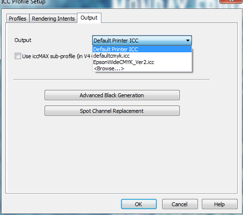

klingsdesigns

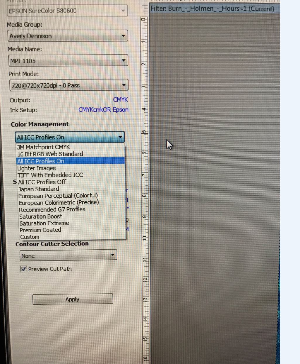

This is all I have for choices.
Bly
Here it is. I think I had a time finding it.
Pretty sure it doesn't automatically install with the drivers etc.
  • EpsonWideCMYK_Ver2.zip
klingsdesigns
Your should find more access to the actual input profiles; such as a "Change Profiles" button or such. ICC Profile Setup: Profiles, Rendering Intent, Output.
Let's see those settings.
For that output selection all i have is default printer icc and default cmyk icc

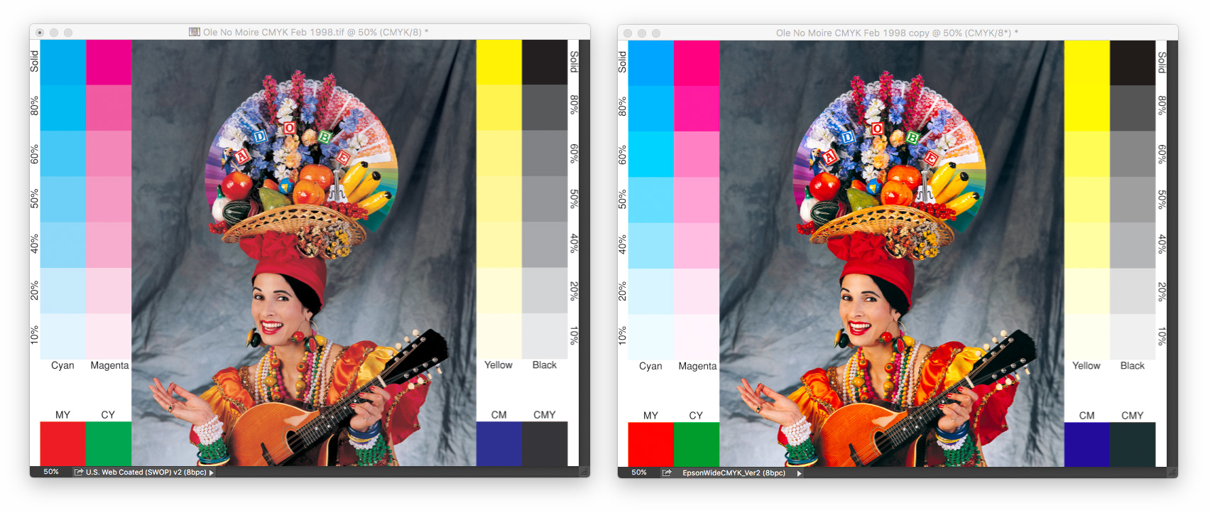

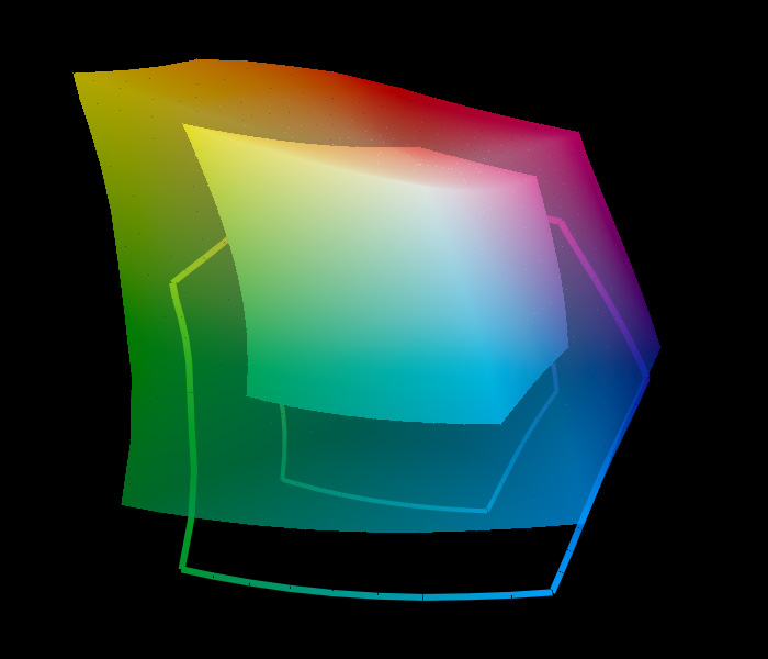

ColorCrest
All around shop helper.
The attached image is a visual comparison of two CMYK working space profiles. The common U.S. Web Coated (SWOP) v2 and the special Epson Wide CMYK ver2. Also is a visual gamut comparison. Gamut volume of SWOP reports as 296,515 vs 1,006,190 for Epson Wide.

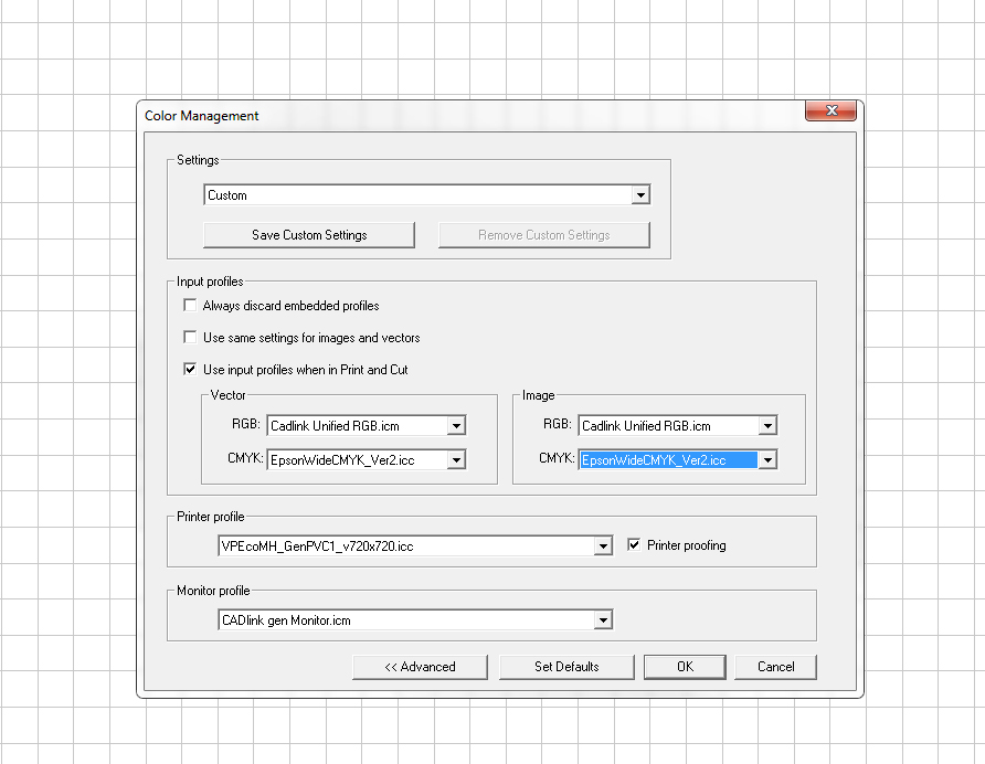

klingsdesigns
So i want that in profile tab under cmyk image and cmyk vector?
ColorCrest
Yes. Set rendering intent to Perceptual for both.
Then you need to get that same profile to your design software and test it as a CMYK working space. It's atypical however because it's not universally available to most designers. Designers would normally use an RGB working space such as Adobe 1998 to build "bright" colors." Be sure to save your test design file tagged with the Epson Wide profile and honor it in Onyx when it's ripped.
Do you know if you have a proper ICC output profile in Onyx for your chosen media setup?
klingsdesigns
Yeah for most medias i have the correct profile. Right now all we have been printing on is avery 1105. We use signlab 9.1 print and cut so i will see if i can get it in there for the correct epson cmyk profile.

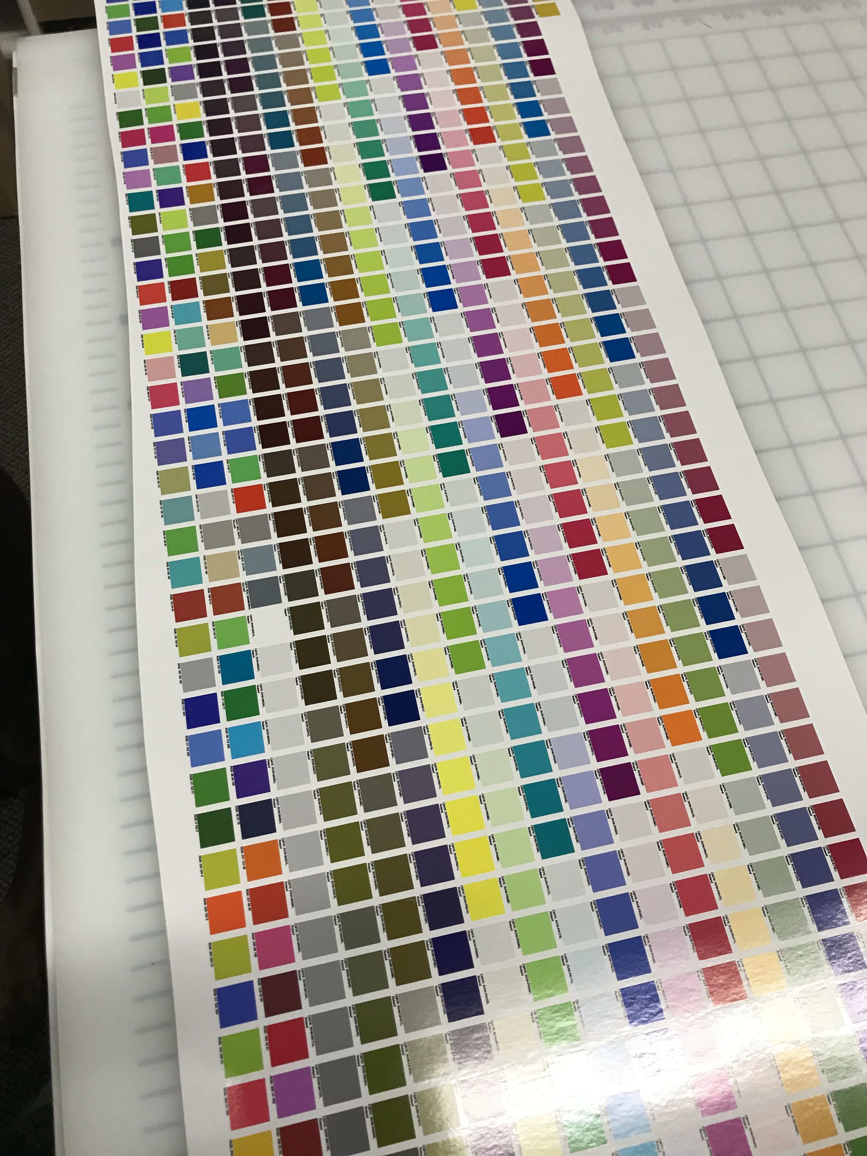

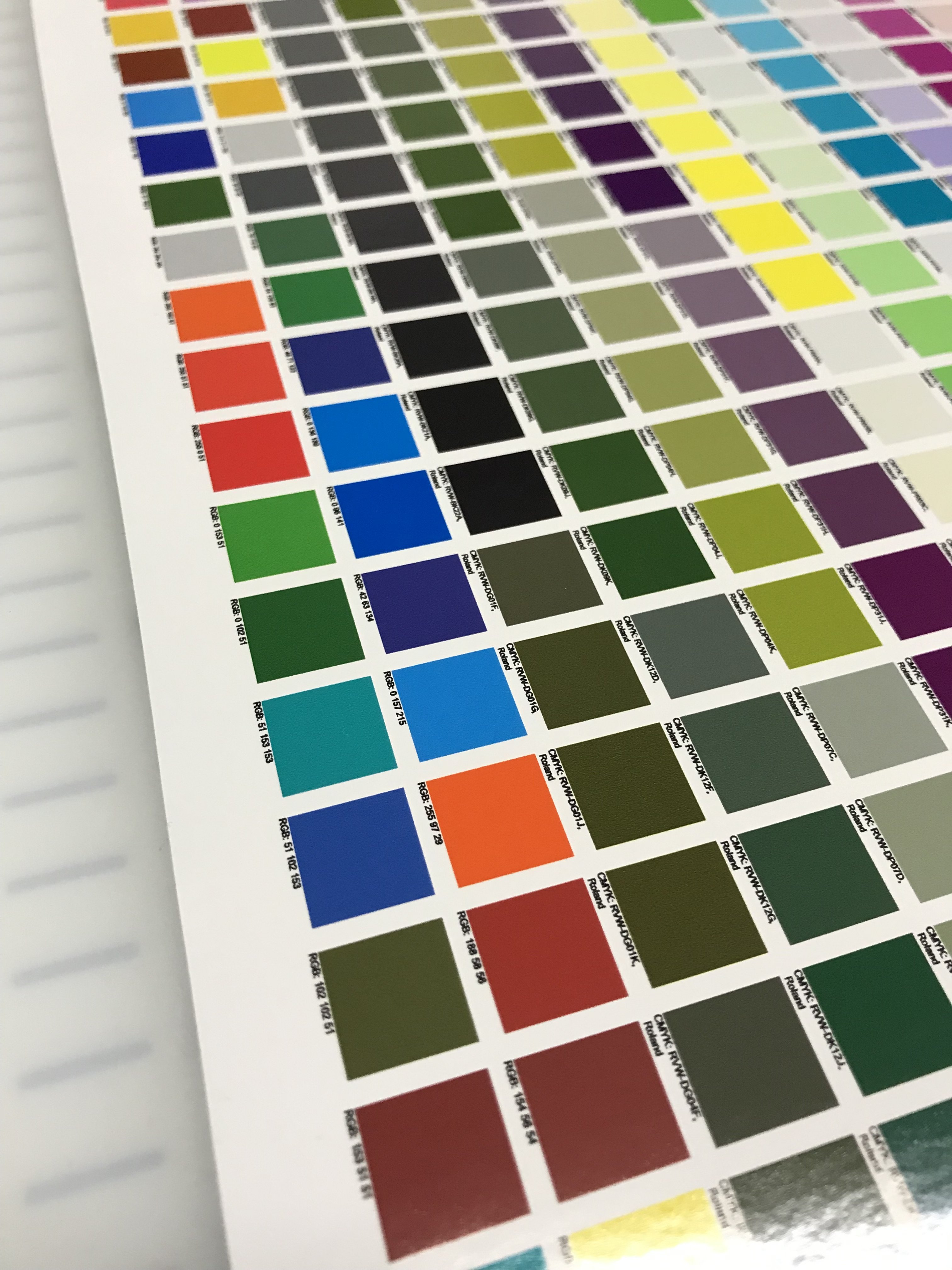

klingsdesigns

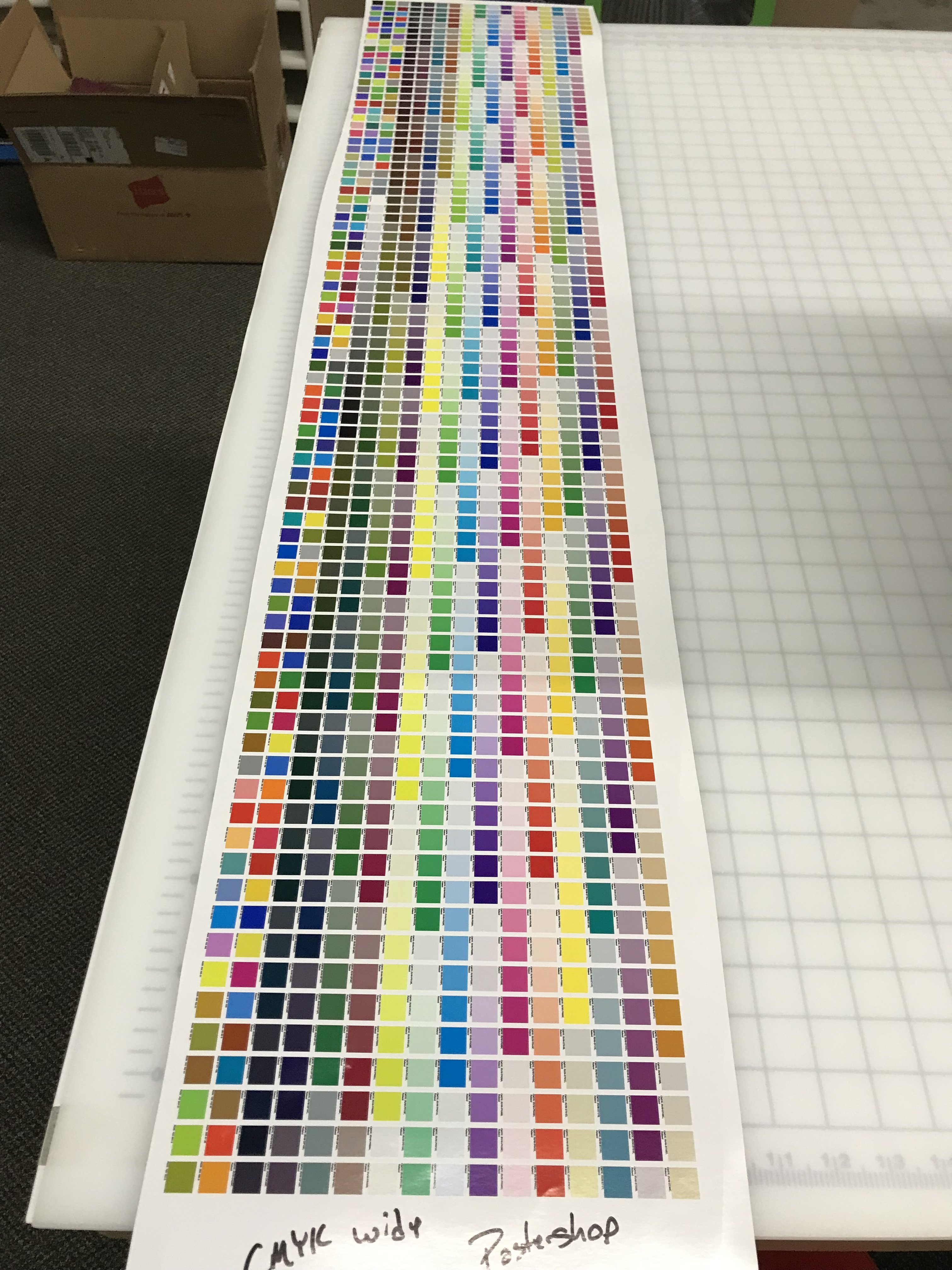

So changed it to that cmyk wide and WOW.. Pictures dont do justice but some are almost florescent.
