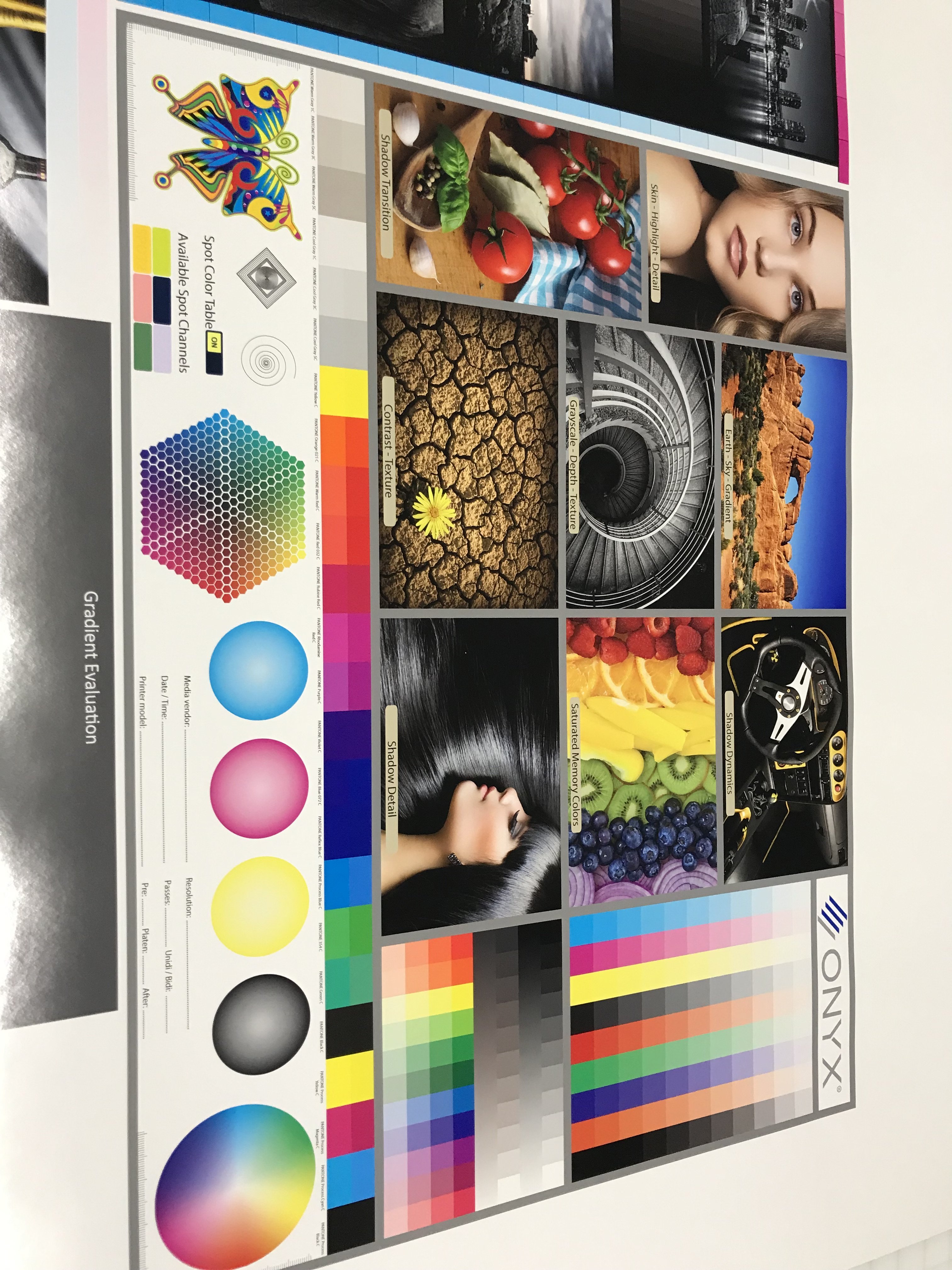

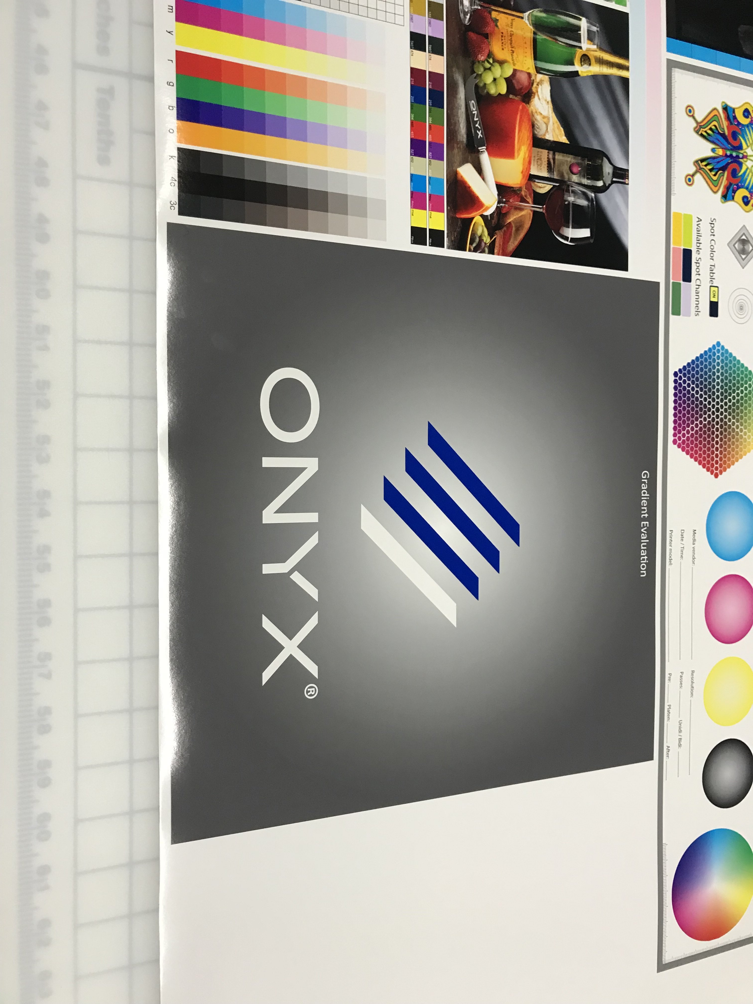

Here they are. Not sure why all the images flipped?

ColorCrest
All around shop helper.
So, these prints are now THE guide until you may create even better using the same media & setup. I suggest you write the date & settings on them and keep them handy and in good condition.
You can set Onyx to print information in the print margin for you. From the Onyx guide...
“The Marks option allows you to determine the marks that will be used with your image. [Marks] assist you in cutting, welding, and framing your finished job (Figure 1).
You can also set up the [Print Label] from the [Marks] option. The [Print Label] contains information about your job such as user information, job ticket, job information, print information, and date/time printed. This information is printed with your image in one of the margins and can help you recreate the image at a later date.
Many shops print the options they need on all their prints.

Thats a good idea I will do that next time. Colors are very nice on this printer.
