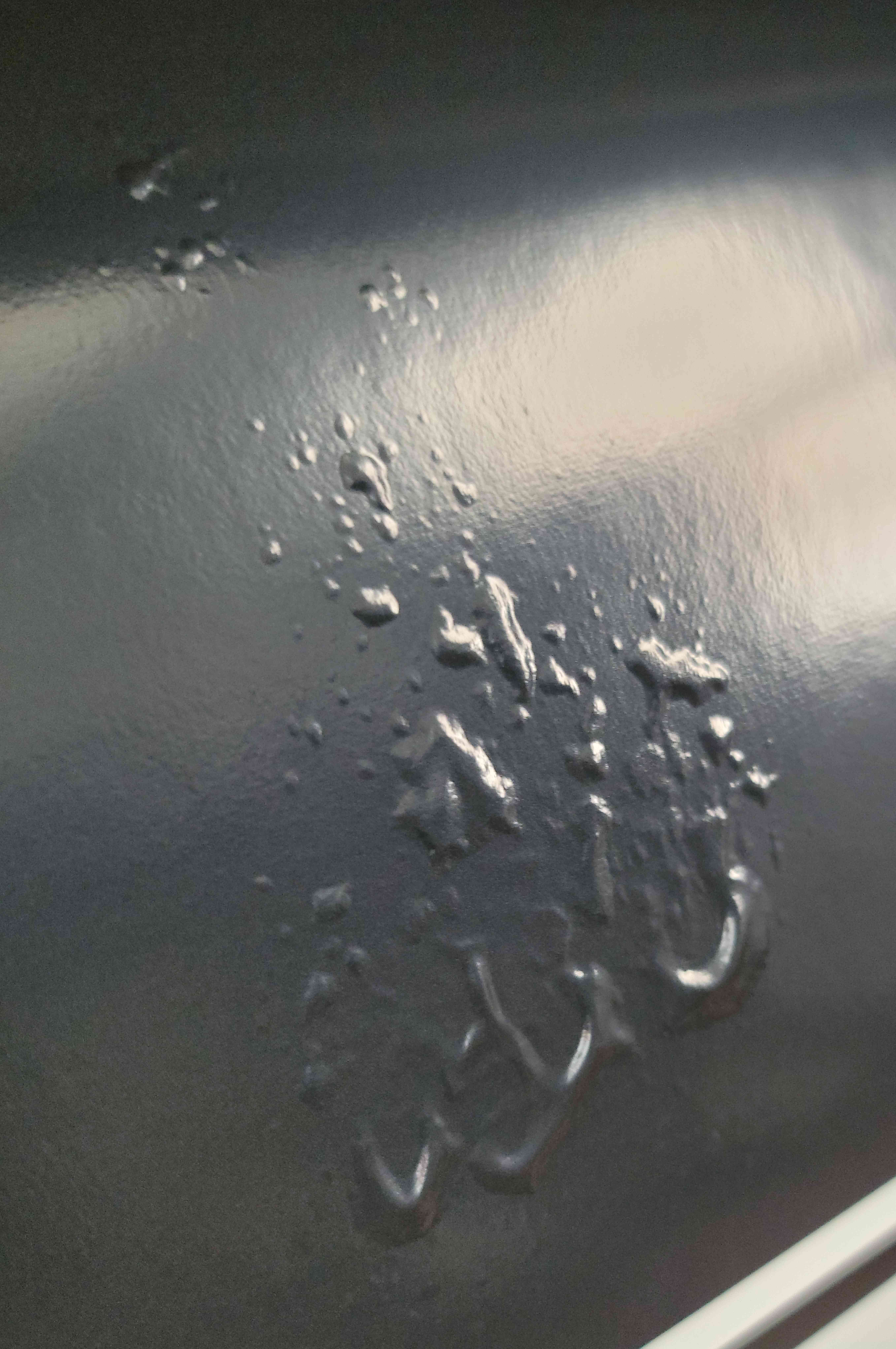

Question Bubbles in vinyl?
CKCUSTOMKC
Is this a moisture problem? Or a manufacturer defect? The vinyl did sit idle for about a week and there was a significant temperature rise outside during that week

hey sorry all I thought I attached a picture with the original post, I guess my phone lied to me when it said it attached the image

That actually looks like somethings wrong on the substrate (car?) was it freshly painted? within the last 30-45 days?
Wow, that looks mighty bad. Can you answer any of my earlier questions ??
