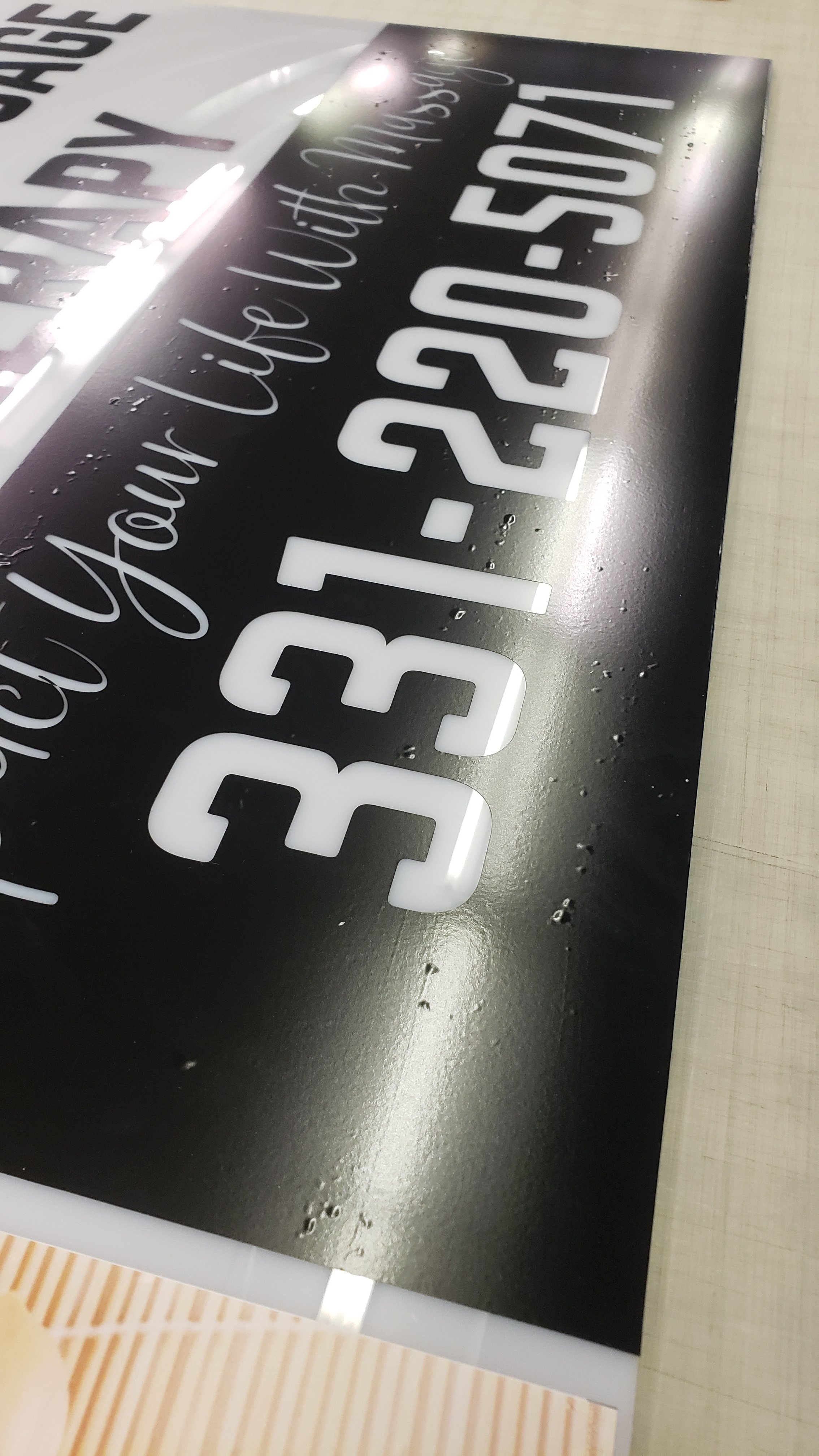

hello guys, how can i install this vinyl so i don't get so many bubbles?

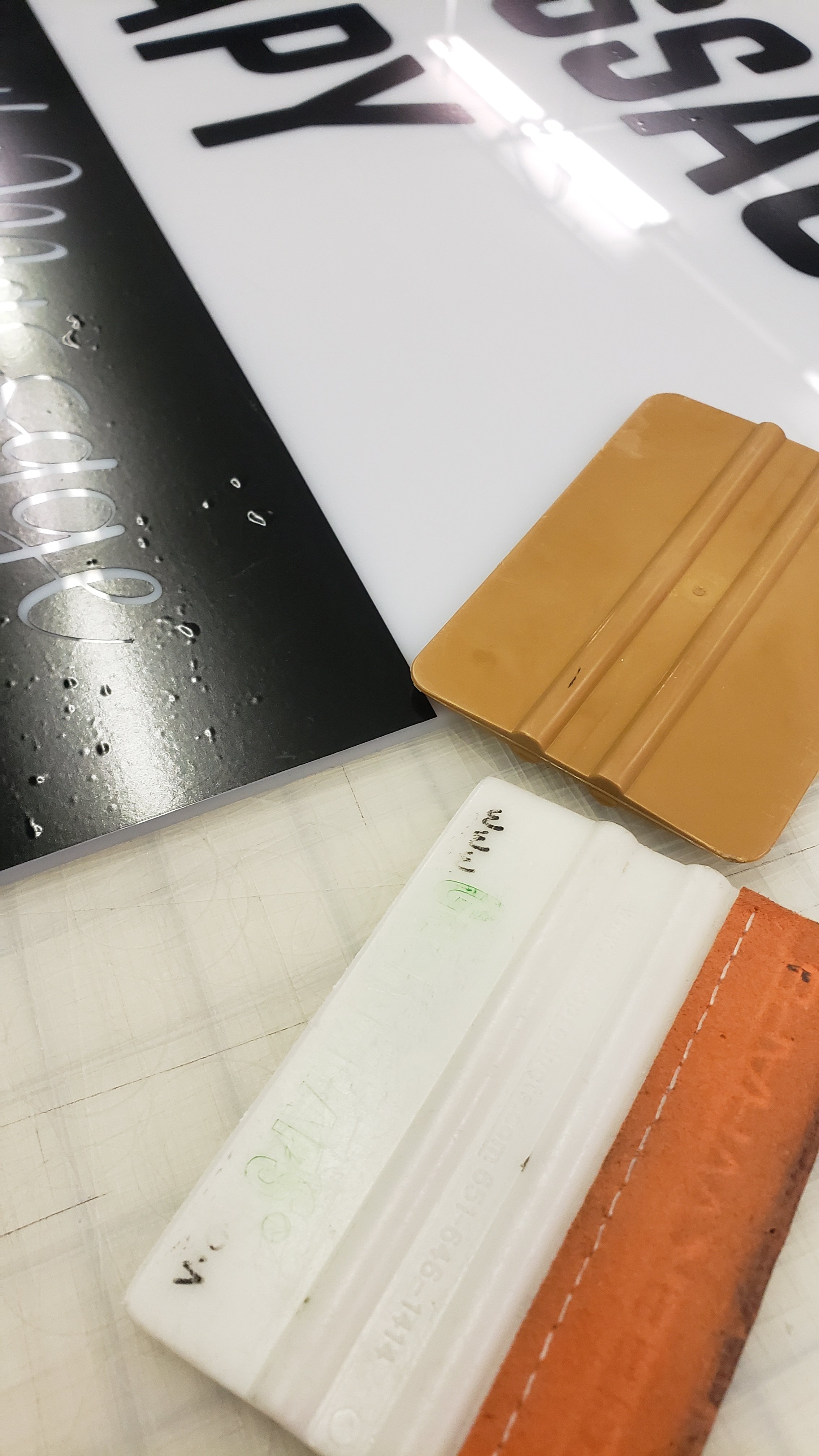

you can see on the pics the kind of squeegee i'm using.
thanks for any help,

That looks like it was squeegeed too quickly. First clean the panel, then use Rapid Tac or Right On to lay it wet, as you squeegee make sure you advance only one third of a squeegee width at a time, feel for bumps/air bubbles and firmly push those to an edge, once it is down let it set for a few minutes so the adhesive and Rapid Tac can react, then lightly spray/mist the application tape and use your hand to make sure all of it is covered, let set for a minute and the application tape adhesive will soften and it will come up more readily, wipe up any leftover wetness.
Biggest mistake people make when squeegeeing is not overlapping passes enough. When you move fast and overlap little invariably you end up trapping air (moisture when laying it wet) between the passes. 3M recommends advancing 1/3 of a squeegee width with each pass. That is a good method as in reality as you speed up the amount of overlap ends up being reduced.
