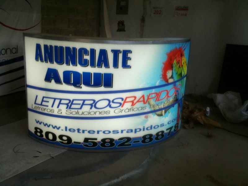

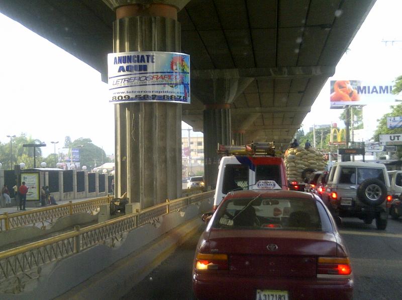

This is how we did it, in case anyone is interested
We did the curved frame with 1in galvanized tubing, painted white inside and placed led tubes along structure. Used the 4x8 clear acrylic as the front. Printed on clear vinyl on reverse and placed it on the inside part of the acrylic and then used matte white vinyl behind it...
Then attached them to the columns using a ring and 4inch screws ever 8 inches.
The results were great. The key we believe was using 4 pass on our ronald advance jet when printing the transparent AND the MATTE vinyl on the back gives it a solid look to the colors during the day and the night. It looks specially good during the night since the acrylic is very glossy.
We started installing this week; attached are pictures of the first one mounted, they go on all columns.

John L
Good work on the sign. But if you are able, could you fully elaborate on the permit approval process you undertook here? I would consider that fantastic reading. Is this in Miami?
ProWraps
uh.... two doods riding on the top of bags of grain stacked high on the back of a truck. im not thinking this is in the US.
