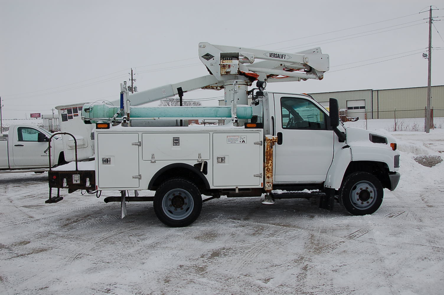

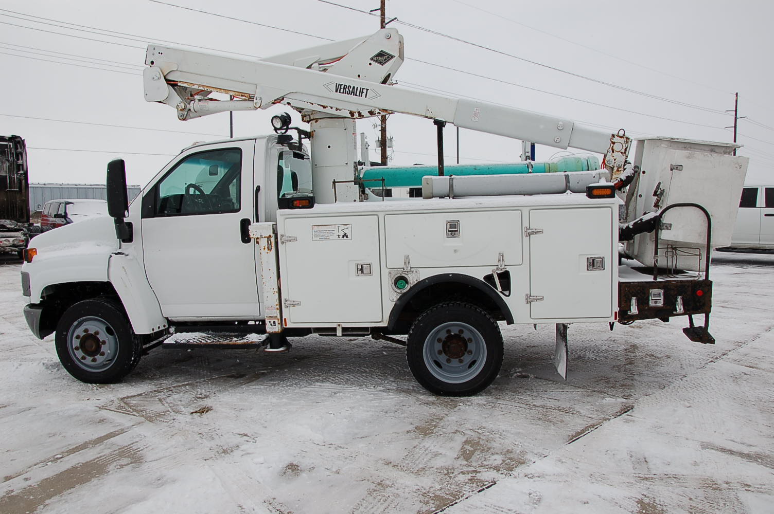

In our sign business, bucket trucks have become an absolute necessity. But a bucket truck that an average sign company can afford comes with some pretty glaring limitations. We have to buy used utility trucks that were never intended to haul flourescent lamps and the booms that work the best come with the beds that store the least it seems. Im sure we arent the only ones with this problem and was curious what solutions others had come up with for bulb storage on these trucks. I attached photos of our latest bucket truck for a reference point. Ive toyed with the idea of a false floor with slide out trays for full boxes of bulbs. I prefer to keep them in boxes for quick reloading speed, bulb safety and ease of inventory. Ive also looked at building a vertical box in the left side of the bed that wouldnt hog much bed space. Still using pull out trays. But then i still need some type of box for hid bulbs and loose led bulbs.

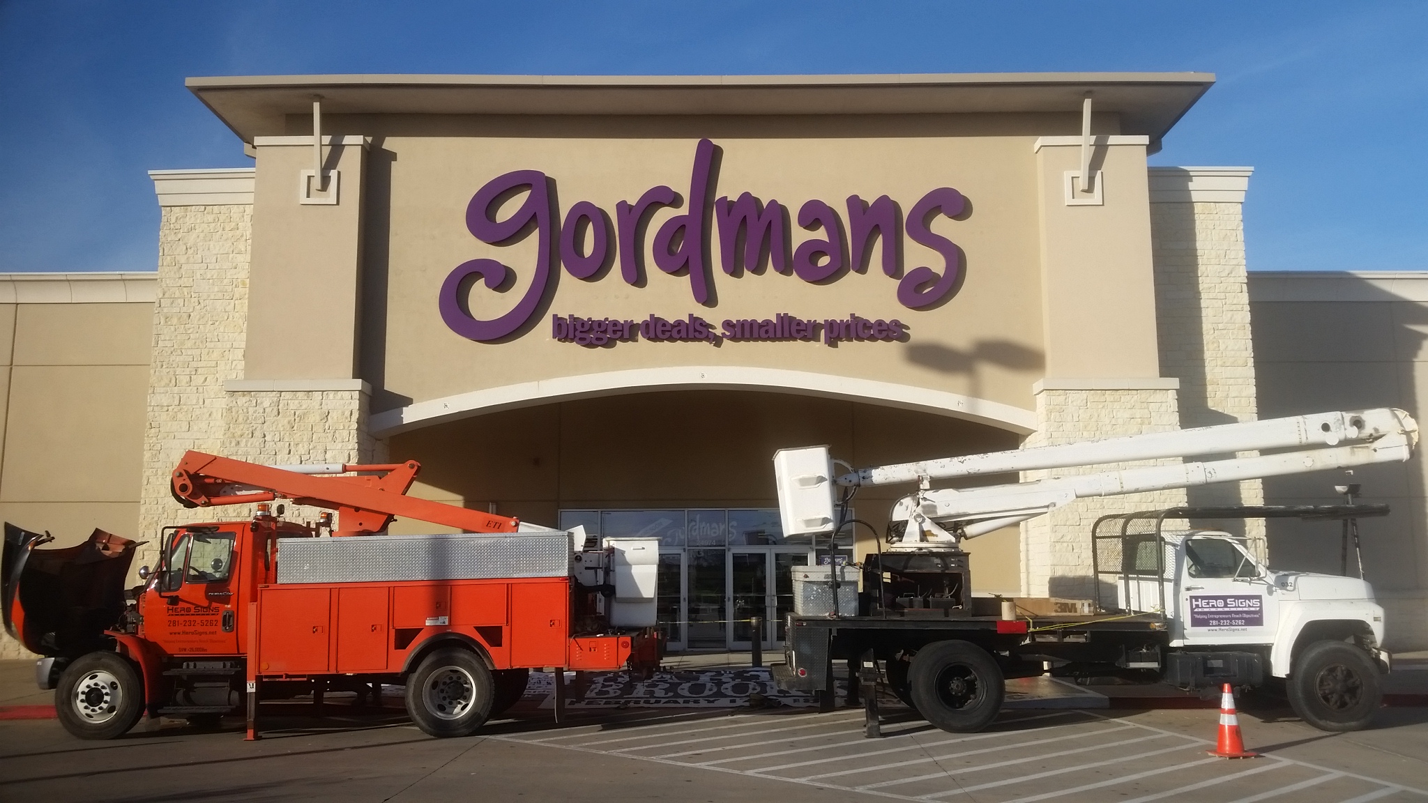

Build a box big enough for 1 case of each bulb size. We carry 3-10ft lamps, MH and LED MH replacements. Yes it costs to stock but save so much time.
The orange truck has everything we need. I only buy 10ft+ beds due to hauling signs, may take longer to find a truck but we'll worth it.
