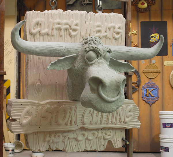

Here's a fun project currently underway in our shop. The double sided sign measures 4' x 4' x 4' deep. It's routed from 30 lb Precision Board with a welded steel frame inside. The bull's head is sculpted by hand using Abracadabra Sculpting epoxy.

Is working that sculpting epoxy anything like autobody filler? Or no, it must be a bit more firm from the get-go?
grampa dan
Sculpting epoxy is best equated to working with plasticene - except this gets hard in about 3 hours - rock hard overnight. Mixing the two parts together is as big a deal as sculpting. I use students to help me out with that and either of the two ladies (one is 16 and one is 20) mixes about the same rate as I can apply it.
The epoxy does not smell like autobody filler. I use bare hands and wash often although some folks react to handling it without gloves. To work in the details I wet it down good with water after it is applied which makes it easy to smooth out or add texture without it sticking to my hands and tools.
We buy and use it by the ton (literally) and it is the coolest stuff since sliced bread!
-grampa dan
AUTO-FX
So, it is self supporting? In other words, you start from the bottom and work your way up? Or do you start with some sort of wireframe skeleton?
grampa dan
Depending on what we are building we use a variety of methods. Generally on bigger stuff (this project was small) I weld up a metal armature of pencil rod attached to structural steel, then expanded lath and thin rough coat of sculpt. Then we apply a final coat (a small area at a time) and put in the detail.
On this sign I routed the basic head shape from 4 layers of 1" Precision Board. Then I bulked out the cheeks, horns and other big features with heavy duty tinfoil A steel rod goes through the horns. Over this I did a rough sculpt - then a final layer with detail.
-grampa dan

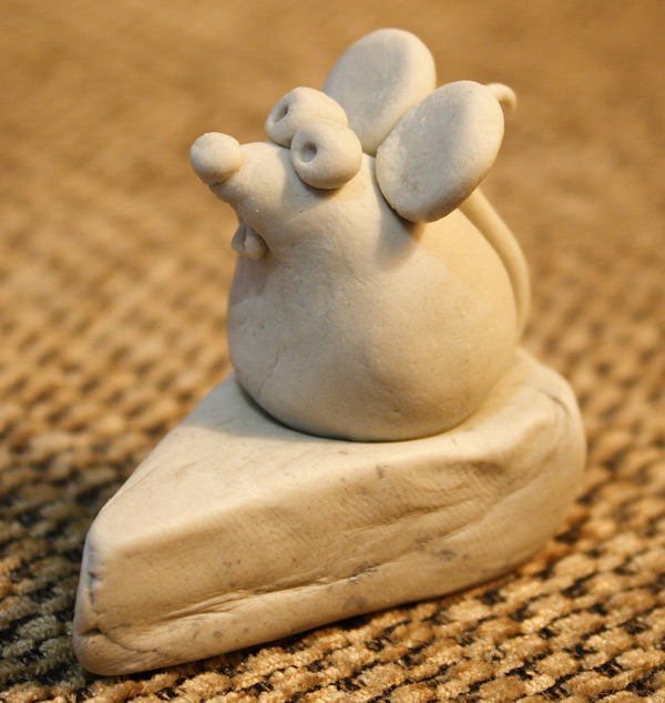

That's great Dan! Here is a little mouse I made from Magic Sculpt out of the little bit that's left over from a sign project. (You know how there's always a little bit of sculpt left over? So I thought I should do something with it) He's about 1" tall. Magic Sculpt is very much like hard plasticene to work with. It's a bit of bear to mix the two halves... hard on the hands. An apprentice would be ideal for mixing it up!
I would encourage anyone to order a small kit and give it a try. It's great fun to work with.
