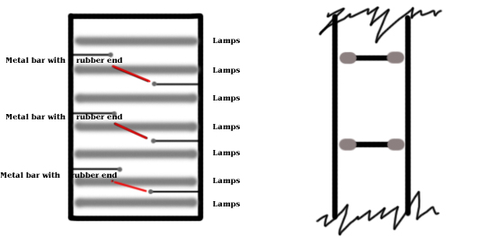

Quoting a project now. Lightbox with 2 12' acrylic sheets making one seam. Specs from national requirements list bumpers to be used at the seam. No mechanicals have been provided......can someone elaborate on a bumper?
:help

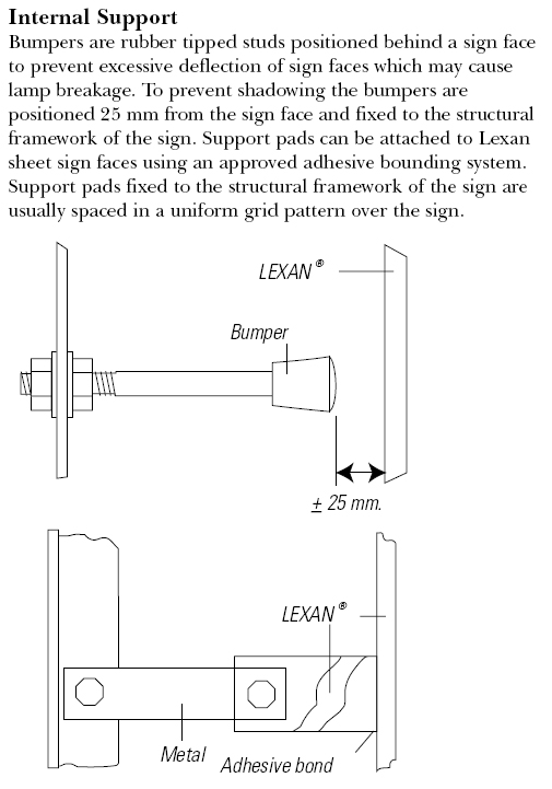

Well, the one diagram is for double sided and the other is a close up.
Usually not needed in a flush mount box, but if it's code, you need to obey.
