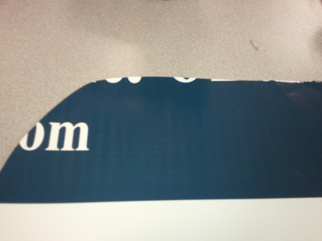

I ask for my employee to clean the heads on our Mutoh. Just a weekly maintenance. He decided to dry wipe the heads and this is what happen.
Anyone know how to repair?

Jack Knight1979
Manifold flush with cleaning solution.
Then re-prime with ink.
Then Head soak for about an hour.
Manual Cleaning with wet swabs.
:rock-n-roll:
** Be gentle on the manifold flush. And only do this with DX4 Heads. If you have newer model heads skip step one and do a head soak, followed by manual cleanings.
