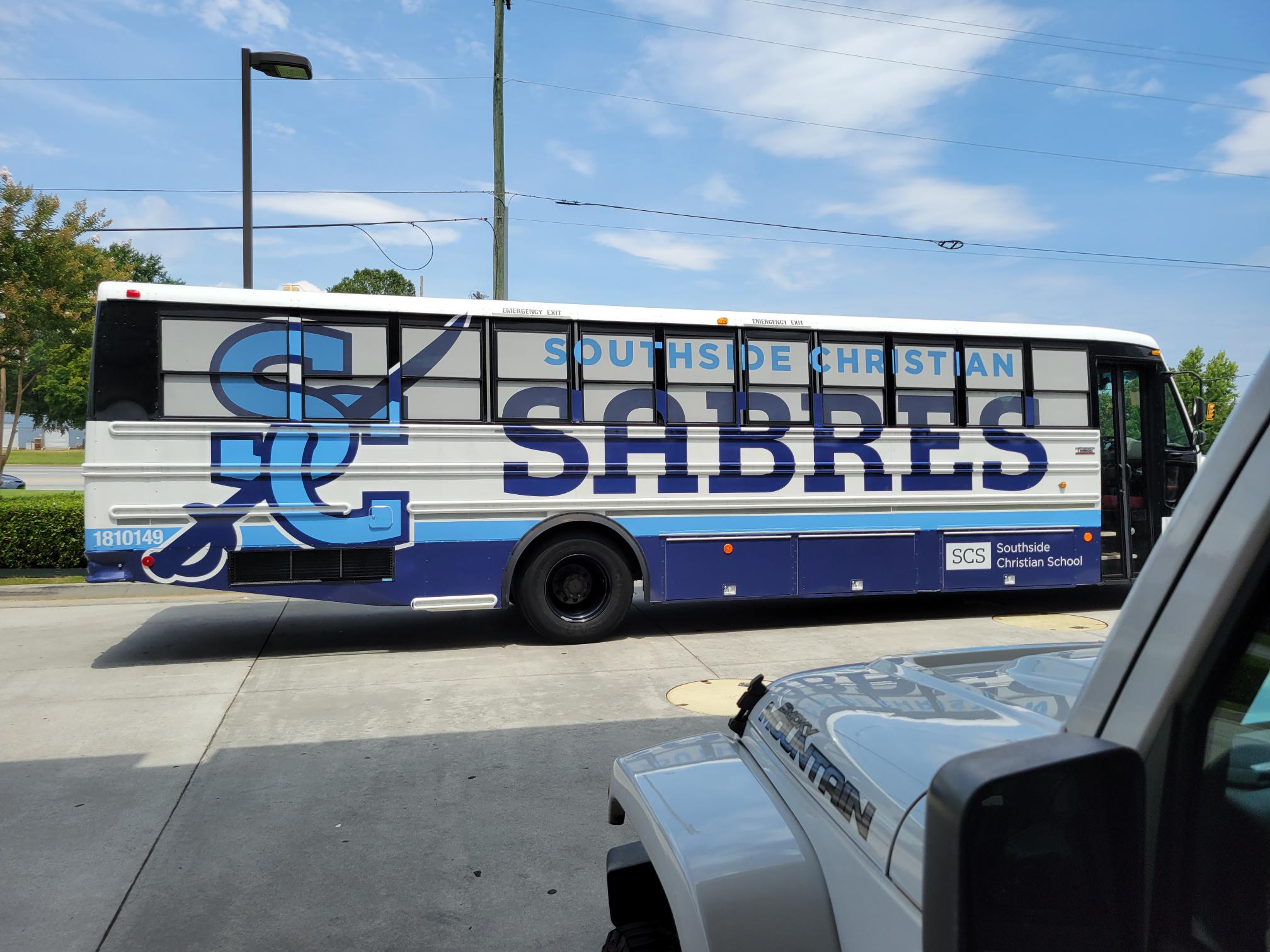

I have made bus templates like this:
1. take good perpendicular photos of each side. Use a real camera with a real lens, not a cell phone unless it has a physical and not a digital zoom lens. The further you walk away and zoom in, the less "lens/parallax/bloom" errors will be in the photo.
2. Measure between two unmistakable features on each side, as far apart as you reasonable can, vertically and horizontally. Lens errors can make a difference between vertical and horizontal scales.
3. Using these measurements, scale your photo up in your native software until the image more or less matches your measurements. +/- .5" is usually close enough.
I like to draw around the image and create clipping mask to isolate the vehicle from the distracting background.
On a bus like that you will need to add a few "fudge" inches vertically due to the flutes/rub rails on the sides.
As stated before, draw boxes around the areas you want to wrap, main side, windows, etc. Allow a couple of inches of overlap between panels to allow for small installation errors
Try to meet the corners with something solid and generic because matching the panels on the corners can be very tough, even for seasoned installers.
If you hire someone to design for you, they will need you to complete steps 1-3 first...
There may be scaled templates out there, but to be honest. there are many school bus manufacturers and they will vary their body styles, frames and cabs pretty often.
Hope this helps,
Bill

Why? It's still just a big rectangle.

Ahhh, good point, but a slab sided vehicle is the perfect rig to start with. Can't overthink it, get your basic measurements and go to town. I did that for a class 8 truck where there was no existing template.
